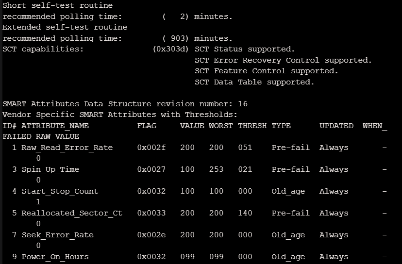

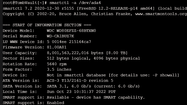

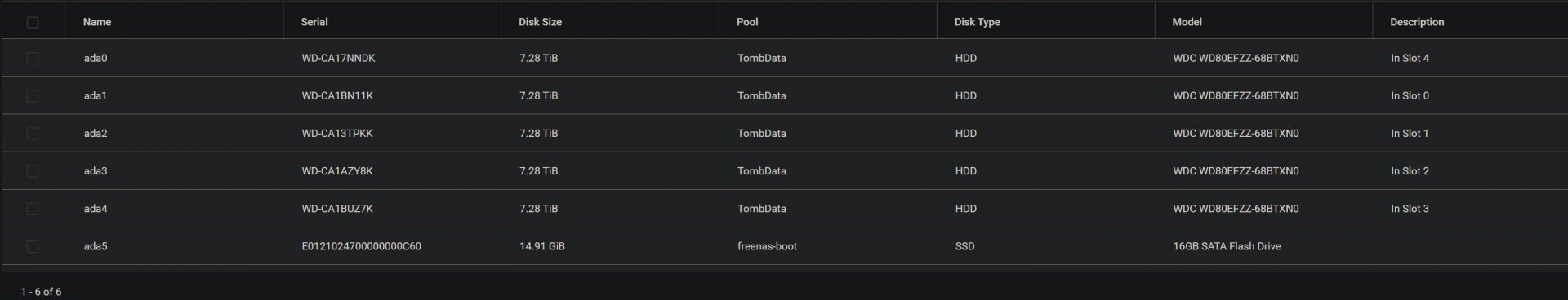

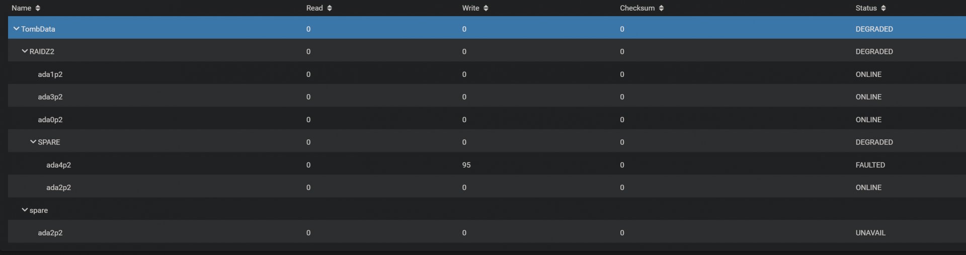

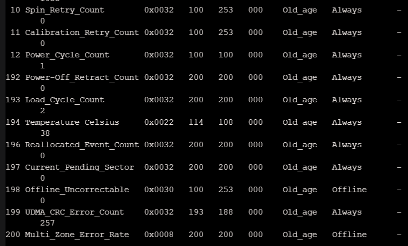

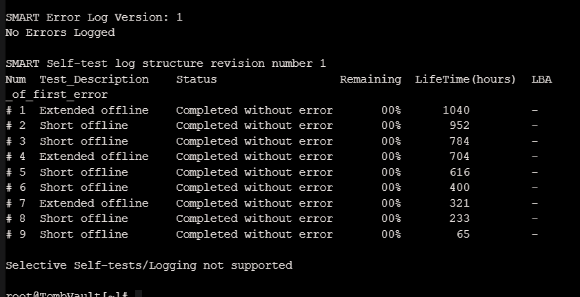

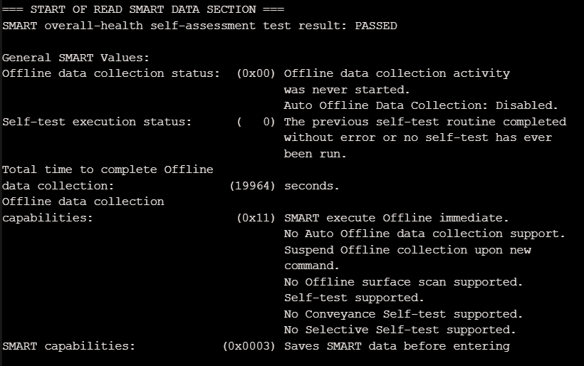

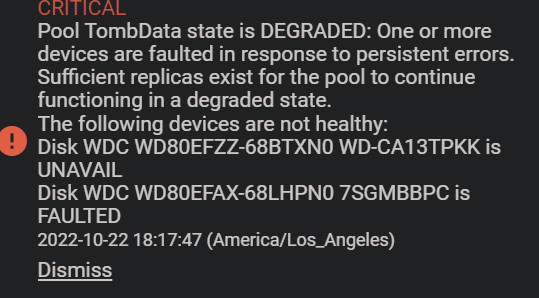

Hello - I replaced all of my drive in my Truenas mini-X 5 bay system 2 months ago and yesturday after the scrub finished it came back with two issues. One drive (I beleive my spare) is saying unavailble and another drive that is not even in my unit anymore shows faulted. I was wondering if someone can help me read what I am seeing with my drives. I cannot tell for sure if its my spare but I know for sure that the drive that says faulted I removed when I replaced my drives. I have screen shots below. I am running a Truenas-Mini 3.0-X withg 32 gib of ram. The drive model that says faulted is a WD80EFAX-68LHPN0 and I dont even have that model. All my drives are the same model WD80EFZZ-68BTXN0. I hope someone can help me understand this. How can I fix it. If my spare is bad that's easy I can just warranty it but this is confusing.

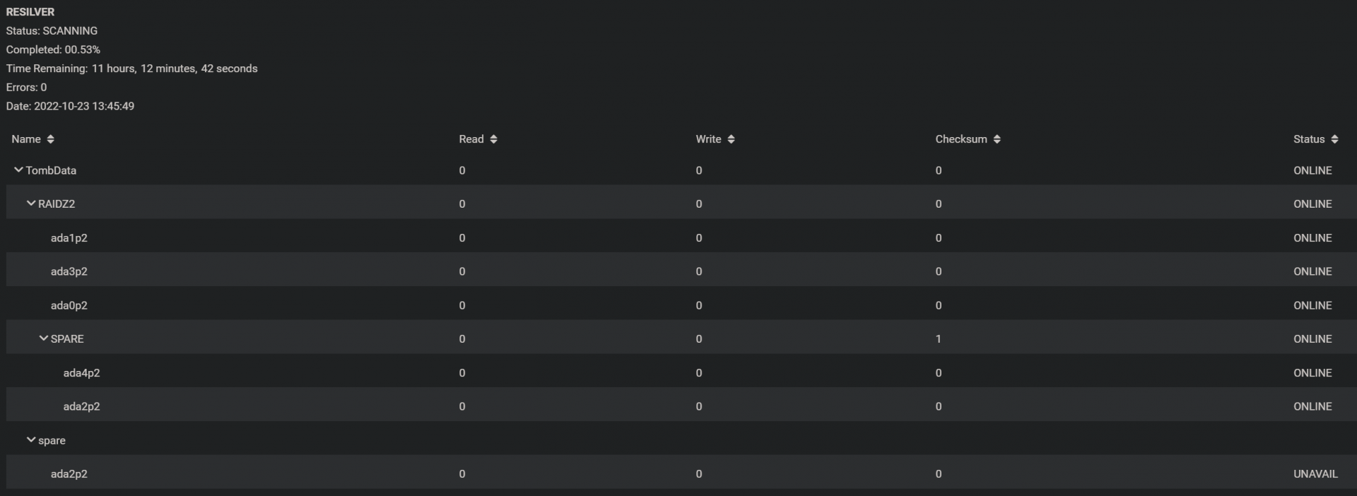

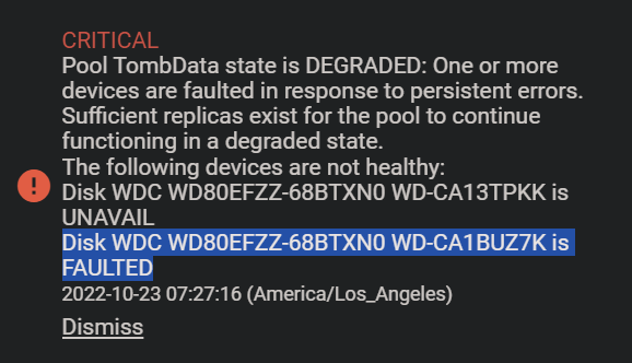

So I rebooted my system to see if that clears anything up and it did for the faulted drive: So is it saying that WD-CA1BUZ7K is bad? If so how to I remove it safely and I am guessing the spare took over for it so why does it say unavailable? So confusing.
