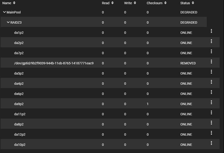

Let me give you a little back story. I just started with a company and I inherited the TrueNAS. It is running on a Dell R720xd with 12 Dell 2TB 7.2K 6G SAS 3.5" drives. We have been experiencing issues on our VMWare ESXi environment. I didn't receive any warnings, but I thought I would log into the TruNAS and check it out and sure enough there was a message saying the MainPool was degraded and a disk was removed. I'm picking up a replacement drive today and heading down to my datacenter to replace the drive. First, as I'm not that familiar with that server, I'm assuming that it should be easy to identify which bay the bad drive is in by the bay lights assuming there are bay lights. If not, is there a way to identify which bay the bad drive is in? Second, are the drives hot swappable? Finally, after I replace the drive, what are the steps to get it back in the array? Does it get automatically added back into the Raid or do I need to do something to add it back in. Thanks
Usually not...
If somebody who set the server up has done their job right, you'll have a list of drive serial numbers and identifiers somewhere either electronically or physically on the server... I bet you don't.
To find the identifier, you should start by looking at the disks view. This might help you to see which identifier is "missing" from the pool. (I can already bet it's /dev/da3)
If you have activity lights on the disk, you could (once you find the disk identifier) use this:
dd if=/dev/daX of=/dev/null bs=1024k count=1000 and watch the activity light on that disk light up. (replace daX with the right identifier)

I was able to easily identify the failed disk on the server. It showed an amber light. I changed the 'removed disk" to offline, then physically replaced the old drive with the new drive and instantly had a green light. The problem I am running into per the 'replacement' instructions is that it states to select a member disk, but when I click the drop down arrow, nothing shows, just a - . Am I missing something? Thanks

The failed disk light was a clue, but the automatic replacement is even more strange.
I suspect some hardware RAID involvement.
Based on what you showed, I don't see how it can be, but I don't understand what is going on.
You can try from disk view to wipe the new drive ( and refresh the browser) to see if you see the replace option.

Unfortunately when I go to disk view the new disk doesn't show. da0 through da12 all show up except da3. Da3 is where the new drive should be. Is there some place to scan for new drives?

It would be so very helpful if you would describe the hardware involved. Because Dell has a bunch of options on how to attach disks to a server, saying:
isn't particularly helpful or descriptive because it omits the truly useful bits.
Most problematic is that I suspect your system has a PERC H710 Mini in it, which will mean you're probably connected using the... guessing, MFI, driver. This has been known to be problematic in the past.
https://bugs.freebsd.org/bugzilla/show_bug.cgi?id=183618
etc. If so, the firmware on the card probably needs to be told to export the drive as a new JBOD disk, and at that point, you'll probably be happy, but there is a warning here that this has the strong possibility to go south on you at some point in the future, possibly resulting in data loss. You really need to replace the RAID controller with a true HBA.

Sorry, this server was setup months ago before I was with the company. All I have is the description on the invoice from when the server was purchased. It has the following info on it. DELL EMULEX LPE12002 8GB and Dell R720xd 12-Bay LFF Dual E5-2660 8C 2.2GHz 64GB (8x8GB)PC3-14900R 1Rx4 PERC H710p 1GB QP 5720 RPS 1100W NTCWP

Yep so you have a PERC H710 in there. I'll leave it to Dell experts to give more specific advice here, there are weird interactions with the internal RAID card PCI slot and other cards, but there's going to be some forward path available to swap in an HBA. Also, apparently some people have had success at crossflashing IT firmware onto the H710.
https://www.truenas.com/community/threads/howto-h710-crossflashing-to-it-mode-guide-online.82725/
I haven't done this but it is a plausible option.
