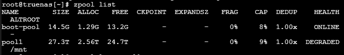

Your table doesn't really help explain what's going on.
Can you run zpool list and provide the output here?
ShadowChaser
Jun 10, 2022
5
is this what you are looking for? How do I list the disks in the pool?

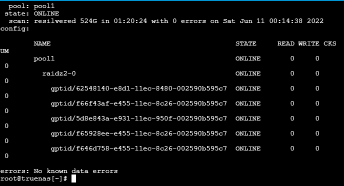

ShadowChaser
Jun 10, 2022
5
@PhiloEpisteme
I was able to put the drive back into the pool using the hot spare method I wrote about above, still I would like to know how I could have placed the disk back into the pool it was taken out of without needing to wipe it or needing to match vdev layouts.
If you need it, here's the zpool status of the fixed pool regardless.
