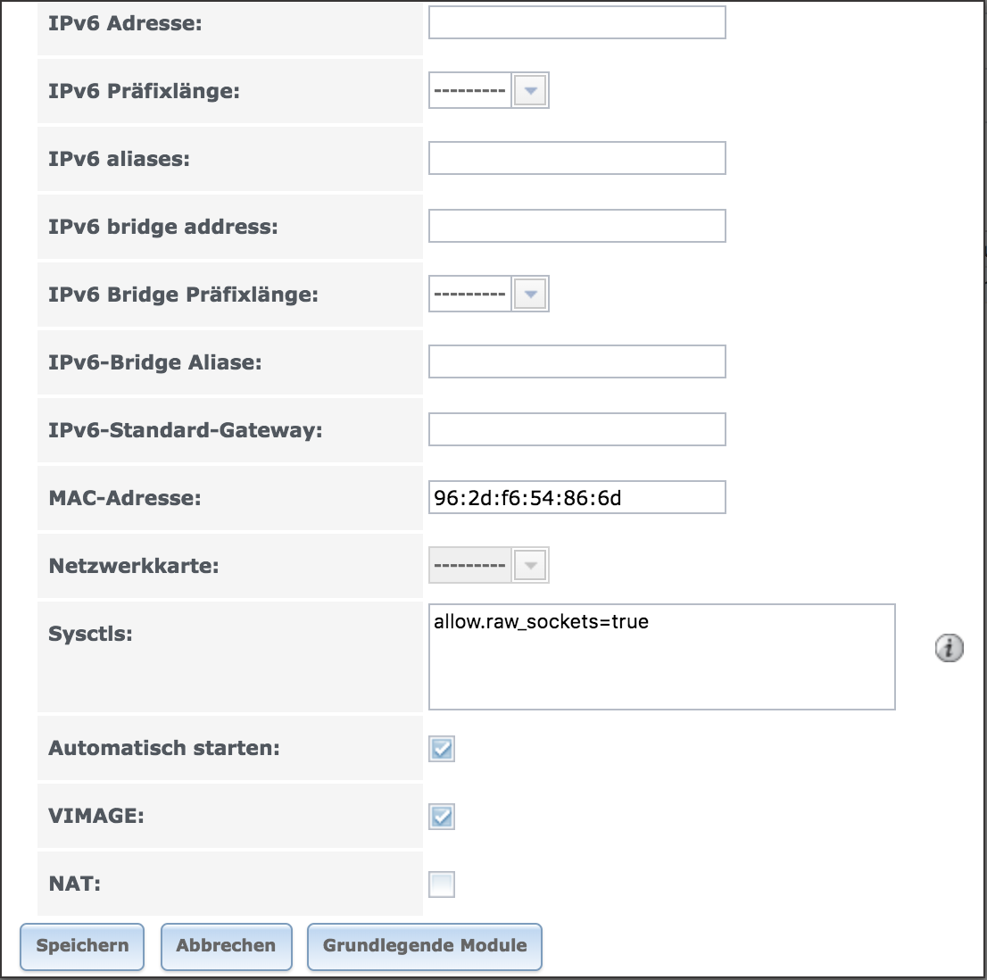

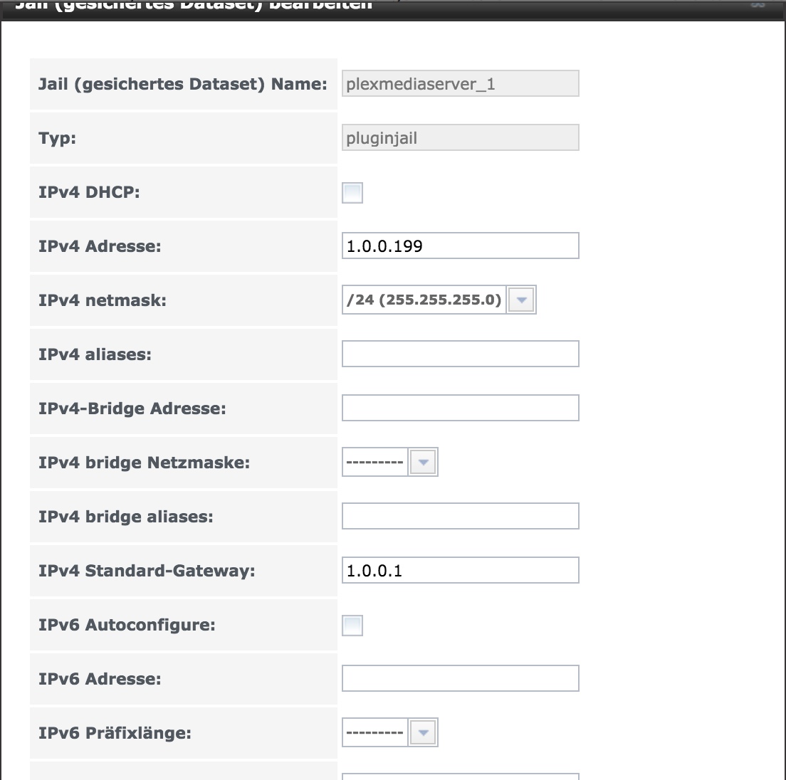

SimonMdot
May 17, 2018
15
This is done of course.
see attached screenshots
9,700
Could it be that you intended to use 10.0.0.1?
It seems like you are using the public address of 1.0.0.x instead.
SimonMdot
May 17, 2018
15
My Router is on 1.0.0.1, my Network adress Range is 1.0.0.2-.199
My intention is to have my freenas on 198 and my plex server on 199
15,504
My Router is on 1.0.0.1, my Network address Range is 1.0.0.2-.199
Those are not valid private IP addresses; they belong to ARIN.
SimonMdot
May 17, 2018
15
stupid me.
Thanks for the hint. It's a possible reason. I will check asap and let you know.
Jailer
Not strong, but bad
Sep 12, 2014
4,977
Make sure they are set to RFC1918 address space.
SimonMdot
May 17, 2018
15
Guys,
You saved me. Now it works.
Why my router and Freenas let me assign wrong ips is another question.
Anyways, thank you.
