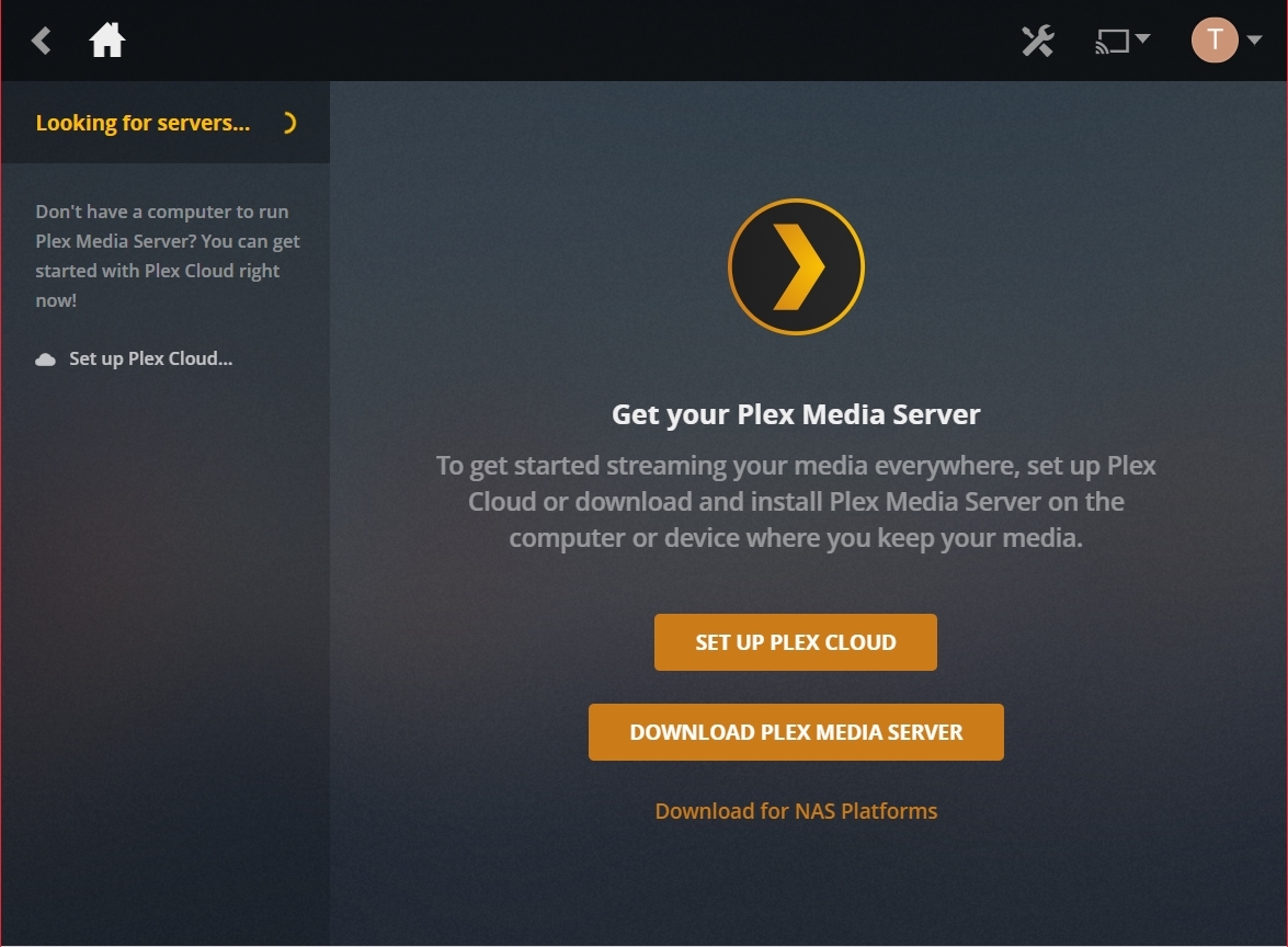

Hi there, I've recently installed freenas 11 and the plex plugin, I can connect to the web browser and login with my plex pass account, but there's no option for me to add folders from the NAS. It's almost as if it's installed the client side version of plex.

It looks like you took a screen shot of your Plex Pass Account, not the Plex Media Server. In your web browser enter plugin IP address:32400 and this should bring up the Plex Media Server. For example, my jail IP address is 192.168.1.53 so I use 192.168.1.53:32400 to get to my server.
That's what I did and it just directs me to that screen.

Let me see if I get this correct, the PlexMediaServer "Plugin" is really PlexMediaServer-PlexPass ? Since when? I'll admit that I install Plex in a jail like in the link @Jailer referenced, I stopped using the plugin a long time ago. Maybe it's the way you set it up after the plugin has been installed? Sorry if this sounds stupid but I don't have a Plex Pass account since I only use Plex at my home.

You'll have to do a manual install of the plexpass version in a standard jail.

IIRC you can't run the standard version if you have a plex pass account. But I could be mistaken........
No, it's the other way around. The plugin is the non-plexpass version; if you want the plexpass version, you'll need to install it manually.
Seems like a very odd restriction, but it would explain what OP is seeing.

It used to work a while back but they changed things and required authentication of your account upon installation. It would explain why the plugin isn't working for him and why he needs to install the plexpass version manually.
