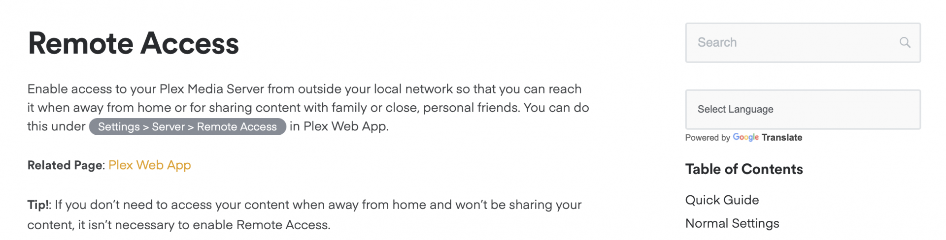

was basing my assumptions on:
when i clicked on remote access it said it's logged in, but not accessible, and if problems i clicked on linked supplied that then goes to the below image.
G

so i got it working...
i entered physical ips' per device, and not the network range.
