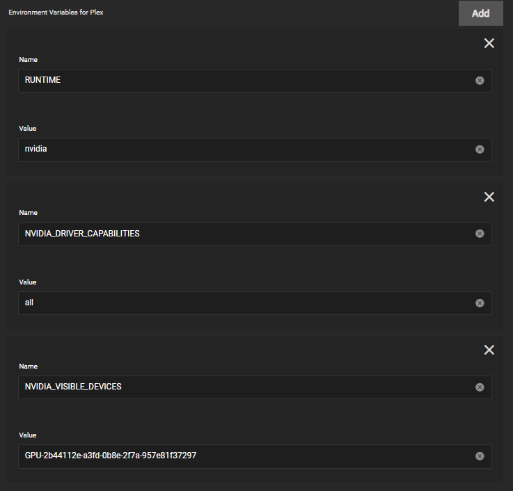

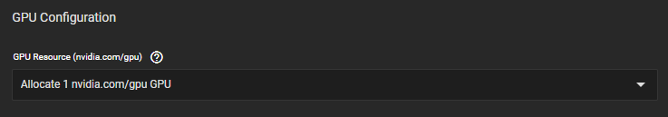

In order to expose the GPU to Plex, I followed this thread here and added the following environment variables to the app:

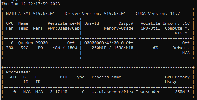

I confirmed with nvidia-smi that Plex is indeed using the GPU to transcode:
