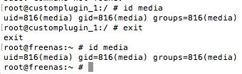

The name of the user and group mean nothing. The uid and gid need to match. What is the Id of the media user in the jail and on freenas?
carleycr
May 2, 2014
233
Pretty sure both are 816. Here is my understanding of how to pull the ID in the jail.
