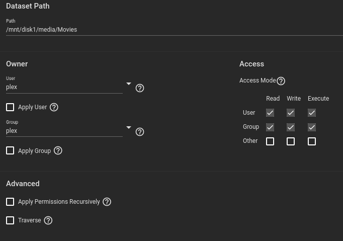

mnt/disk1/media/Movies (this is also a dataset within my disk1 pool set up within truenas, as instructed here)
- I had set up a plex 972 user and plex group 1000​
- Dataset was owned by root/wheel with user: plex; access = full control; recursive; inherit on and group: plex; access = full control; recursive; and inherit on​
- mount point set up to /mnt/disk1/media/Movies points to /mnt/jailhouse/iocage/jails/pms/root/media​
- adding plex user to media group within the accounts UI in truenas​
With these settings I was able to navigate to /media in plex, however, my Movies directory is viewable, but inaccessable (grayed out)

chown plex:plex (and media:media) on the Movies dataset from within my truenas CLI
changing the owner and group to plex:plex (and media:media) within the truenas Edit Permissions UI
chmod 777 for the directory (and subsequent child directories) via the CLI
viewing and changing ownership and permissions from within the pms jail console
setting the plex user's permissions wide open within the Edit User UI

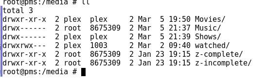

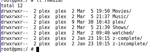

Via the CLI enter the jails console, iocage exec pmsgo to cd /media and see who owns the mounted files according to the jail. ll
Who owns the files? Maybe post a screenshot.
Also the plex user should have a group ID of 972 as well.

Jan 7, 2015
1,155

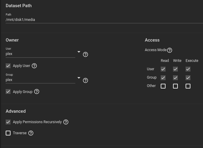

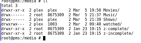

Hmm. What about the files inside Movies? I can tell that the plex jail does not know who the media user is. In the old days the media user was auto created with the user/group id of 8675309 jenny jenny lol... Add media user to jail with user/group id 8675309, possibly fixes it. However,....
Also if the main goal is plex, then let plex own it, all of it. That alone might cure all of this.. root can always access it. Just make sure you do it from the GUI as the GUI wont let you break things. Make sure the plex user/group is 972 on jail and host and let plex/972 just own it. And if anything anyone else needs access to the data add that user to the plex/972 group. And dont create separate jail for all accompanying softwares install in same jail, or repeat this issues.
The news is BSD is going away anyhow, so jails as we know them are dying. Sad, they are so good.

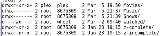

Edit: The plus sign at the end of the drxr-xr etc means the files are governed by ACL permissions, well im here to say they suck.. Stick to linux style permissions and have less issues.

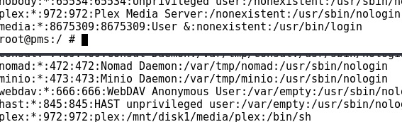

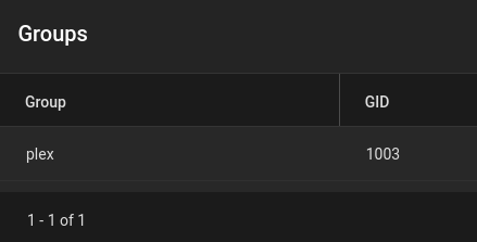

jhax
May 22, 2023
32

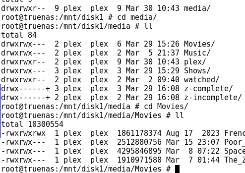

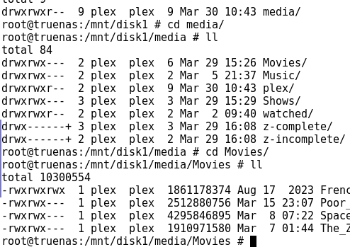

No such luck.
Outside the jail:
Inside the jail:

Jan 7, 2015
1,155
So those are your datasets mounted into the /media location within the jail. Anything removed from here will remove it.
But you still have something not quite configured right. You really should not be seeing numbers as owners. From the look of this plex should be able to read those directories.
Can you please verify what user and group id plex has according to the host cat /etc/passwd from the host CLI), and according to the jail iocage exec pms then cat /etc/passwd plex should be at the bottom of the lists and should say something very close to:
plex:*:972:972:Plex Media Server:/nonexistent:/usr/sbin/nologin
On both. So let me know if this is or isnt the case.
Also who is user 1003?
Jan 7, 2015
1,155
And to add the media (8675309) user to the jail do these from the jail command line while you are in there.
pw useradd -n media -u 8675309 -d /nonexistent -s /usr/sbin/nologin
pw groupadd -n media -g 8675309
pw groupmod media -m plex
Also whoever user 1003 is according to the host you might as well just add them to the jail as well.. Just edit and repeat the above commands for the 1003 user/group whoever it is fill in with the correct name....
pw useradd -n ???? -u 1003 -d /nonexistent -s /usr/sbin/nologin
pw groupadd -n ???? -g 1003
pw groupmod ???? -m plex -m media
Now at very least it should not be showing you numbers as group owners of the files. Once you have verified the plex user/group is 972 on both host and jail, from the jails CLI id do chown -R plex:plex /media && chmod -R 774 /media

Bottom is host CLI top is within the jail

Okay, I have everything updated, Ill give it another go.
Here is inside the jail
Outside the jail
Here is the passwd file again

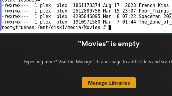

Still no access to my content within plex

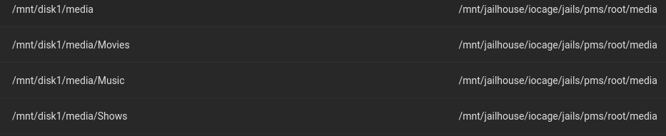

Ok. So you can't mount a dataset with datasets underneath and have it work properly. You need to mount ALL the datasets for the files to show up. So if you have a dataset called "media" with sub-datasets underneath it, you need to mount ALL the sub-datasets also. It's just how jails work.
jhax
May 22, 2023
32
They are all mounted to media. Should I just destroy the jail, delete the sub datasets and re-install?
You need to mount each dataset to its own folder. Movies should be mounted to media/Movies etc…
Jan 7, 2015
1,155
So this is something I wouldnt have caught. He is saying to create the directories Movies, Shows, Music, etc.. within the plex jail inside /media so give that a try. From CLI,

You don’t have to create the directories. Just fill them out when mounting and they will be autocreated.
