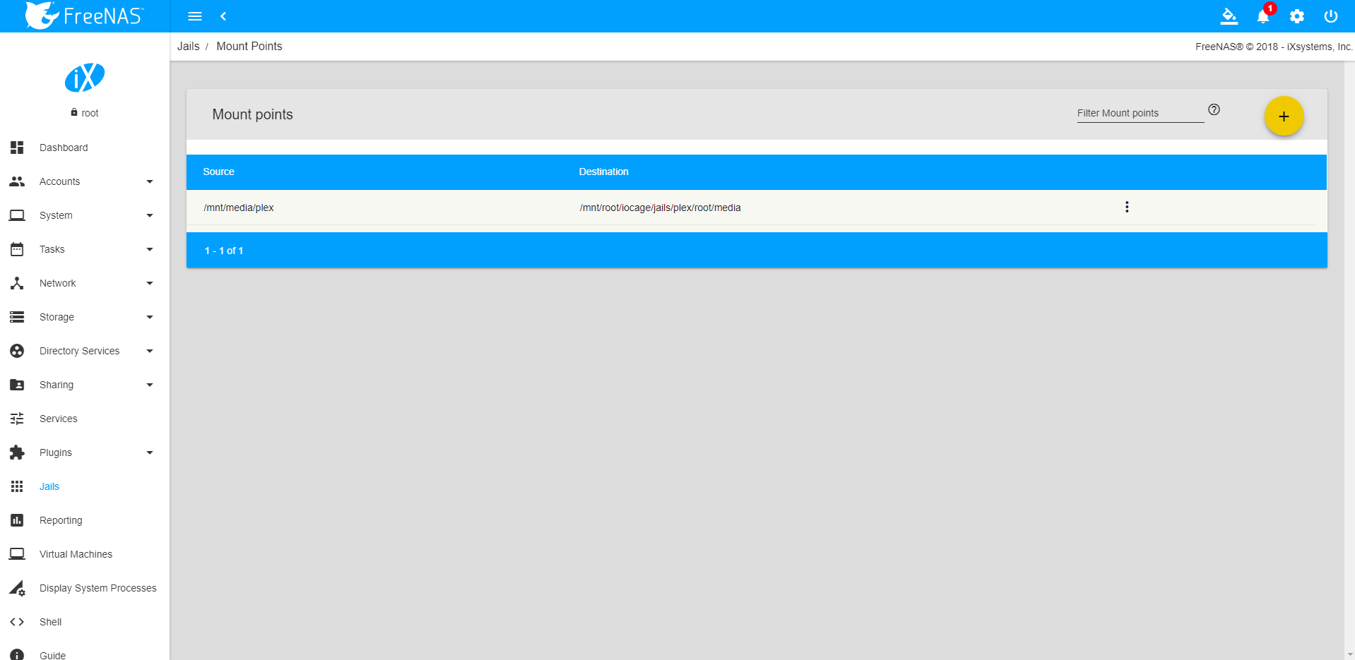

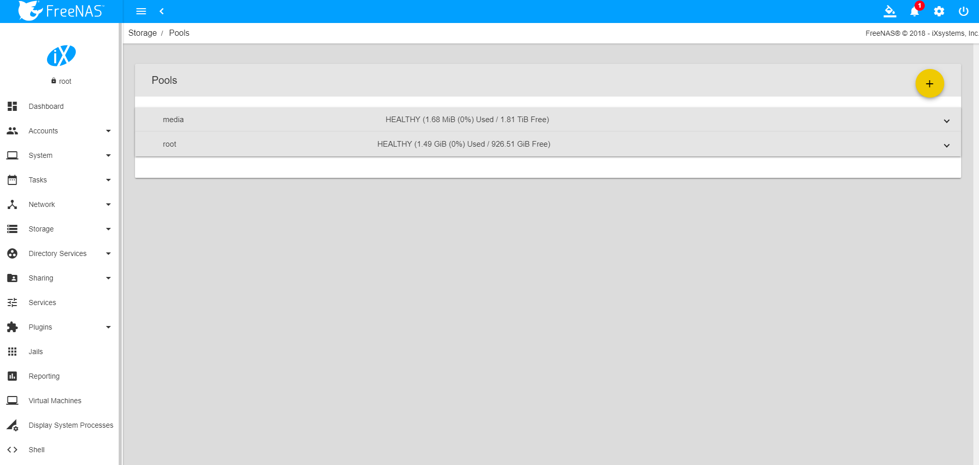

hey, I'm having a problem when I try to start plex jail on FreeNAS 11.2-RC1
idk if this is a bug or not. the media and the root are on separate pools. their are images.

jail: /sbin/mount -t None -o rw /mnt/media/plex /mnt/root/iocage/jails/plex/root/media: failed
Does the destination directory exist? It's having trouble mounting the dataset. Typically the path to the iocage jail is /iocage/jails/<jailname>/root/.
RJGamer1002
Oct 30, 2018
13
Yes the destination directory exist and The error only happen when they are in separate pools. When the source and the destination are in the same pool it work fine.
