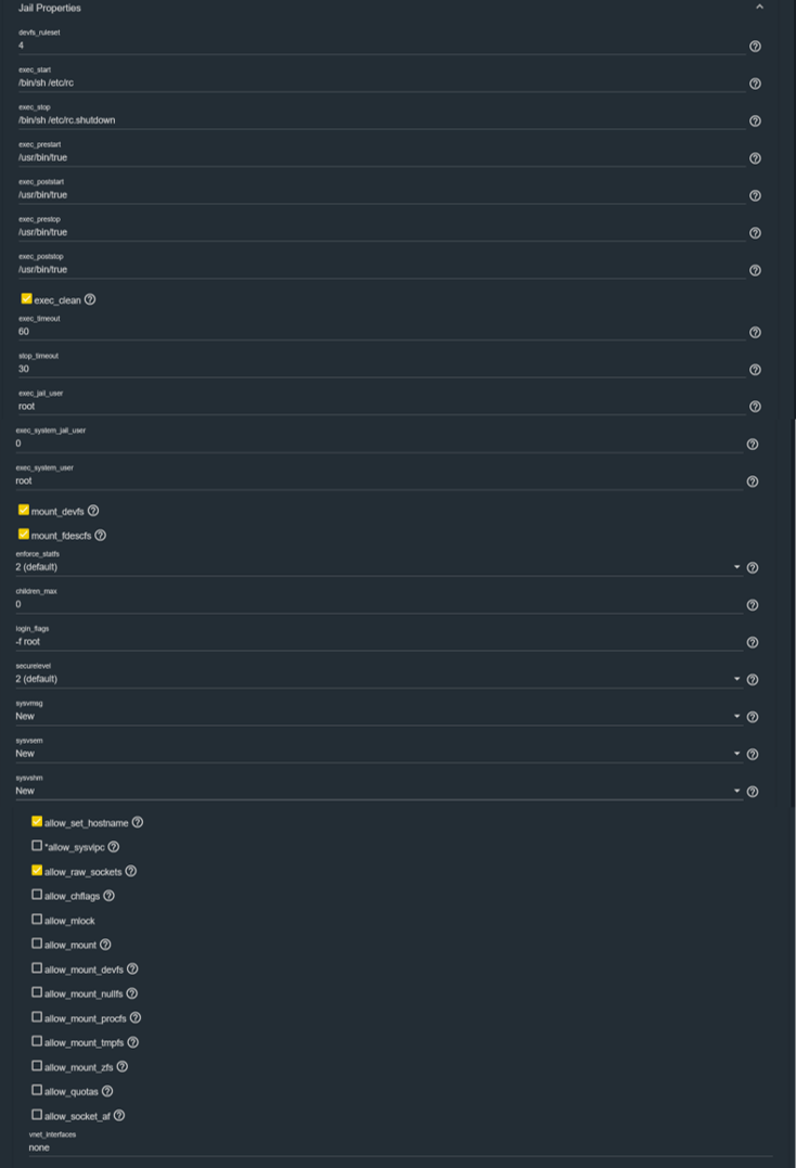

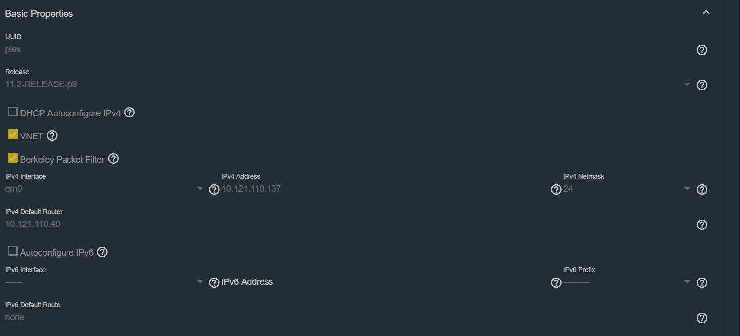

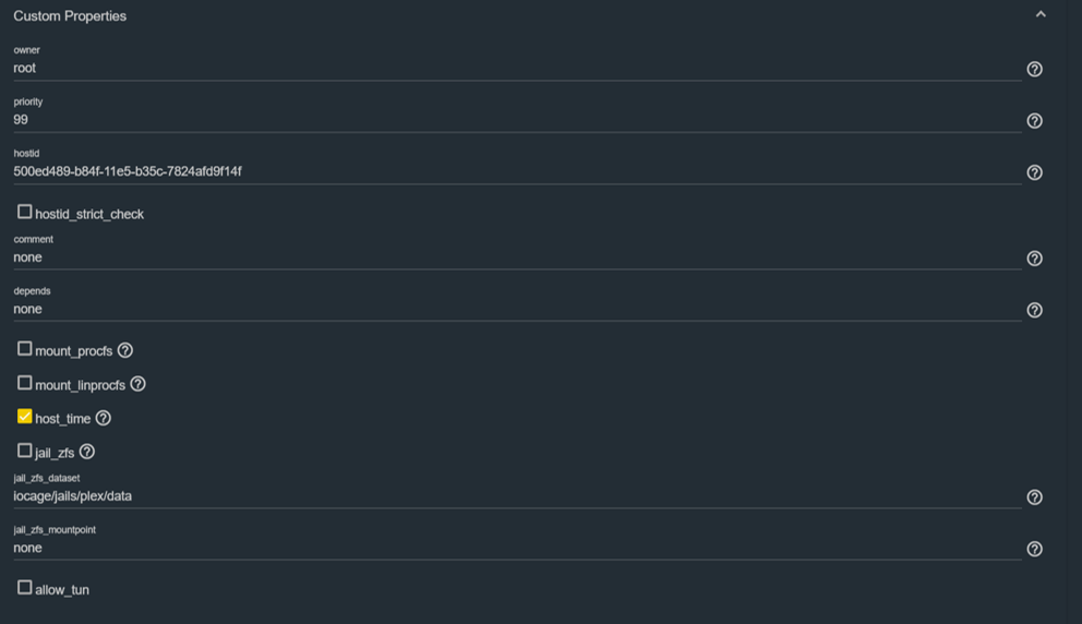

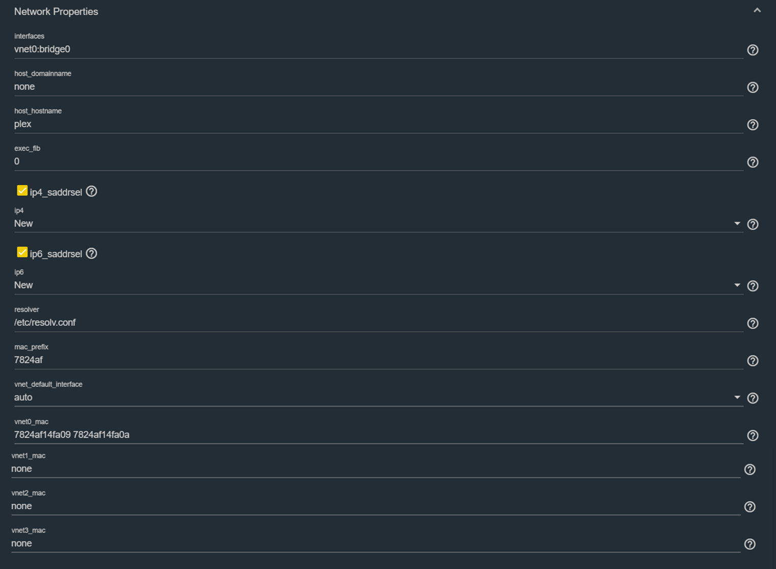

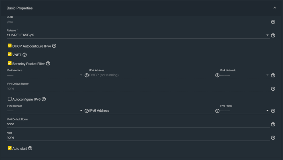

Can you take screenshots of the different configurations options your jail is currently set to?
00DerM
Apr 28, 2015
11
Thanks for your help!
nojohnny101
Dec 3, 2015
1,477
A couple of things:
- you don't have a default interface assigned in "basic properties". give that a value.
- is there any reason you have "Berkeley Packet Filter" checked?
Try those things and report back

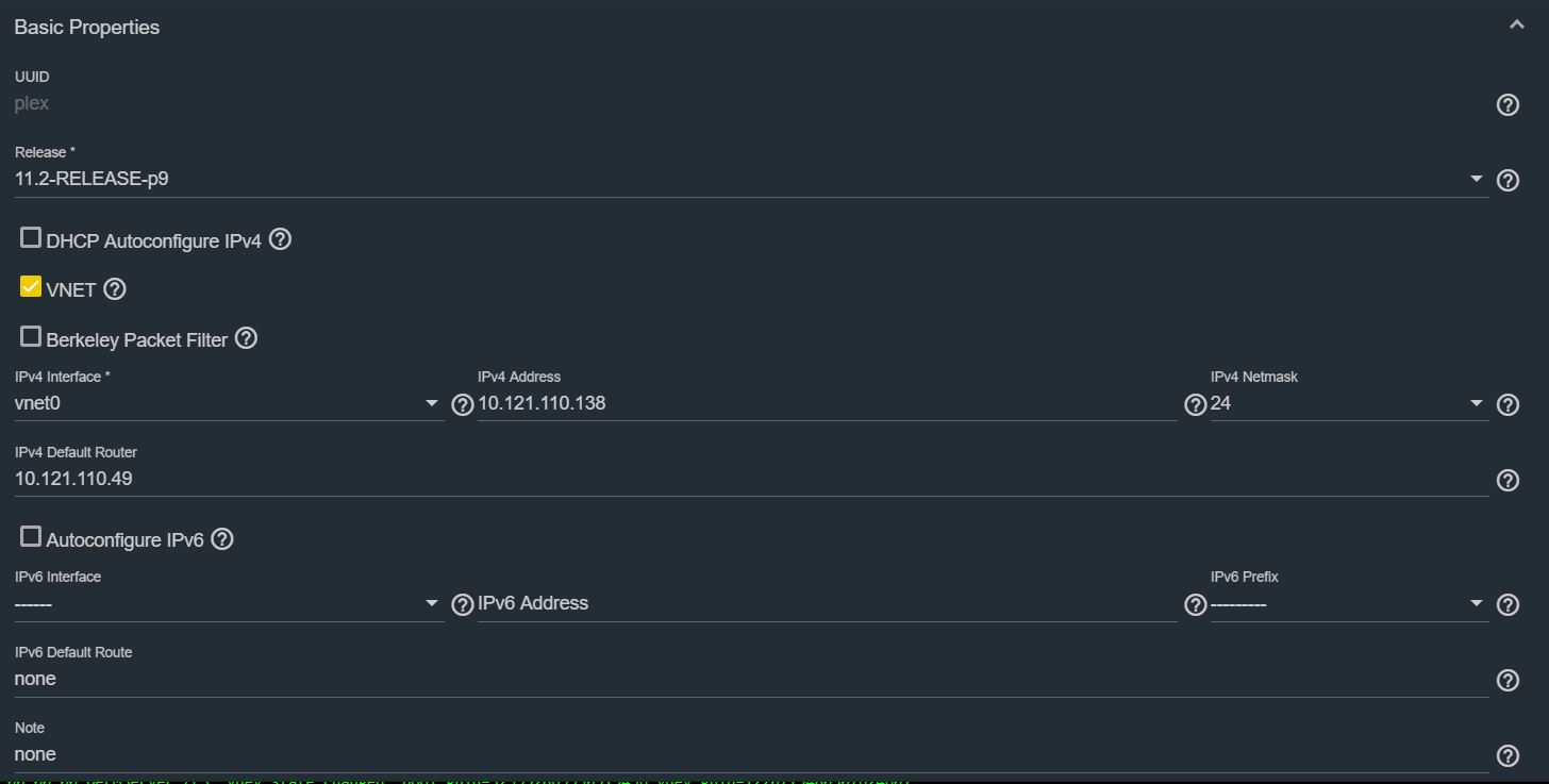

nojohnny101, I made the change to the basic properties, my thought is to get it setup on DHCP and running first then I could work on a static IP after that.
For the "Berkeley Packet Filter" it was setup default and a few walk-through's said to use that.
After making those changes I still get the "Stopped plex due to VNET failure" error.

No your default interface should not be vnet, it should be the same interface your main box uses.
vnet0 here .. Plex, Tautulli, and UniFi controller working great

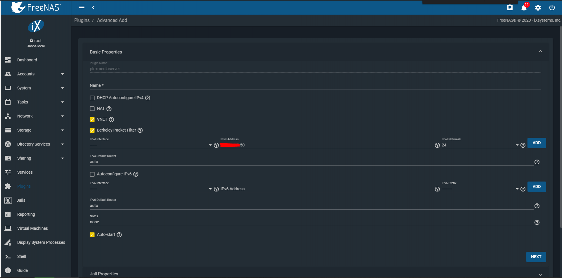

I will post the same as I did in https://www.ixsystems.com/community/threads/vnet-failure-partial-plugin-destroyed.81488/, maybe you do not need any help anymore but I stumpled on this post looking for a solution and now it seems like I have one. Using 11.3.
So I had to "trick" the UI after going into advanced to get it going on my static IP. I am finally upgrading from 9.10 as PLEX had my old plugin version flagged as not supported(and rightfully so, shame, but yeah time etc.). So I am rebuilding all jails, but want to keep the port forwards to the same ip's I had all along. Setting the static IP was mandatory for me rebuilding my nas functionality.
It wasn't pretty but it works fine at first glance:
Basic configuration does not work, VNET failure or missing configuration. Tried all combinations, no gucci.
After clicking install on the plugin and going into advanced, I disabled autoconfigure IPv4 but the UI bugs out and does not allow me to set IPv4 interface and netmask (grayed out):
After toggling on and off the NAT checkbox you are able to set the desired ip and netmask, however leave the interface blank:

Hi all,
Sorry for commenting this thread after almost 4 years but I really have a problem ...
I had a Freenas 11.2 U8 working properly and I wanted to make some clean on my datasets organization and permissions related to before upgrading 11.3. When I was finally done, I screwed up my entire configuration by overwriting every permissions from the root dataset of my pool.
I had a Qbittorrent and Plex plugins running before and despite Qbittorrent was still working because it uses root authentication, Plex wasn't working at all ...
I finally decided to erase the entire iocage dataset, migrate to Freenas 11.3, and rebuilt my entire configuration from scratch.
I'm now trying to reinstall Plex but I've got the below error even through VNET ... I really don't know how to deal with.
Any idea where does it come from ?
Error: plexmediaserver had a failure Exception: RuntimeError Message: pkg error: - Certificate verification failed for /C=US/O=DigiCert Inc/OU=www.digicert.com/CN=DigiCert Global Root CA 12933140:error:14090086:SSL routines:ssl3_get_server_certificate:certificate verify failed:/freenas-releng/freenas/_BE/os/crypto/openssl/ssl/s3_clnt.c:1269: Certificate verification failed for /C=US/O=DigiCert Inc/OU=www.digicert.com/CN=DigiCert Global Root CA 12933140:error:14090086:SSL routines:ssl3_get_server_certificate:certificate verify failed:/freenas-releng/freenas/_BE/os/crypto/openssl/ssl/s3_clnt.c:1269: Certificate verification failed for /C=US/O=DigiCert Inc/OU=www.digicert.com/CN=DigiCert Global Root CA 12933140:error:14090086:SSL routines:ssl3_get_server_certificate:certificate verify failed:/freenas-releng/freenas/_BE/os/crypto/openssl/ssl/s3_clnt.c:1269: pkg-static: http://pkg.cdn.trueos.org/iocage/11.3-RELEASE/meta.txz: Authentication error Certificate verification failed for /C=US/O=DigiCert Inc/OU=www.digicert.com/CN=DigiCert Global Root CA 12933140:error:14090086:SSL routines:ssl3_get_server_certificate:certificate verify failed:/freenas-releng/freenas/_BE/os/crypto/openssl/ssl/s3_clnt.c:1269: Certificate verification failed for /C=US/O=DigiCert Inc/OU=www.digicert.com/CN=DigiCert Global Root CA 12933140:error:14090086:SSL routines:ssl3_get_server_certificate:certificate verify failed:/freenas-releng/freenas/_BE/os/crypto/openssl/ssl/s3_clnt.c:1269: Certificate verification failed for /C=US/O=DigiCert Inc/OU=www.digicert.com/CN=DigiCert Global Root CA 12933140:error:14090086:SSL routines:ssl3_get_server_certificate:certificate verify failed:/freenas-releng/freenas/_BE/os/crypto/openssl/ssl/s3_clnt.c:1269: pkg-static: http://pkg.cdn.trueos.org/iocage/11.3-RELEASE/packagesite.txz: Authentication error Please check your network Partial plugin destroyed
