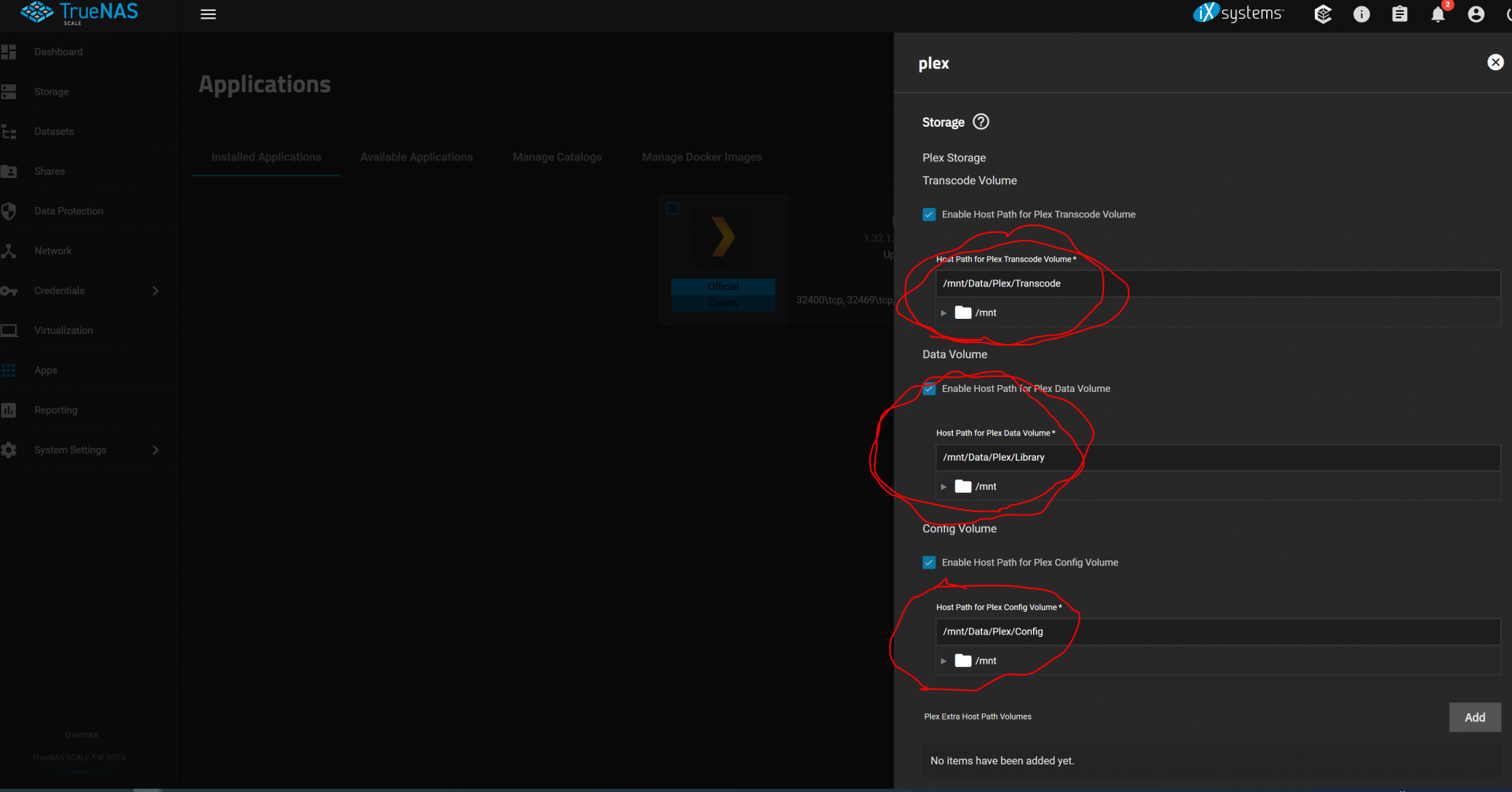

Plex has '/mnt/plex/transcode', '/mnt/plex/library', and '/mnt/plex/config' pass through to its transcode, data, and config folder options respectively.

First I notice a typo iof oversight due to typing off memory n my original post and my previous quote of it the path is /mnt/Data/Plex
I was changing the permissions there as the transcode, library, and config folders that get passed to the docker/app for plex live inside that folder so by changing the parent folder I was hoping to change the child folders by extension. Please note that /mnt/Data/Plex and all it's sub folders is a directory tree I created to hold the external files that get mapped inside the docker, that is not the path for the docker itself.
The transcode folder is /mnt/Data/Plex/Transcode
the data or library folder is /mnt/Data/Plex/Library
The config folder is /mnt/Data/Plex/config
and all 3 are configured to be passed as the real locations of the files into the plex docker app.

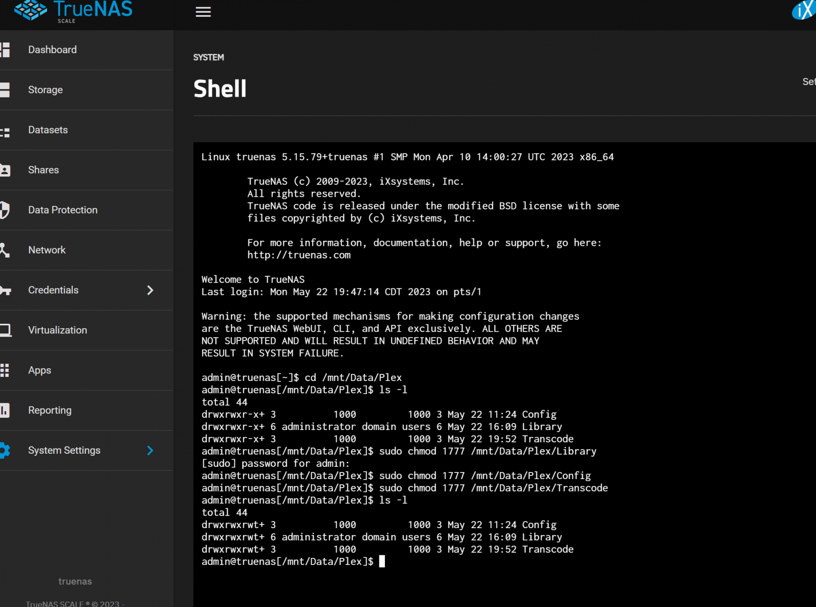

That said I will be ensuring their permissions are set to 1777 here in a moment just incase that did not propagate from the plex parent folder.

So indeed the child folder's permissions were not set see the first screenshot below where I also set them.

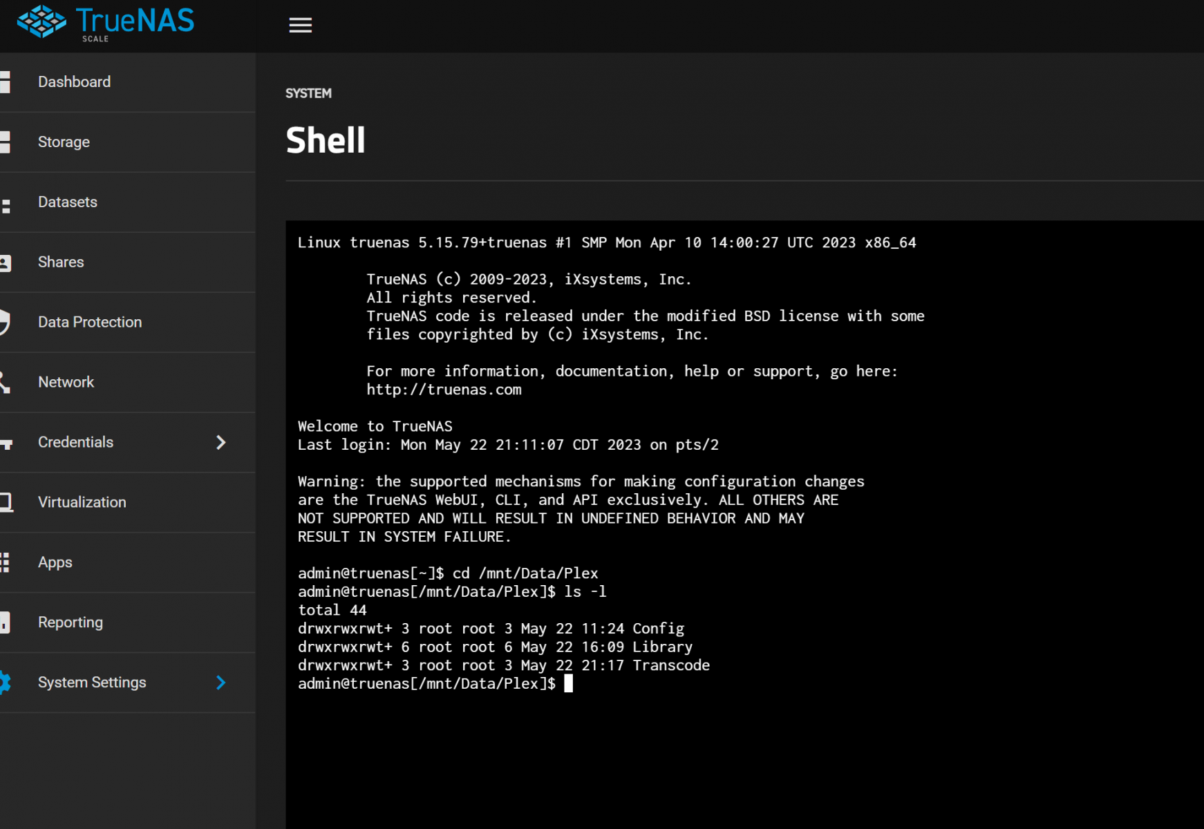

Also I have a domain and separate from project plex on the NAS but Rather regarding project Populate data onto my nas from old storage sources I had previously been meddling with that and I guess it got accidentally set (or more likely set when I didn't yet have a full handle on what I was doing and it's repercussions (still don't if we are being real)).
That said I vaguely recalled where I was when meddling with all of that so I went back there and set it back to root, set full permissions and ticked the box to apply recursively - See second screenshot
Tested between the first and second screenshot and after doing what is shown in the second screenshot
The problem unfortunately remains unchanged....
