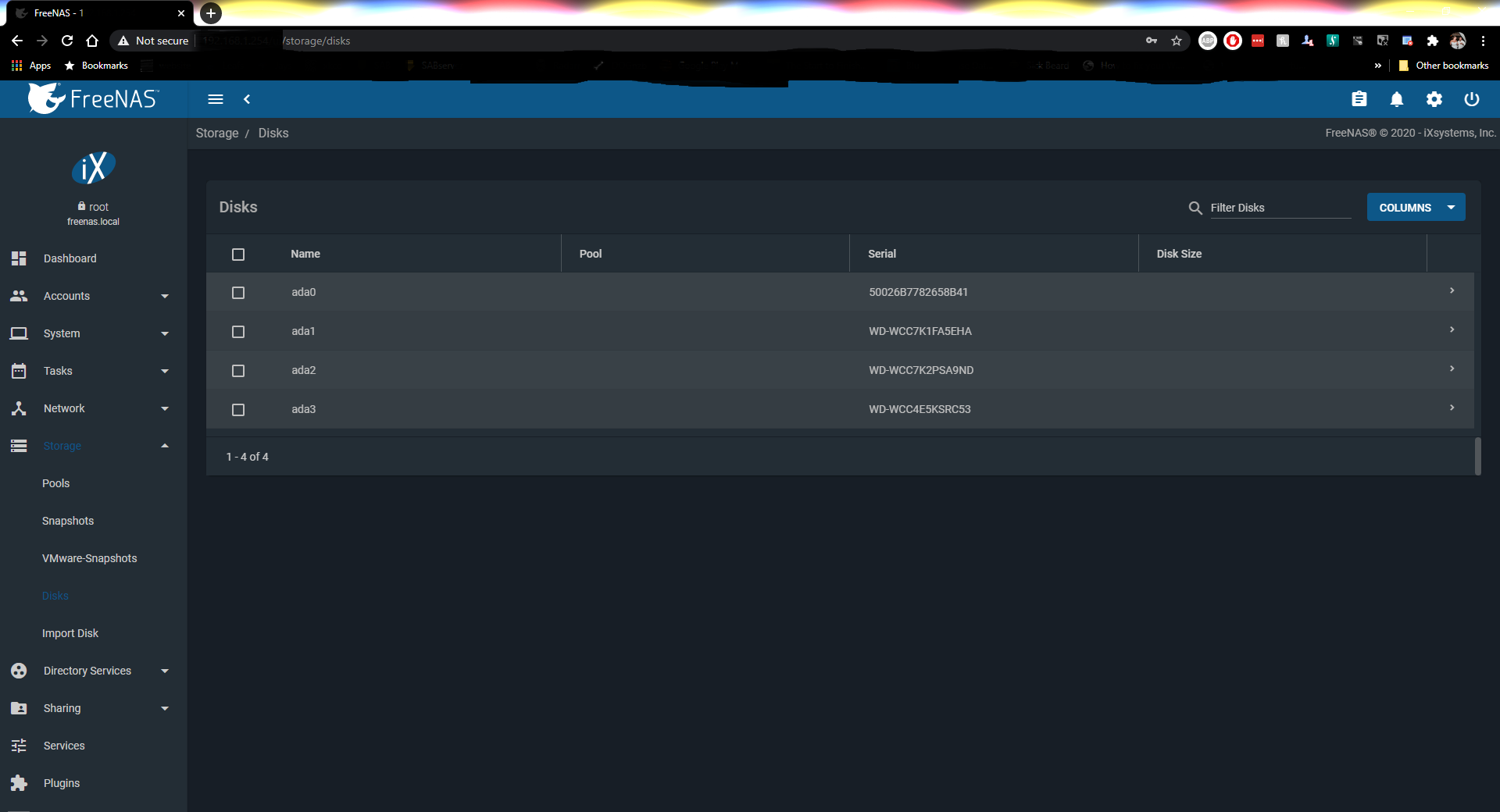

Hey guys,
I'm a 2yr user (very novice still so be nice haha) So, on Saturday, I was moving a few things around, and knocked the surge protector off the wall (no UPS) and my server (11.3 u4.1) turned off, I plugged everything back in, and couldn't get anything to start up, so reinstalled FreeNas on my SSD drive, and I was able to get back into FreeNas, but I lost my pool.
When I boot up, I get something that says GEOM ADA1 - Corrupt or invalid GPT Detected - GPT Rejected - may not be recoverable
I tried to do a few things, couldn't get the pool to load, actually pulled all the drives and quickly built another server box thinking something with the sata connections (motherboard) might have fried.
When i log into the webgui, I see my 3x 4TB drives, but I try to import the pool, it is blank, and I went into gpart status, and it shows my boot drive SSD and 1 of my 4TB drives. But if I go into disks in the webgui, the drives all show and show as being healthy.
I've included some screen shots, PLEASE help me.

Check to ensure that your drives are being detected in your BIOS or hardware level first.
Next, see if they are visible in geom disk list
From there, check if they're seen by smartctl -a /dev/adaX and if it's throwing any horrible looking warnings.
9,700
I think you may be in the right area in having seen this as at least part of the problem
if you do dmesg | grep Corrupt what do you see?
If it's only ada1, maybe excluding that disk and having a shot at importing the pool might be a way forward... if that gets you to an imported (but degraded) pool, you can wipe and resilver ada1 back in.
If not, or if your pool had no redundancy (in which case, welcome to your very harsh lesson in potential data loss), you may be able to dig up a thread which talks about using the partition headers from one of the other disks to replace the corrupt one(s), but I feel like that's a topic a bit too far advanced to link to right now unless there are no options left.
So I did the dmesg and it didn't do anything.
root@freenas[~]# dmesg | grep Corrupt
root@freenas[~]#
[\quote]

  4 Start_Stop_Count        0x0032   098   098   000    Old_age   Always       -       2387
  5 Reallocated_Sector_Ct   0x0033   200   200   140    Pre-fail  Always       -       0
  7 Seek_Error_Rate         0x002e   200   200   000    Old_age   Always       -       0
  9 Power_On_Hours          0x0032   077   077   000    Old_age   Always       -       17420
 10 Spin_Retry_Count        0x0032   100   100   000    Old_age   Always       -       0
 11 Calibration_Retry_Count 0x0032   100   100   000    Old_age   Always       -       0
 12 Power_Cycle_Count       0x0032   098   098   000    Old_age   Always       -       2387
192 Power-Off_Retract_Count 0x0032   200   200   000    Old_age   Always       -       144
193 Load_Cycle_Count        0x0032   001   001   000    Old_age   Always       -       1549465
194 Temperature_Celsius     0x0022   115   102   000    Old_age   Always       -       35
196 Reallocated_Event_Count 0x0032   200   200   000    Old_age   Always       -       0
197 Current_Pending_Sector  0x0032   200   200   000    Old_age   Always       -       0
198 Offline_Uncorrectable   0x0030   200   200   000    Old_age   Offline      -       0
199 UDMA_CRC_Error_Count    0x0032   200   200   000    Old_age   Always       -       0
200 Multi_Zone_Error_Rate   0x0008   200   200   000    Old_age   Offline      -       0
SMART Error Log Version: 1
No Errors Logged
No self-tests have been logged.  [To run self-tests, use: smartctl -t]
HoneyBadger
actually does care
Administrator
Feb 6, 2014
5,112
ADA3
If that drive hasn't already failed, it's probably going to. A million and a half LCCs is well past its duty cycle.
Do you know your pool config? A Z1 will import if only short one drive.
