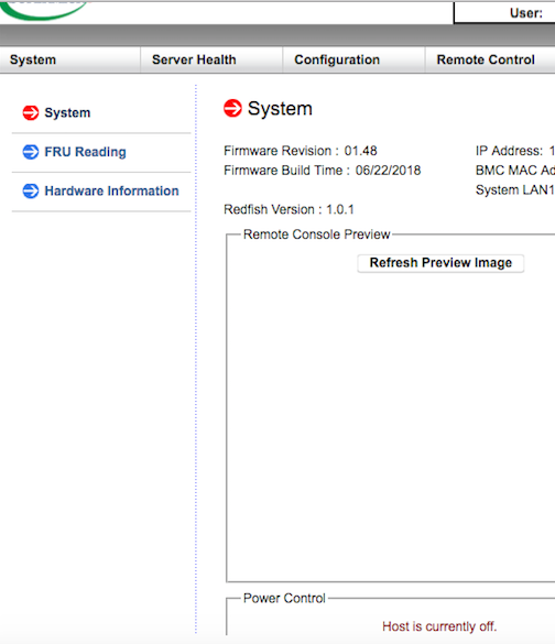

New X11SSM-F-0 arrived recently.
Wanted to know BIOS version on this new MBO before making decision to buy the Xeon E3 1240v6 Or i3-7320 CPUs
Tried connecting it to the ATX Corsair CX450M power supply connectors (both 24pins & 8pins) via JPWR1 & JPWR2 power connectors. Also connected power button connection to JF1 Pin 1 & 2.
My Observations:
1) IPMI LAN Link LED is on and activity LED is blinking
2) BMC Heartbeat LED is Blinking Green
3) On board PWR LED is OFF (no green light, totally no light)
Press the "On" button but nothing happens.
Also tried to turn it on via IPMI. Failed to turn on.
What's wrong? Is it a Dead Motherboard on Arrival (DOA) ?
Not sure what to do now...
Chris Moore
May 2, 2015
10,079
You just apply power to the board and IPMI comes on. You don't need to turn it on. You access the IPMI interface through the IPMI network connection using a web browser. Here is a YouTube video that might help:
https://www.youtube.com/watch?v=cPv_ikws7A0
