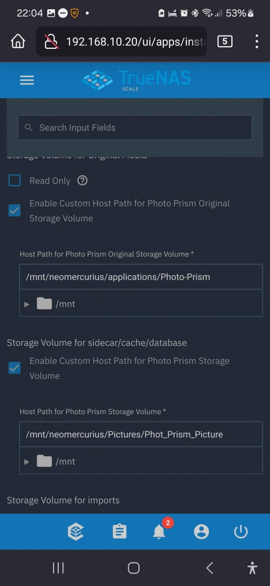

Is your photoprism save in the regular location, in the ixapp folder? Or on a separate folder on the pool (aka costum folder)?
sfatula
Jul 5, 2022
608
Not sure what you mean by ixapp folder.
Neopegasus
Dec 6, 2023
37
Yes you have host folder, and ix-app location aka pvc like this:
But it looks like mine.
I still can't figure out what is the problem why some of us can't update to the latest update
