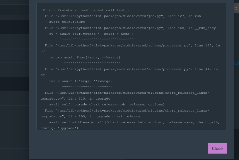

Photoprism Failed to upgrade App: Migration to 2.x.x is only allowed from 1.1.3 or higher
chri5
Apr 8, 2022
76

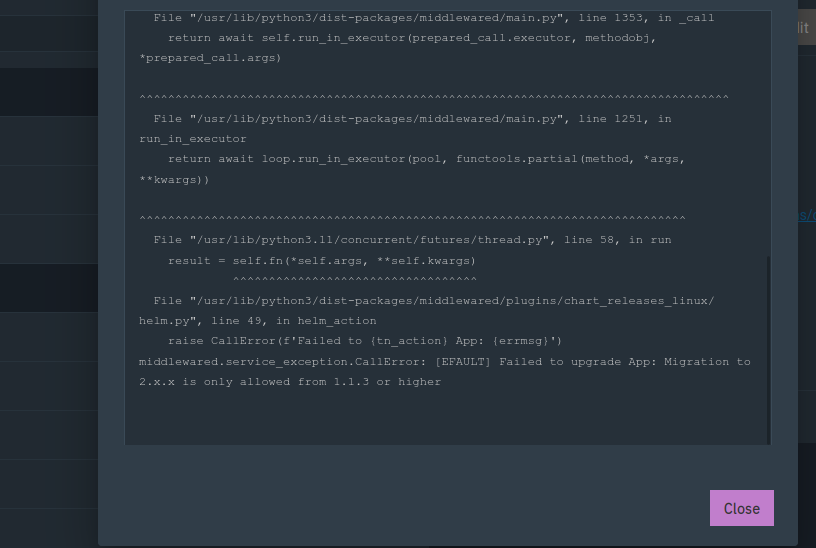

See attached. I usually update as soon as a new release is ready. I must have missed 1.1.3 (I doubt it though as I look every day).
What are my options here?

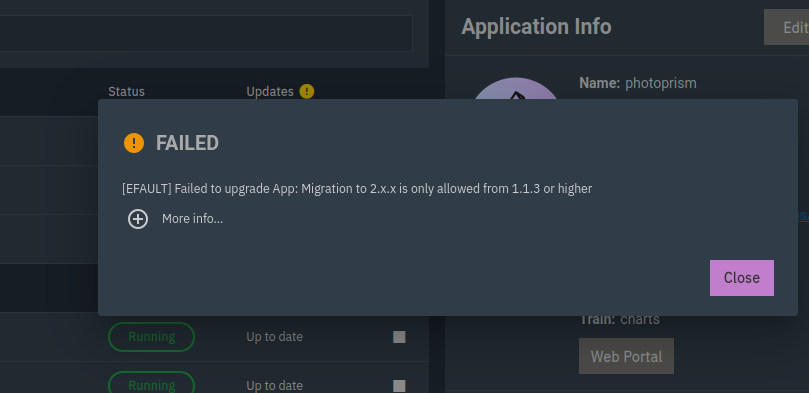

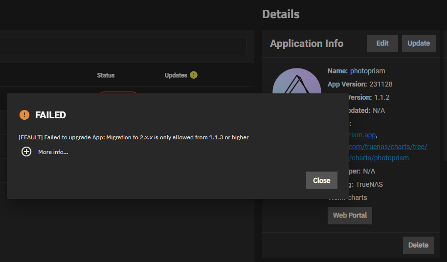

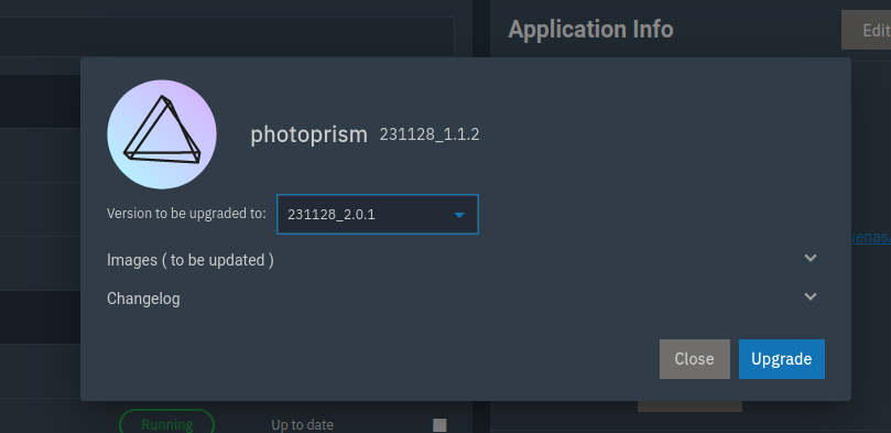

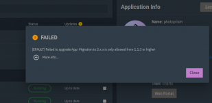

I have the same problem , I receive a e-mail when there is update for a app.
there was one yesterday already to go to the 2.0.0 but did not work I thought to wait for the next one maybe they fix it , today i have the info about 2.0.1 so try it out but same!
I am running: TrueNAS-SCALE-23.10.1.3

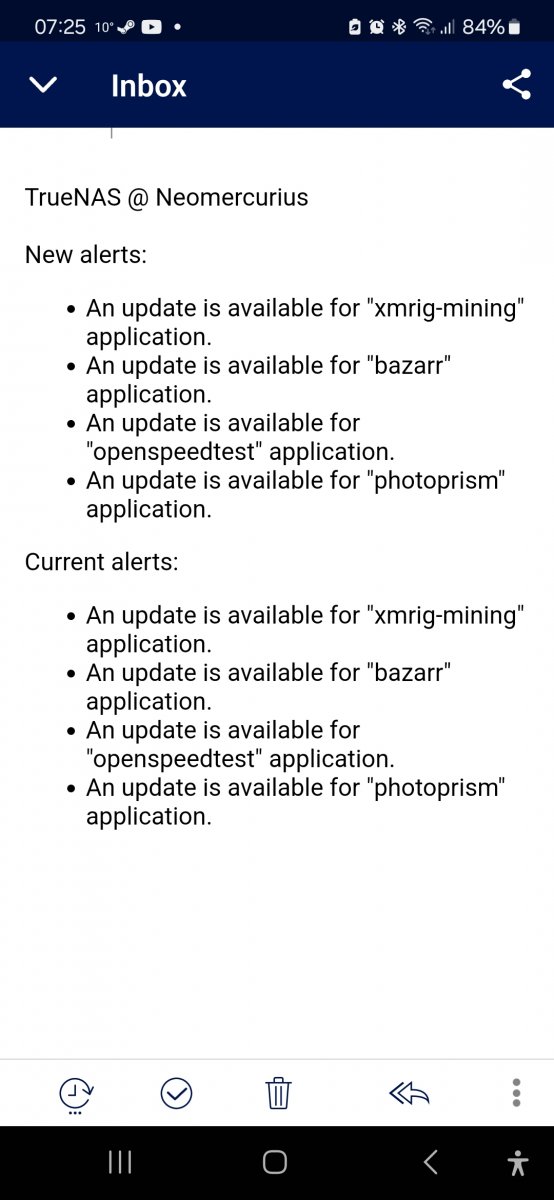

The strange thing is we didn't miss a update how it's doing this?
Like today this is the email I get from my truenas:
Somewhere and somehow the 1.1.3 got jumped.

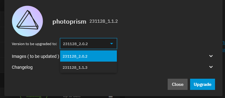

Hello, today I was able to update first to 1.1.3 by selecting it manually, then I updated again to 2.0.2.
Note: wait at least 5 minutes before upgrading to 2.x.x, I needed to downgrade as the deployment failed
1.1.3 is still not available to select in mine but at least I can be hopeful it might show up soon.
