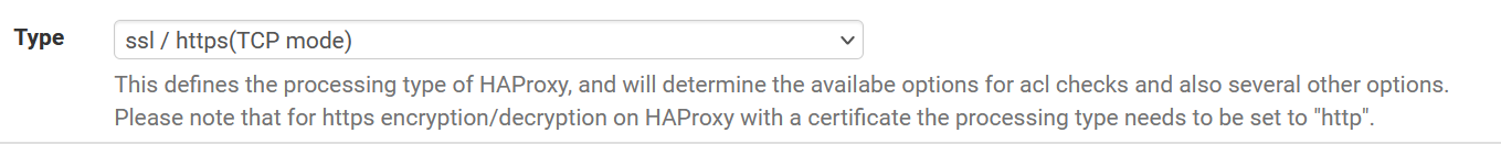

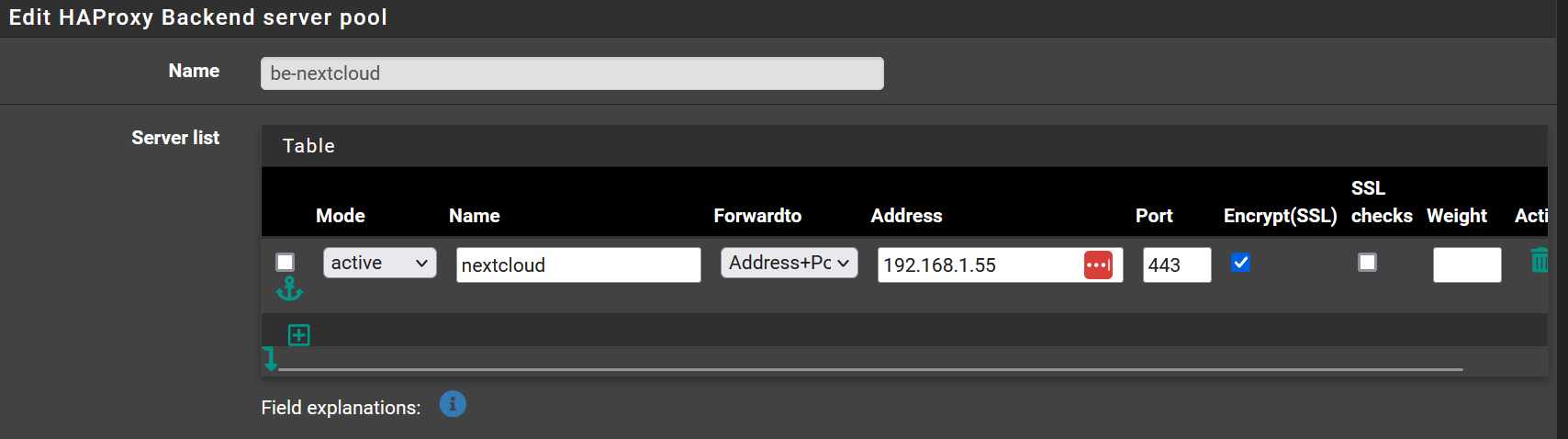

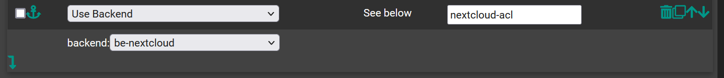

Not sure if this will work for you, but in pfsense I use TLS passthru in HAProxy for my apps that manage their own certificates. See if this helps.

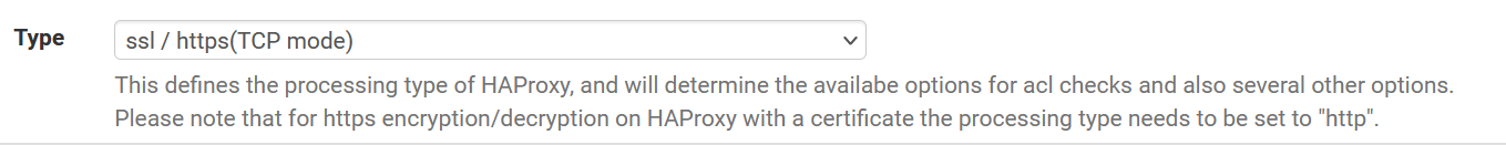

Create a frontend with the interfaces you want to listen on. Include your WAN interface as well (mine is chopped off for security).
Make sure to set the type to "ssl/https(TCP mode)"

Create a backend that points to the application/service/ip you are trying to access

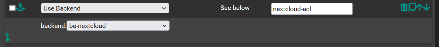

Then, edit your frontend create an ACL and Action in the frontend that matches the hostname you want to pass thru to

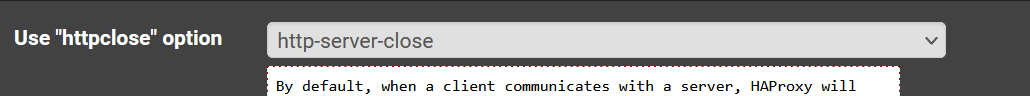

FWIW, my frontend is defined with http-server-close, can't remember why

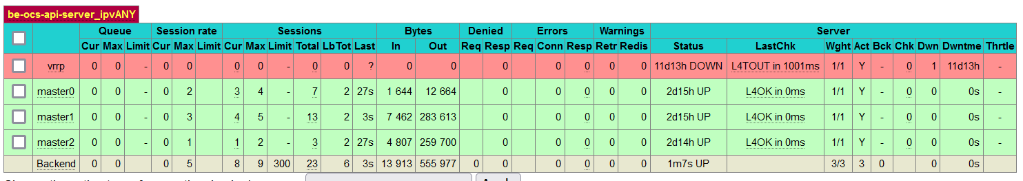

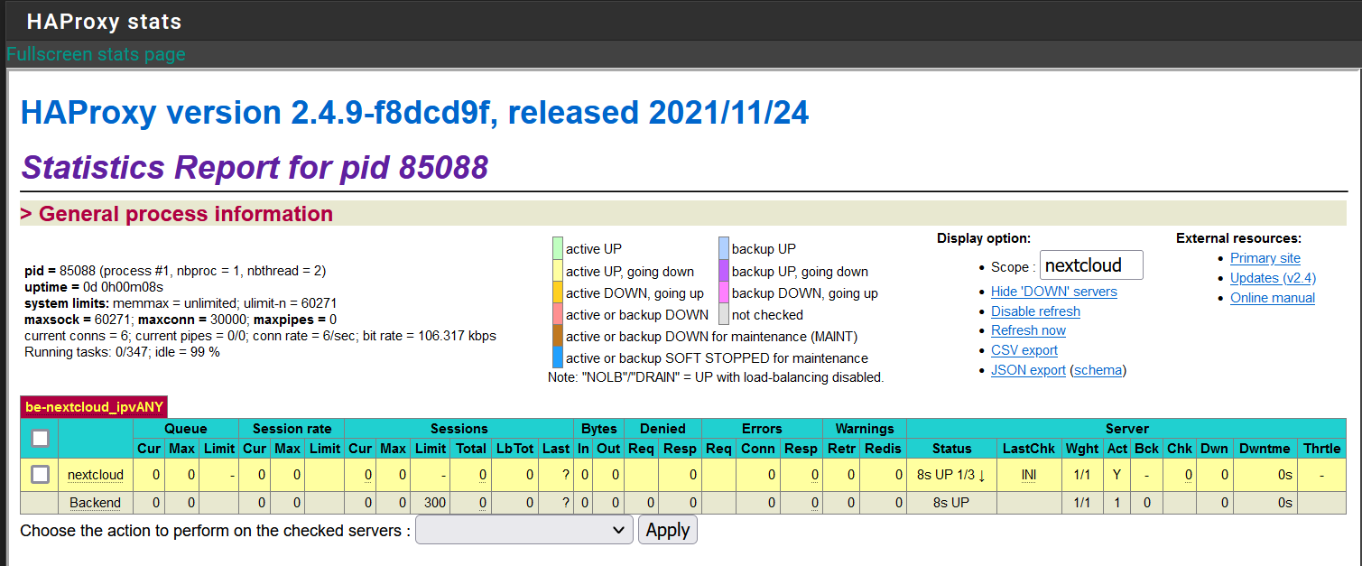

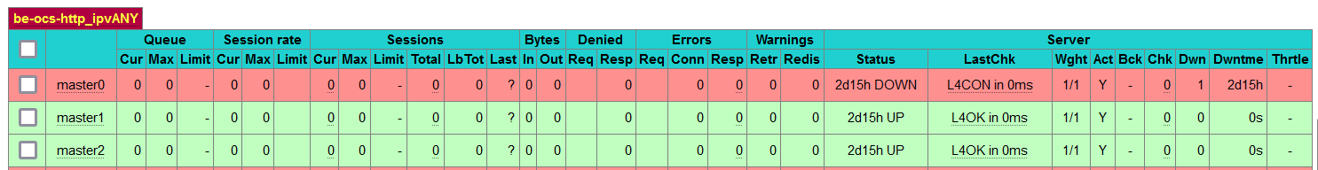

Save and Apply. You should see your backend in the stats page. The line will turn green once your backend is accessible.
Here is one of my kubernetes clusters.

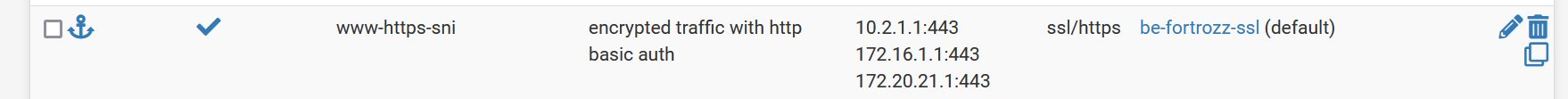

Dear @revoman, thank you for sharing your setting parameters. It turns out that I have a very similar set of parameters. One difference is the frontend type. You recommended to set it up to "ssl/https(TCP mode)"; my configurations uses "http/https(offloading)". What would be the main difference introduced by these settings?
