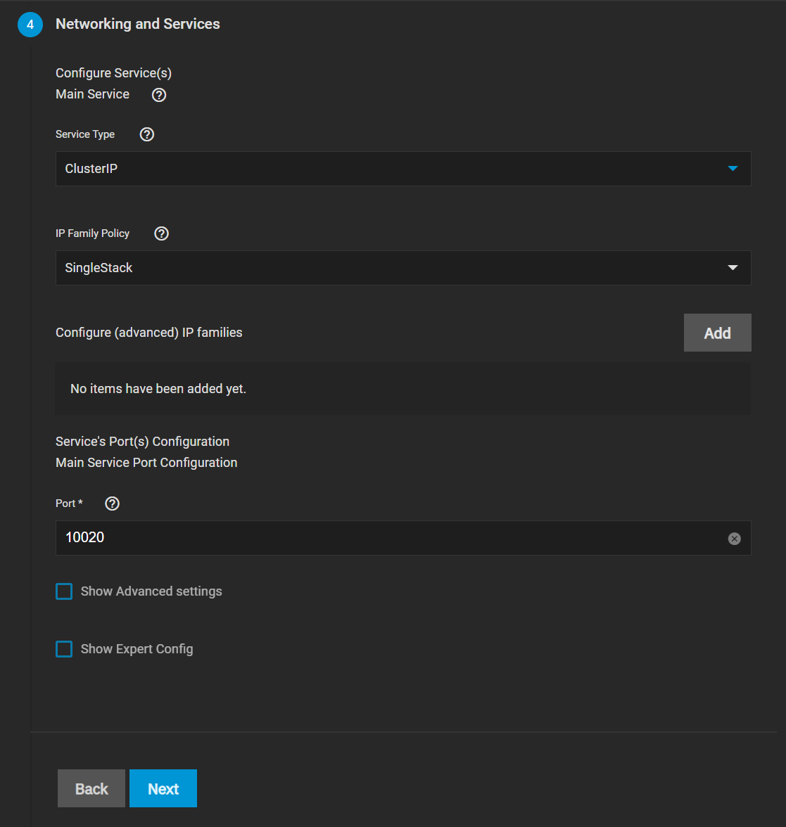

Start the installation process and, at Networking and Services, choose ClusterIP for your service. Since we're using Traefik, no need to create an LoadBalancer or a NodePort (Simple is a type of LoadBalancer).

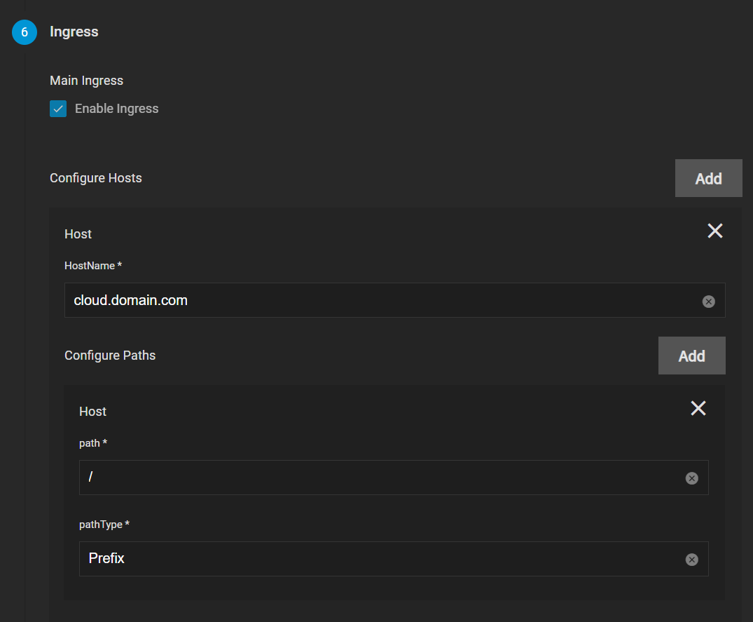

Next, at the Ingress section, configure it like this while replacing the hostname with yours:

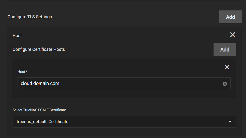

In the TLS section, again, configure it like below while:
  • replacing the hostname with yours
  • selecting the proper certificate chain from the dropdown
