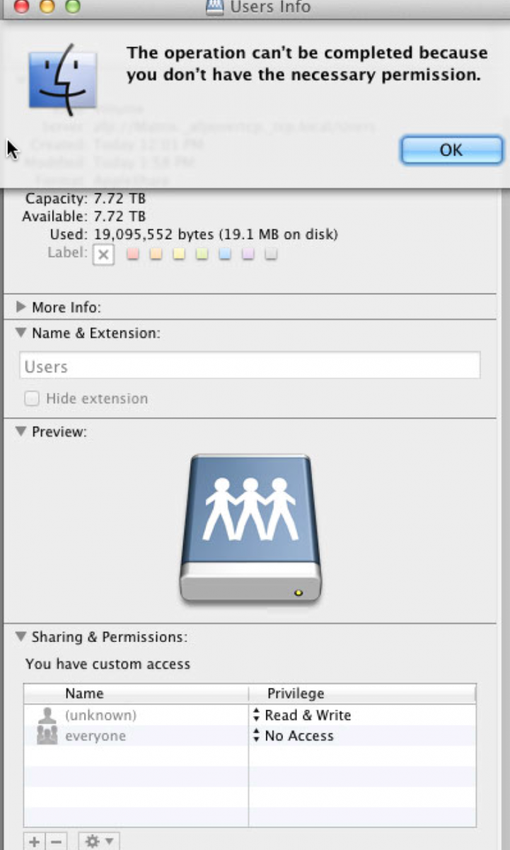

Hi, not to join in on your thread but I am a bit lost too. I am trying to do something kind of similar but no. I am trying to have my Mac network users home folders stored on FreeNAS. I got the freeNAS setup I can log into It from the server and read and write files. The problem I run into is getting the system (server) permissions correct to be able to read write from the share. I can manually copy the home folder to the share but what good is that if the LDAP server does not have permissions to read and write. I had a similar problem with an external HDD I plugged into the server and all I had to do was allow everyone the permissions to read and write or add a group and or user.
Break down on what I am trying to achieve:
-Have my already running LDAP server authenticate user logins
-Have their home folders stored on the NAS
I am not going to remake users on the FreeNAS server that is pointless.
I know I can make this work I just do not know how and every time I try and change permissions on the share from the server it says I do not have permission.... :( Is there a way to run a command in the shell to allow access to everyone to read and write on the share, because right now it says no access.
And yes I have checked every box on the FreeNAS side in terms of permissions for the user I logged in with to connect to the share. As well as changed permissions for the dataset, share, mount point etc,..
Thank You for your time

Glorious1
Nov 23, 2014
1,211
??? from what server
Your post is kind of confusing. I don't know why you would copy a home folder to the FreeNAS server (it should be created when you create a user), but if you can, you can write to the server. But you say you can't.
You say you "changed permissions for the dataset, share, mount point, etc." You should not change permissions for the mount point or root dataset. When you look at the Storage > Volumes page of the WebUI, you will see at least one volume listed. In my example below, that is Ark. Below that is an indented line of the same name. That is the root dataset, created automatically. Leave both of those alone. If you don't have too much in it, you might be better off destroying your pool and starting over. Create datasets within the root dataset and set permissions for them.
You show an image of permissions in the Finder. Apparently the AFP implementation in FreeNAS does not allow one to modify permissions from the Finder. I have not found this to be a problem, but others might.
Note that you set up basic permissions when you create the dataset. That determines access to the dataset. Then, when you create or edit a share for the dataset, you can set default permissions for files and directories (click the Advanced Mode button). If the owner has full permissions in both of those controls, and you access the share as the owner, there shouldn't be a problem.
If there is, either using the Console or via SSH, navigate to the directory you're having trouble with and do a long list ( ls -l) and examine the ownership and permissions. You can change them with chown and chmod, but it might be easier to do it recursively in the webGUI, Storage > Volumes > Change Permissions.
If you need more help, please post detailed information and images of ownership and permissions on a particular dataset, share, directory and file, including the output of ls -l. Also exactly how you are trying to access the share.
strikeing_789d
Apr 7, 2017
13
Hi, Thank you for your reply. So just to be clear I will go over again what I am trying to accomplish.
Current Setup (Working)
- I have a running Mac Server with Open Directory Services Authenticating network users for login
- That currently running Open directory server has the Users home folders (storage) stored on a external hard drive connected directly to the server (yes I know its slow)
~To get this working all I did was open the workgroup manager on the Mac server and tell it where to make home folders. At first I had some permissions issues so I literally right clicked on my external hard drive and gave my network user group permission to access it, as well as creating a share of that external hard drive in the file sharing section of the server.
Future Setup (Not working)
-I recently bought another server and installed freeNAS on it.
-Created a volume and then a dataset within that volume and shared that dataset over afp for the Mac server
-I can see the NAS when I click on the "network" section in finder, so I just click "connect as" and I log in as the user I created directly on the NAS which trust me has full fledged rights and ownership to everything
-I can copy files directly to the NAS read files etc etc. no problem, but when I try to go into workgroup manager and point it to make home folders there (the NAS share) it gives me an error "unable to create home directory"
-I have typed in the home url and full path to the share in different formats and paths with no luck.
To sum it up I want to keep my existing open directory server running on the Mac and simply point the network users storage to the new NAS server. I know its not impossible its just a permissions thing but I have checked every box opened every permission for every dataset and volume and the workgroup manager will not create home folders there.
Am I typing in the share URL/path wrong in the workgroup manager ?
Is there a command to just allow everyone to read and write on the share ?
Yes I understand that you can make users and run directory services on the NAS, but I shouldn't have to do that. I just want my network users storage (home folders) stored on the NAS and able to be accessed when they are logged in. Why is this so difficult ?
Thanks.
P.S my setup of volumes and datasets in exactly like yours in the screen shot minus the names and the second data set.
Glorious1
Nov 23, 2014
1,211
I don't have any experience with running a Mac server or workgroup manager as you described. Maybe someone with such experience will respond. But if you can fully access FreeNAS from your client computer but not your Mac server, I would say the problem is with the Mac server or how you're using it, not with FreeNAS setup.
I don't know what you mean by "clicking on the "network" section of the Finder". Do you mean from the menu bar, Go > Connect to Server? Try to be more explicit about what you're doing and it is more likely someone can help. Give actual paths. For example, when I click on Go > Connect to Server, one of the shares I can choose there is "afp://Tabernacle.local/Ark.Media". Tabernacle is my FreeNAS server's name, and Ark.Media is the name I gave to one of the shares.
I suggest you also try Apple's forums. And when you say, "Am I typing in the share URL/path wrong in the workgroup manager ?", I think no one could answer that unless you state exactly what you have typed in.
Finally, as I stated before, since you said you changed the permissions on the root dataset/mount point, I suggest you destroy the pool and start over, leaving them at the defaults.
