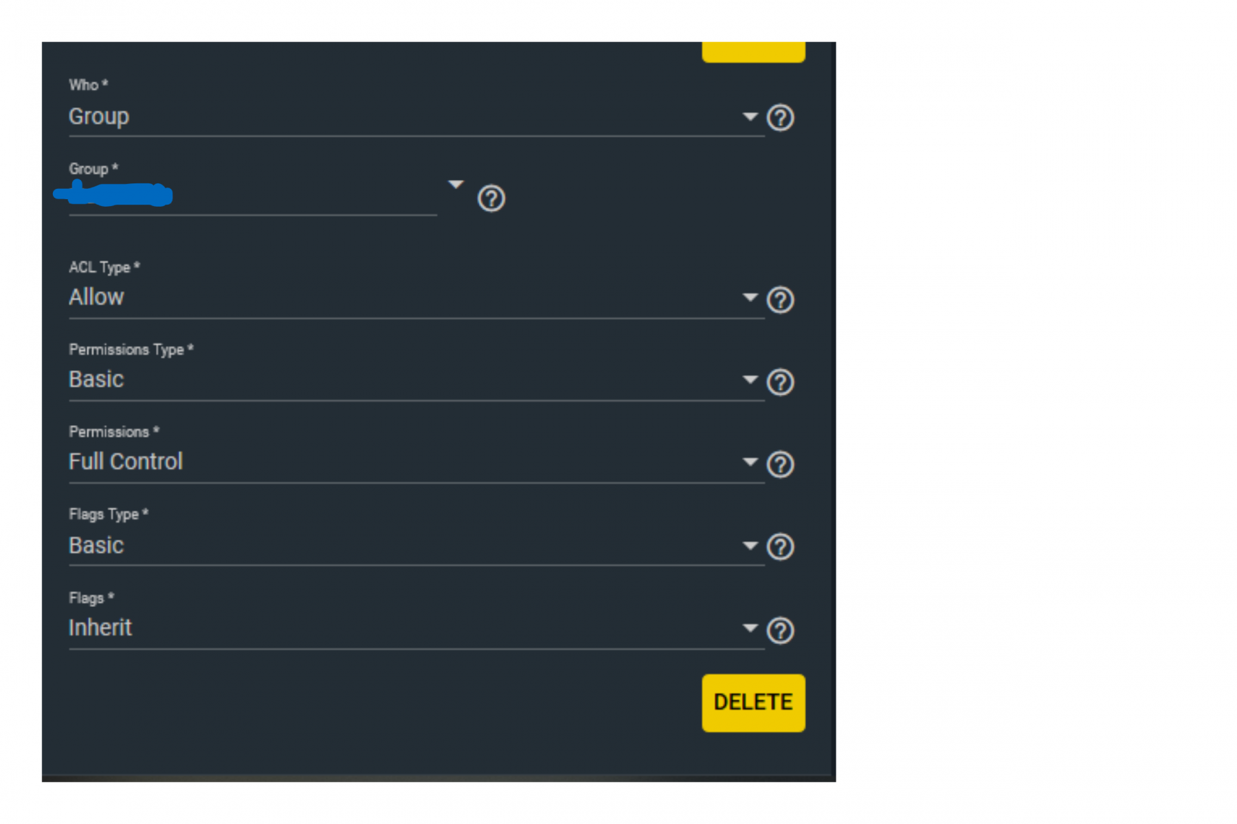

Thank you Samuel for this however it did not work.
Storage / Pool / Edit ACL
I added the group that we are both apart of with Full Control and then tried also adding the user with Full control over the share that didn't work. Even tried resetting all the permissions on the files to the group we are both apart of and that still didn't working.
Am I doing something wrong -> Well clearly I'm doing something wrong :) Can you point me into another directions - > I'll keep screwing with these settings here to see what i can dig up.

Remember you also need to set the Unix permissions side, with the folder belonging to that group, with read/write access.

Thanks again here my set up ->
I have two groups.
Group A - > Can only be accessed by User A
Group B -> Can be accessed by User A and B
Both users have Read + Write permissions
Now on the the pool itself (ACL editor)
I added an ACL so that user B has full permission
ACL Type :
Allow
Permission Type:
Advanced
Permissions:
Everything except write acl and write owner
Flag Type:
Basic
Flags:
Inherit
I also tried this with the changing the groups@ but I'm getting the same result.
Also my dataset is set up where anything that is created both users have access to the data unless specified.
User A -> Creates new file User B has access to it
Unless I change it to Group A user B can not access to it.
I don't have issue with Read just writing for some reason.
Please let me know what other information you'd need to point me into the right direction.
