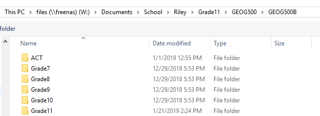

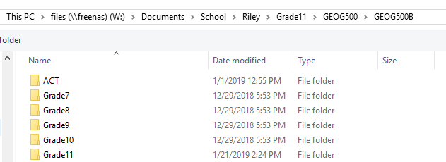

This issue has appeared a few times for me recently. I will navigate to a folder where I store my files for school and find that the parent directory is listed rather than the actual contents. I can browse through the folders but they are read only:
The contents of the GEOG500B folder should be week 20, week 21, etc. but it instead shows the "Riley" folder (that's me!), which is its parent farther up the list. I have been able to solve this issue with restarts but it is very annoying. The odd thing is this only ever happens for subfolders stored within the "school" folder. Any idea why this is happening?
Edit: I waited a few minutes and the issue went away, but I still wonder why it happened in the first place.
