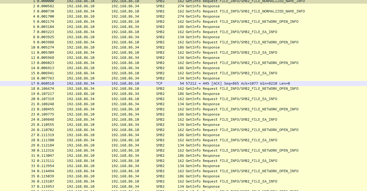

I could make it run for hours with Wireshark and not getting any error in live, bu I can see that when everything works fine it looks like what you can see in the file "work.zip"
and when it doesn't work anymore because the file isn't accessible anymore you get what you can see in "nowork.zip"
If I look the samba logs, no entry since 1 day...

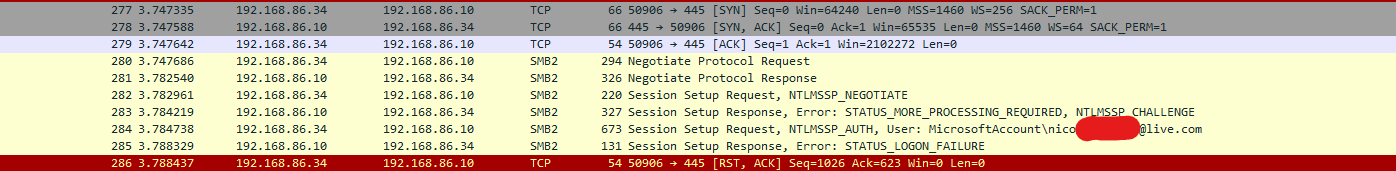

I have seen my old FreeNAS credentials in my windows account, I deleted them restarted the PC and got this
I reenter my credentials to access my TrueNAS and now it seems to work, might need some days to be sure it's reliable

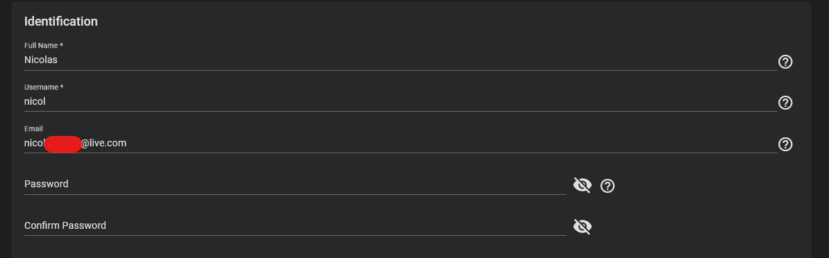

but considering I put exactly my microsoft account credentials, shouldn't TrueNAS accept them without any login request? username, email and password are exactly what I set in my Windows10
To be honest I still feel unsure how to set it up exactly, maybe because I never have seen working as expected :)

The "microsoft account" feature in the GUI uses the "username map" parameter. I've seen occasional erratic behavior with these maps and auth (never been able to reliably reproduce on demand). It's generally better not to use this feature if you can avoid it. If you can file a bug ticket (jira.ixsystems.com) about erratic behavior of "Microsoft" accounts, I'll see if I can rework things inside samba so that we better handle the MicrosoftAccount domain and maybe get rid of that checkbox entirely.

from what I see it was a problem related to the microsoft account
I consider it as solved
