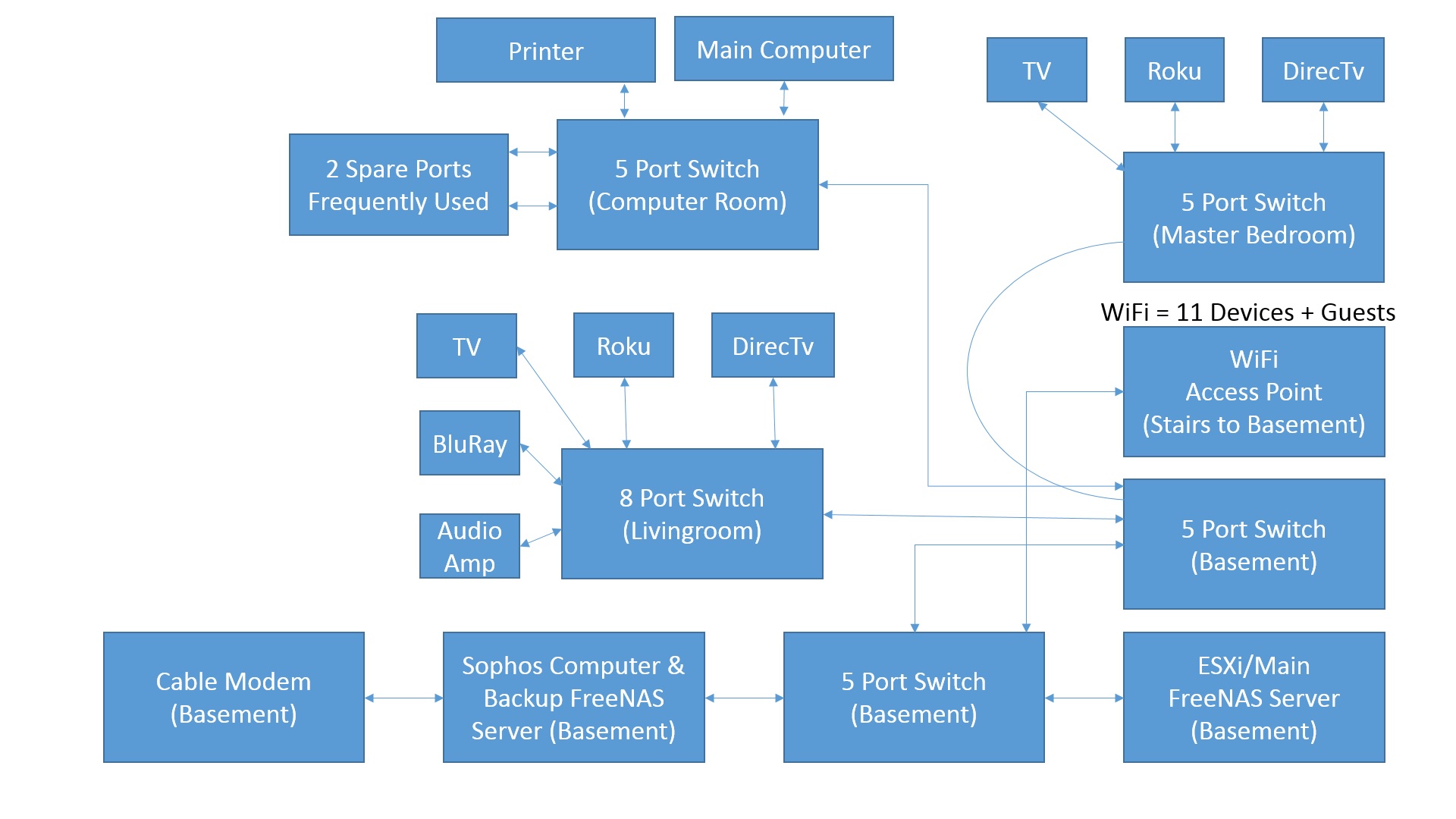

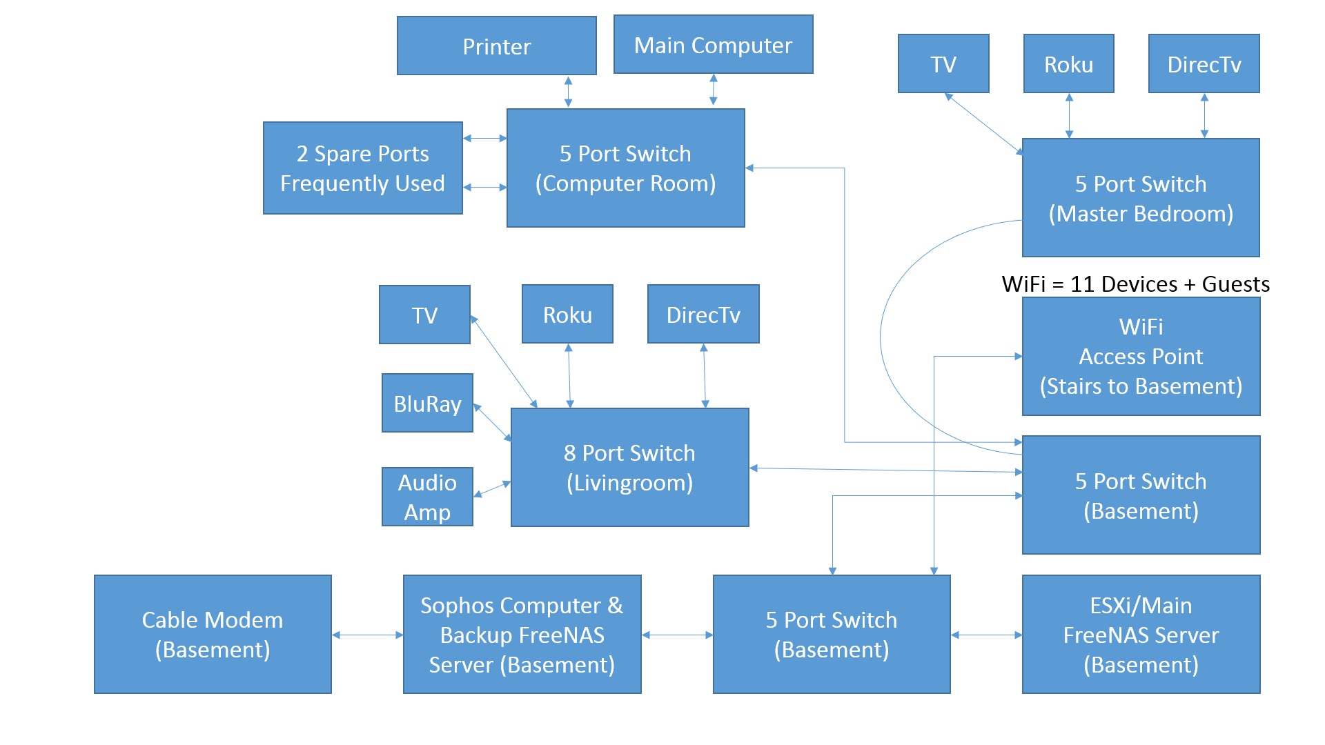

4) Be cleared in what is happening and explain your network layout. For example I'm attaching my network layout as an example for you.
