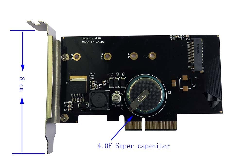

I bought an adapter card to plug my NVMe driver into a PCI-e slot (adapter image is attached). This board has a super capacitor, capable of keeping the driver on for seconds in case of power failure. Enough time to write any outstanding data.
It works as a UPS directly connected to the NVMe driver. In theory, it works as a Power Loss Protection (PLP) added to a consumer NVMe driver. So I would like to use a consumer NVMe to accelerate writes with fsync type calls.

Is there any way to configure the NVMe OS-driver so that it replaces or not sends fsync-type calls from applications to the physical nvme driver? It would be interesting to be able to perform this configuration indicating the driver that we know is protected with the super capacitor.
This was done on very old hardware that didn't properly represent its PLP capability, like circa 2000's Sun flash cards. Those cards had a high level of QA/QC, their own internal firmware was capable of understanding when a power loss event occurred, and could then flush their cache internally. A modern "consumer" drive has none of that, and I'd be extremely hesitant to throw a random "supercapacitor on a card" into my machine unless I was wanting to see how much Magic Blue Smoke I could generate.
We know that only enterprise drivers are able to be fast in these scripts, because only they have supercapacitors inside them. Therefore, they are prepared to ignore fsync calls, keeping the data in cache memory. But they are too expensive, out of my budget. So I'm looking for a cheaper alternative.
Buy an Optane M10 16/32GB card. It's likely to provide similar endurance to a consumer SSD as well as blow its doors off for SLOG workloads - the 16GB unit is good for about 1Gbps of sync-writes in small records, 32GB is good for 2Gbps. See the link in my signature for an example of SLOG benchmarks.
Even if SSD firmware were typically open-source (it literally never is) and it were not a complete spaghetti mess (I'd bet it is a mess) and you could setup the development toolchain and you could upload the new firmware to your drive and you could debug this when it inevitably became necessary and you targeted a specific model or small range of drives, this would still be a bad idea unless you were looking to start a business selling these. It would still be a terrible business model, but it would begin to make sense from a time investment perspective.
