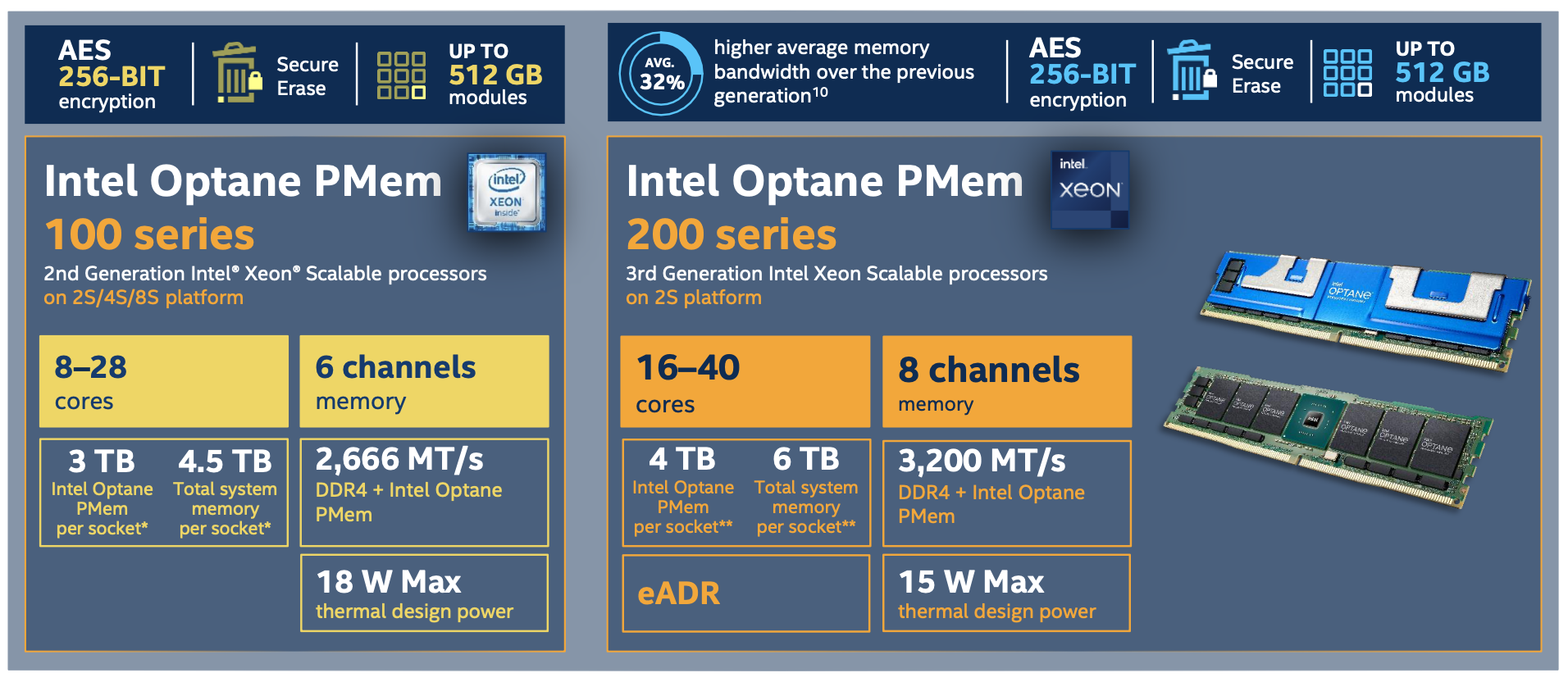

TrumanHW
Member
Apr 17, 2018
111
Optane Persistent Memory 100 vs 200 performance & compatibility
Compatibility requires very expensive CPU
(I'd hoped they'd work with E5-2600)
Optane Persistent DIMM 100 Optane Persistent DIMM 200
Maximum DIMM Speed / Performance 2,666 MT/s 3,200 MT/s
SP CPU Generation REQUIRED Xeon Scalable Processors (2nd Gen.) Xeon Scalable Processors (3rd Gen.)
CPU Compatibility
Xeon Platinum 8280L
Xeon Platinum 8280
Xeon Platinum 8276L
Xeon Platinum 8276
Xeon Platinum 8270
Xeon Platinum 8268
Xeon Platinum 8260Y
Xeon Platinum 8260L
Xeon Platinum 8260
Xeon Platinum 8256
Xeon Platinum 8253
Xeon Gold 6262V
Xeon Gold 6258R
Xeon Gold 6256
Xeon Gold 6254
Xeon Gold 6252N
Xeon Gold 6252
Xeon Gold 6250L
Xeon Gold 6250
Xeon Gold 6248R
Xeon Gold 6248
Xeon Gold 6246R
Xeon Gold 6246
Xeon Gold 6244
Xeon Gold 6242R
Xeon Gold 6242
Xeon Gold 6240Y
Xeon Gold 6240R
Xeon Gold 6240L
Xeon Gold 6240
Xeon Gold 6238T
Xeon Gold 6238R
Xeon Gold 6238L
Xeon Gold 6238
Xeon Gold 6234
Xeon Gold 6230T
Xeon Gold 6230R
Xeon Gold 6230N
Xeon Gold 6230
Xeon Gold 6226R
Xeon Gold 6226
Xeon Gold 6222V
Xeon Gold 6212U
Xeon Gold 6210U
Xeon Gold 6209U
Xeon Gold 6208U
Xeon Gold 5222
Xeon Gold 5220T
Xeon Gold 5220S
Xeon Gold 5220R
Xeon Gold 5220
Xeon Gold 5218T
Xeon Gold 5218R
Xeon Gold 5218N
Xeon Gold 5218B
Xeon Gold 5218
Xeon Gold 5217
Xeon Gold 5215L
Xeon Gold 5215
Xeon Silver 4215R
Xeon Silver 4215
4 and 8 Socket SP
Platinum 8380HL
Platinum 8380H
Platinum 8376HL
Platinum 8376H
Platinum 8360HL
Platinum 8360H
Platinum 8356H
Platinum 8354H
Platinum 8353H
Gold 6348H
Gold 6330H
Gold 6328HL
Gold 6328H
Gold 5320H
Gold 5318H
Highest Per-Core SP
Platinum 8380
Platinum 8368
Platinum 8362
Platinum 8360Y
Platinum 8358
Gold 6348
Gold 6342
Gold 6354
Gold 6346
Gold 6334
Gold 6326
Gold 5317
Gold 5315Y
Scalable Processors
Platinum 8352Y
Gold 6338
Gold 6336Y
Gold 6330
Gold 5320
Gold 5318Y
Silver 4314
Max SGX Enclave
Platinum 8380
Platinum 8368Q
Platinum 8368
Platinum 8352S
Gold 5318S
Cloud Optimized for VM
Platinum 8358P
Platinum 8352V
Liquid Cooled
Platinum 8368Q
Network / NFV Optimized
Platinum 8351N
Gold 6338N
Gold 6330N
Gold 5318N
Mobile Media Optimized
Platinum 8352M
Long-Life & NEBS-Thermal Friendly
Gold 6338T
Gold 5320T
Single-Socket Optimized
Platinum 8351N
Gold 6314U
