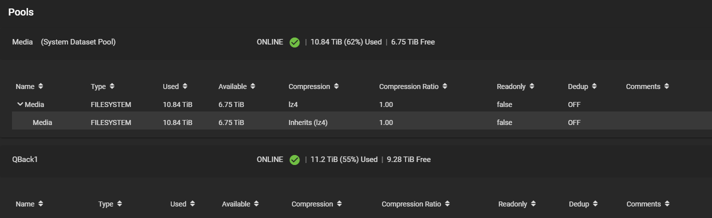

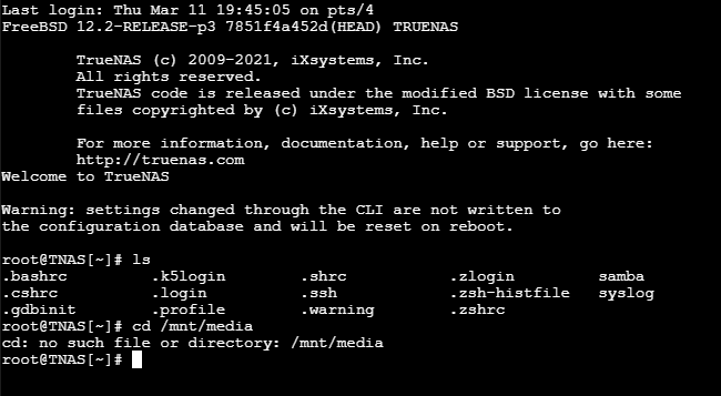

Glen62
Mar 9, 2021
6
So I've just been directed to this thread in the hopes that it will solve my problem accessing Truenas SMB shares via OpenVPN tunnel on iPhone. I've gone through the first steps above as per Invar's post (adding in the tuneables) and did a restart just for the fun of it, and then opened a shell from my main computer into the Truenas system. As soon as I try to change directory I get hit with a "no file or directory found" error. The pool is there as it is one of three that are fully searchable via any of my systems on the network. I am new to this Linux type OS so maybe I'm missing something totally obvious, but not sure what.
I've tacked on a snip of my pools and of my root directory if anyone can offer any idea(s). Thanks.

invar
Jan 23, 2021
36
Case sensitive maybe? Media is not the same as media.
cd /mnt
ls
Glen62
Mar 9, 2021
6
You nailed it. I did not know that I had to be case sensitive, although I should have known.
Thanks.
