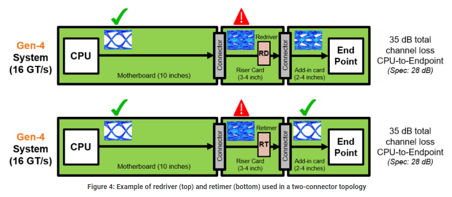

You may be able to issue a zpool clear to remove the DEGRADED status of the drives, but I would recommend a scrub afterwards to ensure data integrity.
If you are experiencing PCIe signaling issues, you may need a card with an active redriver or retimer.
https://www.asteralabs.com/smart-re...imers-vs-redrivers-an-eye-popping-difference/

I dont understand what is redriver and retimer. Is a component?
The linked article explains it in more detail, but basically think of them as "amplifiers" that will take in the PCIe signal and re-transmit them. If your board, riser card, and cables result in a configuration that is "too long" for the PCIe signal to reach on its own, you may need to use a PCIe riser/breakout card that has a redriver or retimer in there.
