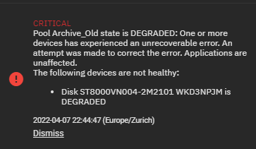

My Pool consisting of a 8tb drive is degraded, the UI is giving me this error code:
"Pool Archive_Old state is DEGRADED: One or more devices has experienced an unrecoverable error. An attempt was made to correct the error. Applications are unaffected.
The following devices are not healthy:
  • Disk ST8000VN004-2M2101 WKD3NPJM is DEGRADED"

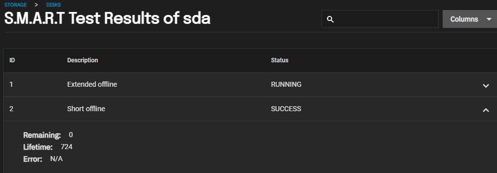

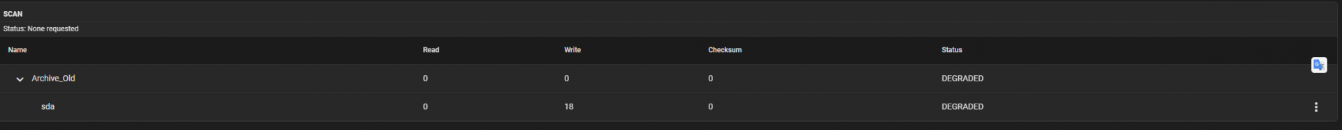

On Friday, when this error first showed up, I had 18 write errors, now after running a smart test, the disk doesn't show any errors, is however still degraded.
What is my best course of action here?
I'm very new to true NAS and incredible inexperienced.
Do I just replace the drive? It is well within warranty, or is it fine?
Some screenshots are attached, if they are of any help.

We don't yet see sufficient information to decide if the disk is really bad (although it doesn't look hopeful at this point).
run smartctl -a /dev/sda (and see if the extended offline/long test is complete)... re-run it after a few hours if not (or watch the status in the disk SMART details in the GUI).

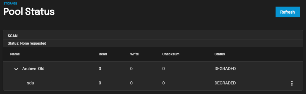

Sorry I misspoke, it's a raid0 array (stripe) as I'm migrating data from one server to my new one, I don't have the spare HDD's in my pool yet.
    NAME                                    STATE     READ WRITE CKSUM
    Archive_Old                             DEGRADED     0     0     0
      a04423d1-540e-4ec9-a0f0-f0d2c7743a1a  DEGRADED     0     0     0  too many errors
the zpool status reads:

You realise (you must) that you have absolutely no resiliancy in any of your pools?
No chksum errors, but Archive_Old - and its single disk is suspect.
The drive is a bit warm
Have you run zpool clear? (to be clear - please don't)
