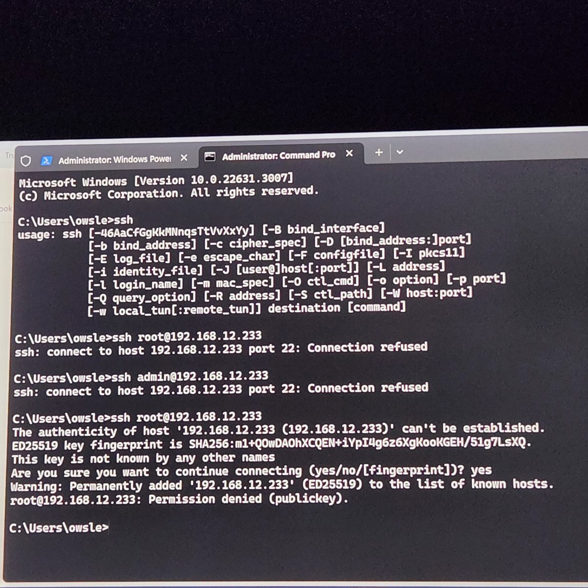

If you're getting the "Connection refused" error, you haven't enabled the SSH service on your NAS.
Ok I figured out how to enable SSH on the NAS. So I tried it again and now I'm getting this.
owsleygarcia95
Jan 13, 2024
32
That's the one.
@owsleygarcia95 you'll find it under Services -> SSH.
Ok thanks. Well I've managed to create a dataset, add an additional user and set up a windows smb. Started a file transfer that I promptly ended when it was only getting about 73MB/s. Hoping that the Mellanox 10gb NICs on the way will work (I returned some intel ones because they didn't have a windows 11 driver, I kind of got it to work but read good things about Mellanox).
I'm pretty sure I just forgot to add admin under password login groups last time. Going to see if it finally works lol.

...or root login with password?
So I finally got logged in under admin, but when I try to login under root, it says permissions denied and prompts me for a password again. I know I only made one password, so I'm not sure why admin works and root doesn't. I gave permissions to both of them.
Can I just use admin? What is the actual difference between root and admin?
owsleygarcia95
Jan 13, 2024
32
After some quick googling I think I have to add a password for the root account, since it makes admin the default user. Is this right?
owsleygarcia95
Jan 13, 2024
32
Well I finally managed to gain access through ssh under root. I just had to add a password to the root account (which it recommends against doing). Not to concerned about screwing things up as this is all just a test currently. I think I've managed to figure out everything I plan on using this for except a couple of apps and my vpn, neither of which I have attempted yet. Thank you guys very much for being so patient with me. I was doing my best to search for the answers to my questions first, but its difficult when you barely understand half the stuff you're reading lol. Hopefully I can figure the rest out with youtube videos and google. It's going to be awesome to have almost 100 TiB soon.

This is from powershell and should also work in the regular comand prompt shell in windows. You can also use putty to establish the ssh connection which many do. Enter the connection all on one line. It is easy to do.
In the Truenas server you will need to Setup and enable ssh (services >> ssh) and setup a user that is allowed to use ssh. I used the default admin user in this case. Credentials >> User >> edit >> check the box for SSH password login enabled save edits
On the windows machine open a command prompt shell and at the windows comand prompt you will enter: ssh username@server-ip-address like in the example below:
PS C:\Users\burt> ssh admin@192.168.0.149
This will establish the connection to Truenas ssh with the user name entered
Enter the Truenas ssh users password as requested. Type it in, it will not show progress and cursor will not move so just know you are entering it and hit return
If the user authenticates the screen will the first time usually gripe about the authenticity of the connection and ask to accept the key
Type yes and after windows records and validates the key you will be logged in to the Truenas ssh session.

As a note:
On current versions of the Truenas systems, the user root is disabled by default and you have to use admin as the user or create another user and set their privileges and enable ssh for them. The ssh works fine as the admin user but some commands may possibly still need sudo in front of them and the admin password entered again to run the command. I think Truenas is still buggy in this area since the change from root to admin as the default user.
You will get something like the following if root is tried for a user for ssh for current systems.
PS C:\Users\burt> ssh root@192.168.0.149
root@192.168.0.149: Permission denied (publickey).
