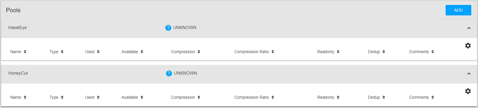

no such pool available, but the pools are listed and so are the disks.

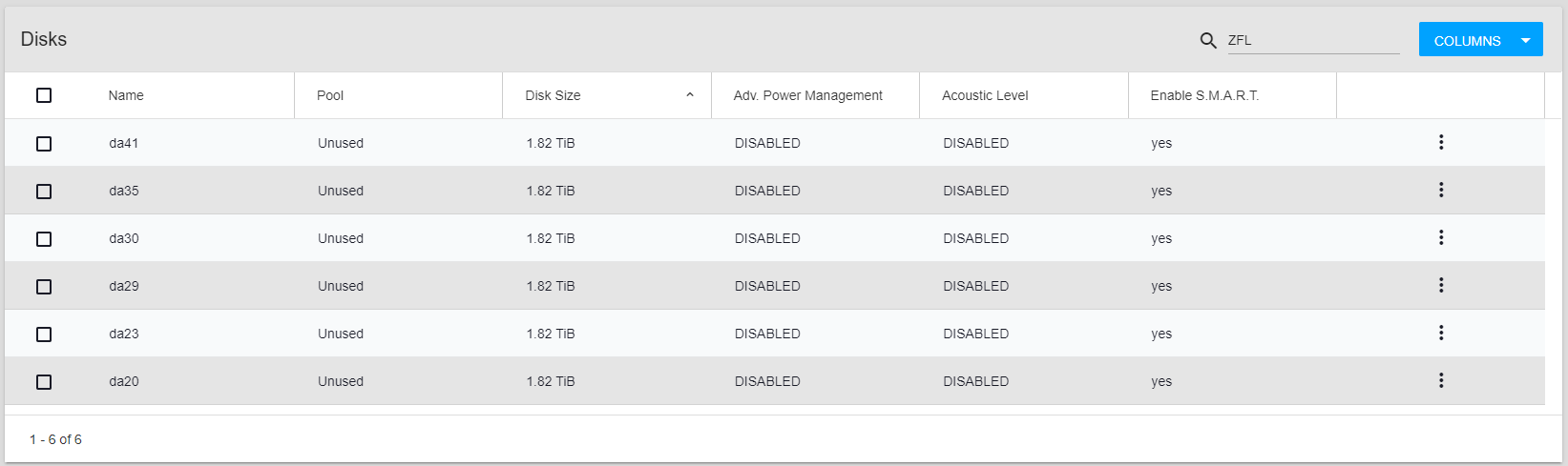

I know this has been gone over several times but i can't seem to find a solution or an instance that's really the same as mine, also i can't seem to get any less general errors so i can actually troubleshoot it.
I had to physically relocate my server as well as my DS4243 (running as JBOD). after relocating i put all the disks back in i believe in the exact order they were removed and for whatever reason while my freenas shows the pools, it says they're in an unknown status and offline. but all of the disks are there. i have two pools but only one that i actually care about.
Server info:
HP DL360 Gen7
32gb memory
2x Intel(R) Xeon(R) CPU E5649 @ 2.53GHz
LSI Logic / Symbios Logic LSI2008
The VM has 8gb ram.
FreeNAS is ran as a VM on ESXI6.5 with the LSI2008 ran in passthrough mode on the vm; i've been using it in this configuration for several years and has been great until now.
At first I thought the disks were maybe put back in the DS4234 in the wrong order but i verified they should be correct and read later that freenas doesn't even care and uses some identifier to determine which disk belongs where. i'm getting the following output:
root@freenas[~]# zpool import
root@freenas[~]#

I ended up finding what you were referring to, and found the -c switch which allows for using the cache file that i already had, although it's claiming that the drives aren't working? or something. i unplugged a couple drives just to see if they went away and they do on the disks menu so i dont understand what's going on here.
root@freenas[/data/zfs]# zpool import -c zpool.cache

I also verified the disks are actually communicating and ran smartctl on them. i don't know what else i can do to show that they're active but just not being used for some reason.
