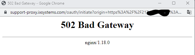

Hi ,

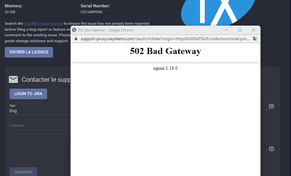

I'd like to send a bug report from TN13 console and when I use the login button to jira i get a 502 bad gateway nginx . on several TN13 have tried ,I get the same result so it seems to me, the problem is not on my server's side.
What can I do to retrieve feature working properly?

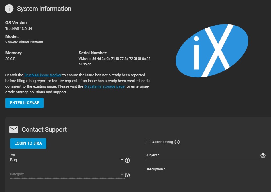

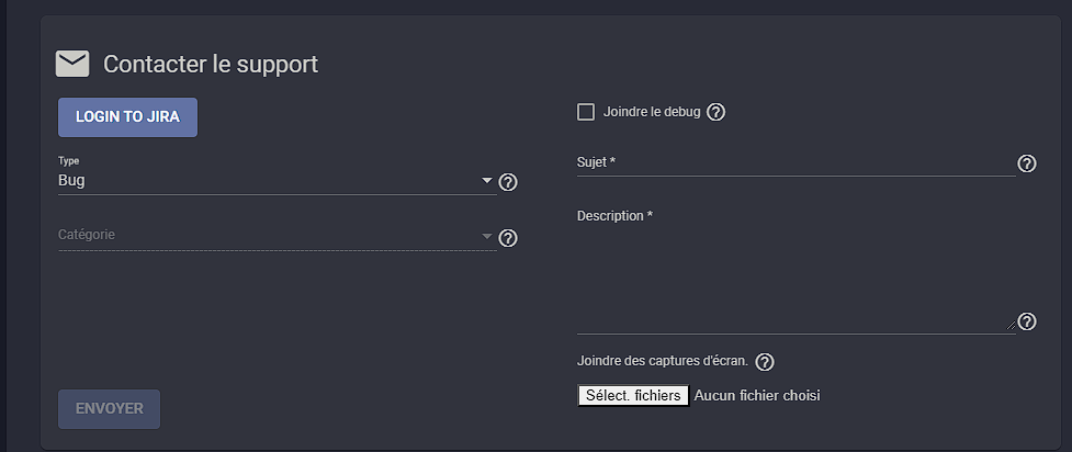

I don't understand where I should find the link you mention,
in console/system/support I have that.
clicking on "LOGIN TO JIRA" button I get all the time a windows with

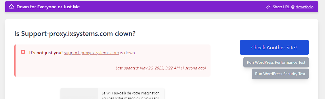

I found this : It seems ix server is down

Well I tryed to dig some more,
  1. changing browser --> KO
  2. changing PC on same LAN --> KO
  3. Changing Browser on 2nd PC -->KO
  4. Connecting from another LAN coming from a 4G router ---> OK
So it seems something is blocked from my native LAN , but for now no idea what.
My ISP is a french provider "FREE" with fiber connection, and my LAN is simple and with no QOS nor VPN or advanced security rules.
If you have any idea what could be the thing to check , i'm a gratefully listener

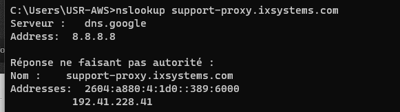

You can try to ping the URL ixsystems.atlassian.net and it should at least locate the IP address of: 104.192.142.xx (I got both .18 and .20 at different times). If the DNS can't find the IP then you know it's the DNS.
If it's the DNS, you could change to 8.8.8.8 as your DNS, that should work. I'm not a networking guru at all but those are all the ideas I have right now. Best of luck to you.

Well I did some progress in diagnostic, finally if I use my PC connected to another LAN becoming from a 4G router , then it works and I'm able to get Jira .
For me now, it's oubviously a problem coming from my ISP, I opened a support to my ISP (Free) to get this fixed from my fiber internet access.
Hope in few days in the next week i will have some explainations and fix.
I already use 8.8.8.8 as DNS resolver, and I did change this value to see but with no better luck.

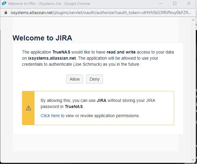

You MUST create an account on the website before you can use TrueNAS to report a bug. The URL I provided is for that website. It's also the same link as "Report a Bug" at the top of the forum pages. Have you created an account? Or is this the URL you cannot reach?
I do not mean to treat you like you know nothing, I can clearly see that you have been a member for a long time. But I always treat people as if they know nothing because if I assume someone knows what I'm talking about, it could lead to disaster. Not of course in this case but you know what I mean. So I hope you do not take any offence to it.
Once you have created an account on the website, then you can open up the support page, click on LOGIN TO JIRA, see screen shot below, and then authenticate your account (see screen shot below) and your TrueNAS will be logged in.

Yes thanks I have one account already existing and functional and yes, it's ok to reach support page from the link you pasted or the one existing on forum menus. My problem is only from console in TN13 the login button is not working for me but like I said it seems related to my isp as if i switch my pc to a 4G router then if works like a charm.
I get 502 bad gateway each time I click on
but for sure this is ISP problem.

Well my ISP said it was not in their hands; they confirm it's ok for them and they asked me to try with a VPN connection.
I did try and , ......it works from VPN so this let me think this is my public IP which is filtered or blacklisted somewhere on IXservers.
Are you same feeling as me ?
If so who can help me to retrieve access from my Public IP which is static?

To recap:
1) You can access the "Report a Bug" link at the top of this page and log into a JIRA account without any issue. (https://ixsystems.atlassian.net/jira/software/c/projects/NAS/issues)
2) You cannot login to the JIRA account using TrueNAS Support page in the GUI, UNLESS you are using a VPN. (support-proxy.ixsystems.com/...)
Does that sound correct?
What I'm perplexed about is your web browser works fine without a VPN. I guess the proxy server could be rejecting it but that topic is way beyond my knowledge level.
