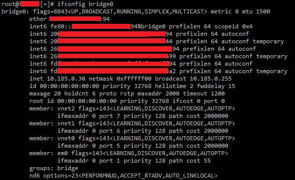

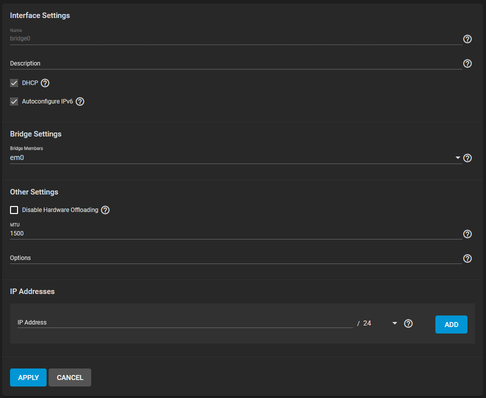

No, all IP configuration is on the bridge interface.
Screenshots of interface configuration in web UI:
ifconfig output for all interfaces:

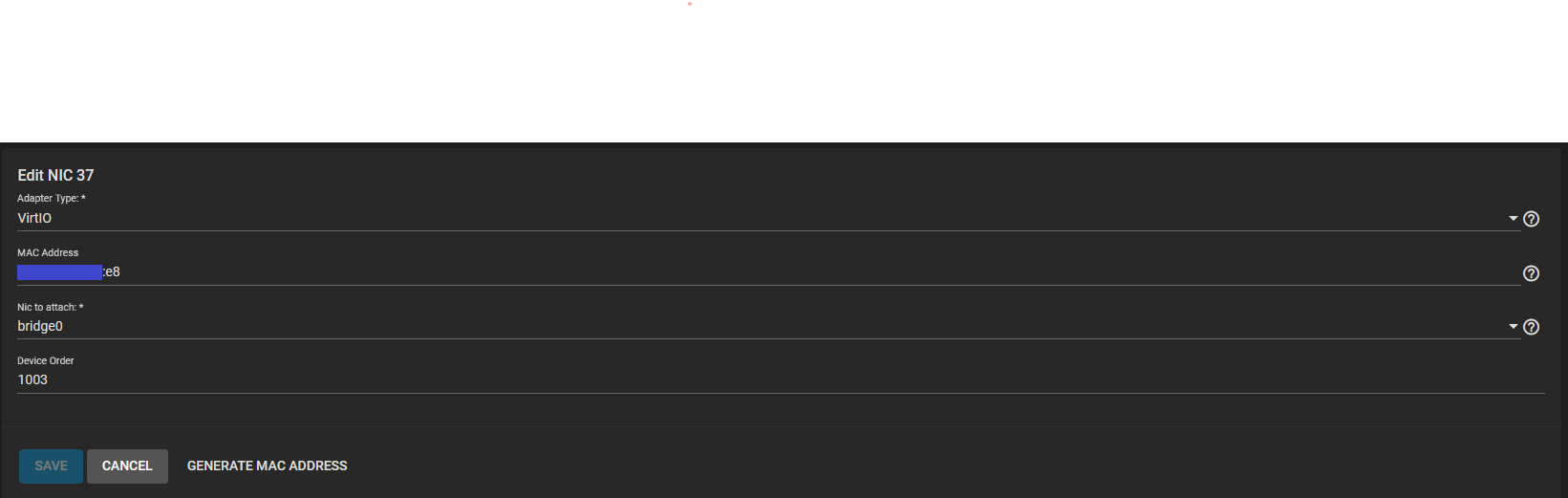

VM's NIC are configured to use the bridge (example for one of two):

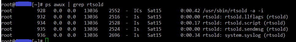

Is rtsold running? ps awux | grep rtsold.
If it isn't, try adding a tunable, type RC, name rtsold_enable, value YES.

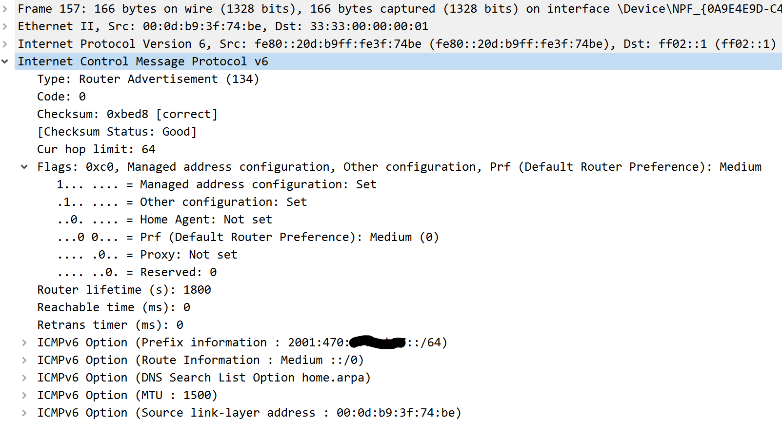

That is really weird. Could it be a problem with my router's RA's? Would you mind running
tcpdump -i bridge0 -v -n "icmp6[0] == 134"
on your TrueNAS machine (replacing with your interface name) to see if the default route information contained is the same as mine?
(addresses partially censored)
# tcpdump -i bridge0 -v -n "icmp6[0] == 134"
tcpdump: listening on bridge0, link-type EN10MB (Ethernet), capture size 262144 bytes
11:32:50.667553 IP6 (flowlabel 0x554ee, hlim 255, next-header ICMPv6 (58) payload length: 176) fe80::xxxx:xxxx:xxxx:f0c0 > ff02::1: [icmp6 sum ok] ICMP6, router advertisement, length 176
        hop limit 64, Flags [managed, other stateful], pref medium, router lifetime 1800s, reachable time 0ms, retrans timer 0ms
          source link-address option (1), length 8 (1): xx:xx:xx:xx:f0:c0
          mtu option (5), length 8 (1):  1480
          prefix info option (3), length 32 (4): 20xx:xxxx:xxxx::/64, Flags [onlink, auto], valid time infinity, pref. time infinity
          prefix info option (3), length 32 (4): fdxx:xxxx:xxxx::/64, Flags [onlink, auto], valid time infinity, pref. time infinity
          route info option (24), length 24 (3):  20xx:xxxx:xxxx::/48, pref=medium, lifetime=1800s

I'm seeing the same behaviour. Here's some info if it helps.
TrueNAS Core version TrueNAS-13.0-U4 on a Pentium Silver J5040 cpu (64-bit) with a single NIC. Network is a single switch behind a pfSense router/firewall, which supports both SLAAC and DHCPv6, and the pfSense "router advertisement" is set to "assisted".
My symptoms look the same as others in this thread: the TrueNAS system gets an IPv6 address with SLAAC but doesn't pick up the default route. A FreeBSD 13.1 virtual machine works just fine and gets a default route as expected, so it doesn't appear to be an issue in the base OS. Windows, Linux and Android systems all use IPv6 fine as well.
If I manually discover the router with "ping6 ff02::2%re0" and add the returned address as a default route, IPv6 works fine (public addresses partly redacted):

This is what my router advertisments look like in wireshark. You can see that it's advertising a default route:

rtsold seems to be running:
rsh@store:~$ ps awux | grep rtsold
root       17144   0.0  0.0   13036   2776  -  ICs  16:21      0:00.01 /usr/sbin/rtsold -a -i
root       17148   0.0  0.0   13036   2740  -  Is   16:21      0:00.00 rtsold: rtsold.llflags (rtsold)
root       17149   0.0  0.0   13036   2736  -  Is   16:21      0:00.00 rtsold: rtsold.script (rtsold)
root       17151   0.0  0.0   13036   2732  -  Is   16:21      0:00.00 rtsold: rtsold.sendmsg (rtsold)
root       17152   0.0  0.0   13036   2740  -  Is   16:21      0:00.01 rtsold: system.syslog (rtsold)
rsh        18649   0.0  0.0   12924   2724  0  S+   17:46      0:00.00 grep rtsold
