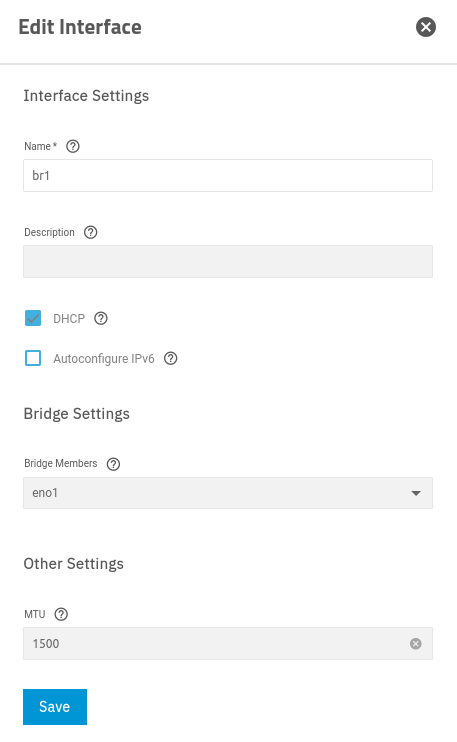

Recently I encoutered a problem, my trueNAS scale 23.10.1.1 has no default ipv6 route (ipv4 is normal), so it can't be accessed via ipv6, and it can't ping any IPv6 in WAN. This machine has 1 NIC (eno1), and built a bridge named br1 with eno1 as its member.
I installed a new trueNAS in the same local network with same config, no ipv6 default route problem.
Further more, when I stop my qbittorrent app (Added external Interfaces br1) and reboot, the ipv6 default route comes back, and last forever. When I start qbittorrent app, it dessappears in 5 minutes.

because I have to use ipv6 in qbittorrent, so I can't delete br1.
I don't know wether it is a bug or is my misconfigure, thanks for your help.
