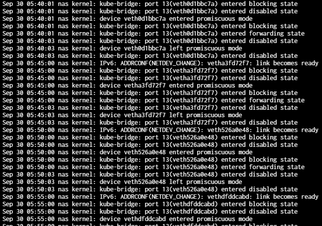

I use TrueNAS-SCALE-22.02.0.1 and I have the following problem. About every 5 Minutes, in my log I see the following output:
Apr 4 15:40:01 truenas kernel: IPv6: ADDRCONF(NETDEV_CHANGE): veth64ce1564: link becomes ready Apr 4 15:40:01 truenas kernel: kube-bridge: port 15(veth64ce1564) entered blocking state Apr 4 15:40:01 truenas kernel: kube-bridge: port 15(veth64ce1564) entered disabled state Apr 4 15:40:01 truenas kernel: device veth64ce1564 entered promiscuous mode Apr 4 15:40:01 truenas kernel: kube-bridge: port 15(veth64ce1564) entered blocking state Apr 4 15:40:01 truenas kernel: kube-bridge: port 15(veth64ce1564) entered forwarding state Apr 4 15:40:03 truenas kernel: kube-bridge: port 15(veth64ce1564) entered disabled state Apr 4 15:40:03 truenas kernel: device veth64ce1564 left promiscuous mode Apr 4 15:40:03 truenas kernel: kube-bridge: port 15(veth64ce1564) entered disabled state
I have 4 Truecharts Apps in my TrueNAS and even if I stop all Apps or restart my system, I get those state switches. I don't use IPv6 and my switch don't assign IPv6-Addesses to any of my clients. I have this behaviour a few weeks and unfortunately I can't narrow the time or action down to the Beginning of these log entires. My System runs well and since SCALE 22.02-RC2.
Has anyone an idea how to solve this?

iX Seems to been working actively on solving some of those issues in either 22.12 or 22.02.3 :)

This was caused by my Nextcloud App from Truecharts. I could solved this problem, when I installed the Nextcloud App from the Official Catalog, transfered all my Nextcloud data and than delete the Nexcloud App from the Truecharts Catalog.

The reason you and @Grummeltier was where having these issues, was because we previously (by accident) had a kubernetes service that was not attached correctly to a running process. Sadly enough no-one reported this bug on our bugtracker.
However:
Our completely reworked Nextcloud App (15.x.x) released last week, completely fixed this issue, as well as a bunch of other bugs and performance improvements.
@waqarahmed You might want to take note of the above:
Besides these warnings showing up when an App is disabled, they also show when Apps contain a kubernetes service that is not backed by an open port.

I have been suffering from this same issue. Only way i found around this, was to 'Reset configuration to defaults' and re-import the pool. All configration lost, but at least the system is back online.

Unless people file tickets with our support staff with a complete list of all the Apps they are using, there is not much we can do with this (even though we're referenced quite frequently here).
As we can only guess which app is causing this.
In a TLDR:
The cause is often a kubernets service that is not correctly connecting to an application port.
However: This should still not spam your logs like this, that issue lies with iX and should be reported accordingly.

I have a bunch of these messages too:
Dec 24 04:30:02 storeman kernel: device veth35f9286d entered promiscuous mode
Dec 24 04:30:02 storeman kernel: kube-bridge: port 9(veth35f9286d) entered blocking state
Dec 24 04:30:02 storeman kernel: kube-bridge: port 9(veth35f9286d) entered forwarding state
Dec 24 04:30:02 storeman kernel: kube-bridge: port 10(veth7ccd706e) entered blocking state
Dec 24 04:30:02 storeman kernel: kube-bridge: port 10(veth7ccd706e) entered disabled state
Dec 24 04:30:02 storeman kernel: device veth7ccd706e entered promiscuous mode
Dec 24 04:30:02 storeman kernel: kube-bridge: port 10(veth7ccd706e) entered forwarding state
Dec 24 04:30:03 storeman kernel: kube-bridge: port 6(veth5b6dba9e) entered disabled state
Dec 24 04:30:03 storeman kernel: device veth5b6dba9e left promiscuous mode
Dec 24 04:30:07 storeman kernel: IPv6: ADDRCONF(NETDEV_CHANGE): veth5331885d: link becomes ready
Dec 24 04:30:07 storeman kernel: kube-bridge: port 6(veth5331885d) entered blocking state
Dec 24 04:30:07 storeman kernel: kube-bridge: port 6(veth5331885d) entered disabled state
Dec 24 04:30:07 storeman kernel: device veth5331885d entered promiscuous mode
Dec 24 04:30:07 storeman kernel: kube-bridge: port 6(veth5331885d) entered forwarding state
Dec 24 04:30:12 storeman kernel: kube-bridge: port 6(veth5331885d) entered disabled state
Dec 24 04:30:12 storeman kernel: device veth5331885d left promiscuous mode
Dec 24 04:30:14 storeman kernel: IPv6: ADDRCONF(NETDEV_CHANGE): veth068c4a11: link becomes ready
Dec 24 04:30:14 storeman kernel: kube-bridge: port 6(veth068c4a11) entered blocking state
Dec 24 04:30:14 storeman kernel: kube-bridge: port 6(veth068c4a11) entered disabled state
Dec 24 04:30:14 storeman kernel: device veth068c4a11 entered promiscuous mode
Dec 24 04:30:14 storeman kernel: kube-bridge: port 6(veth068c4a11) entered forwarding state
Dec 24 04:40:04 storeman kernel: IPv6: ADDRCONF(NETDEV_CHANGE): veth46ed7ab7: link becomes ready
Dec 24 04:40:04 storeman kernel: kube-bridge: port 11(veth46ed7ab7) entered blocking state
Dec 24 04:40:04 storeman kernel: kube-bridge: port 11(veth46ed7ab7) entered disabled state
Dec 24 04:40:04 storeman kernel: device veth46ed7ab7 entered promiscuous mode
Dec 24 04:40:04 storeman kernel: kube-bridge: port 11(veth46ed7ab7) entered forwarding state
My apps:
  • Tailscale
  • Plex
  • Jellyfin
  • Resilio-Sync
All of them are up-to-date, so one of them is probably having the failure to connect issue.

I have the same issue. Additionally, after a few days of log spam, the network goes down (disabled state) and doesn't come back unless I restart the machine.

Same issue here. Strange thing is I'm seeing multiple devices as though there is more than one interface, unless I'm misunderstanding it.
No nextcloud here, although it was installed at one point but I took it off as it never worked.
