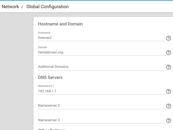

Well, the DNS settings that you glossed over would be a good place to start:

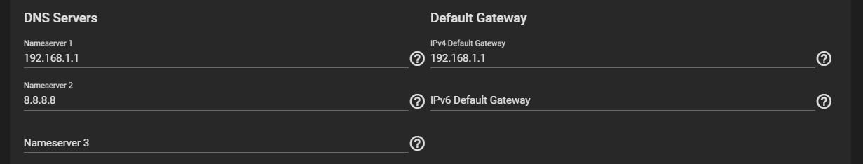

I also found the posts suggesting to make sure I had DNS set in Network > Global Configuration (which I did not have set - apparently 11.3 didn't care about DNS). So, I set those to various things, rebooting the server, and trying the plugin upgrade all with the same result. I also cannot ping www.google.com from the shell. Currently I have Nameserver 1 set to my router ip, but I've tried 8.8.8.8 and also the DNS ips that are configured in my router.

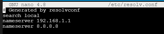

Take a look on the CLI at /etc/resolv.conf and make sure that your nameservers are in the configuration (they should be).
You can also try using the host command on the CLI: host www.google.com 8.8.8.8 (and 192.168.1.1) which will force the lookup to use 8.8.8.8 (or 192.168.1.1).

pinging 192.168.1.1 works, but pinging 8.8.8.8 does not (no route to host message). My resolv.conf looks ok to me I think:
I can ping 8.8.8.8 from my laptop so I think my router itself is ok. I'll admit that I'm not a network guru so I'm a bit out of my league here.

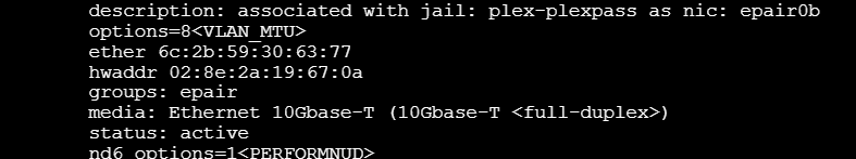

What also seems a little weird is this - I have 4 jails. I am not using DHCP for any of them. Instead, I have configured an IP for each of them (outside of the DHCP IP range set in the Netgear R6900 router). You can see what is what in this picture:
I thought the freenas server itself was 192.168.1.26 (although now I'm getting confused).

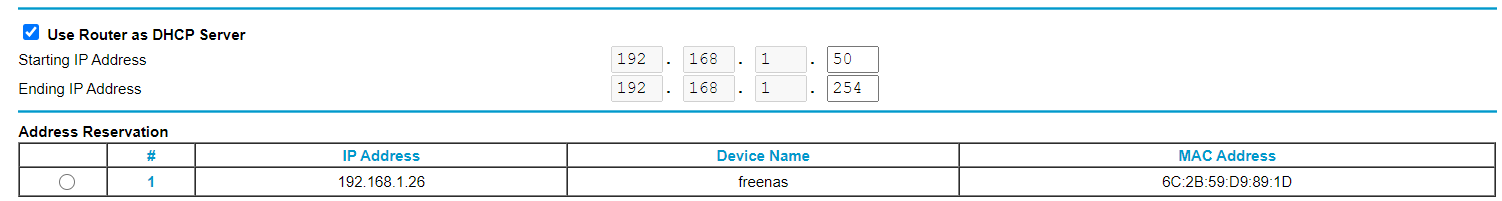

In my router configs, I have reserved 192.168.1.26
However, when I look at the attached devices in my router it shows an entry for that same reserved MAC address but with the IP address of the tomcat plugin (aside - I have no idea why it says RackMac or where that came from. I tried to edit it and it won't change).
It's also interesting that I see an entry for IP address 192.168.1.36 (which is the plex plugin) but the MAC address doesn't match up to the plex plugin when I do ipconfig from the shell in freenas (it shows a MAC of 6c:2b:59:30:63:77)
So I'm not sure what the heck is going on. Unfortunately I didn't look at my router settings before the upgrade to TrueNAS 12 so I don't know if it was always looking like this or not.

You might consider getting the MAC addresses for the FreeNAS TrueNAS box and the MACs for each of your jails. Then delete any of the static DHCP reservations and then re-adding them to your router. It could be your router's DHCP list is "confused".

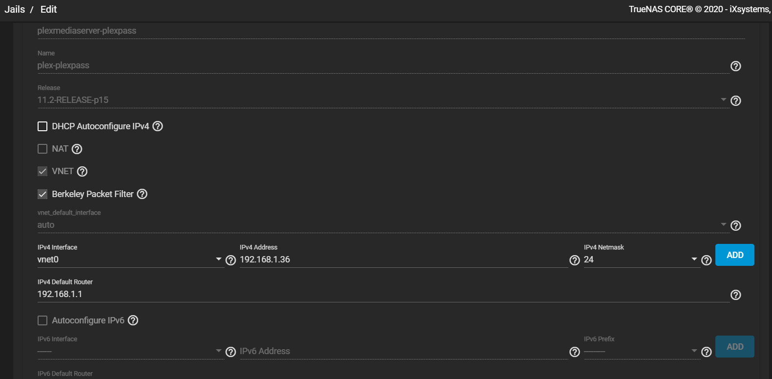

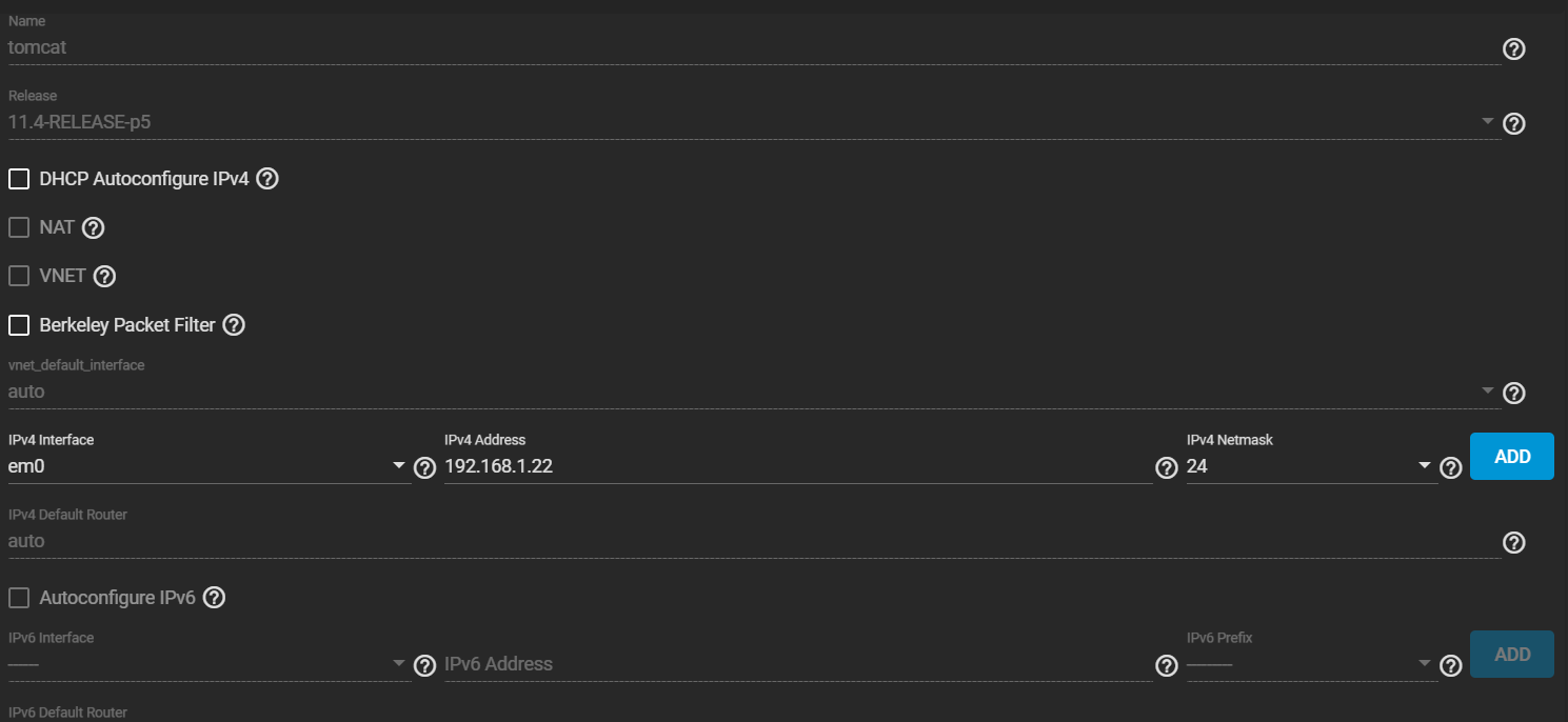

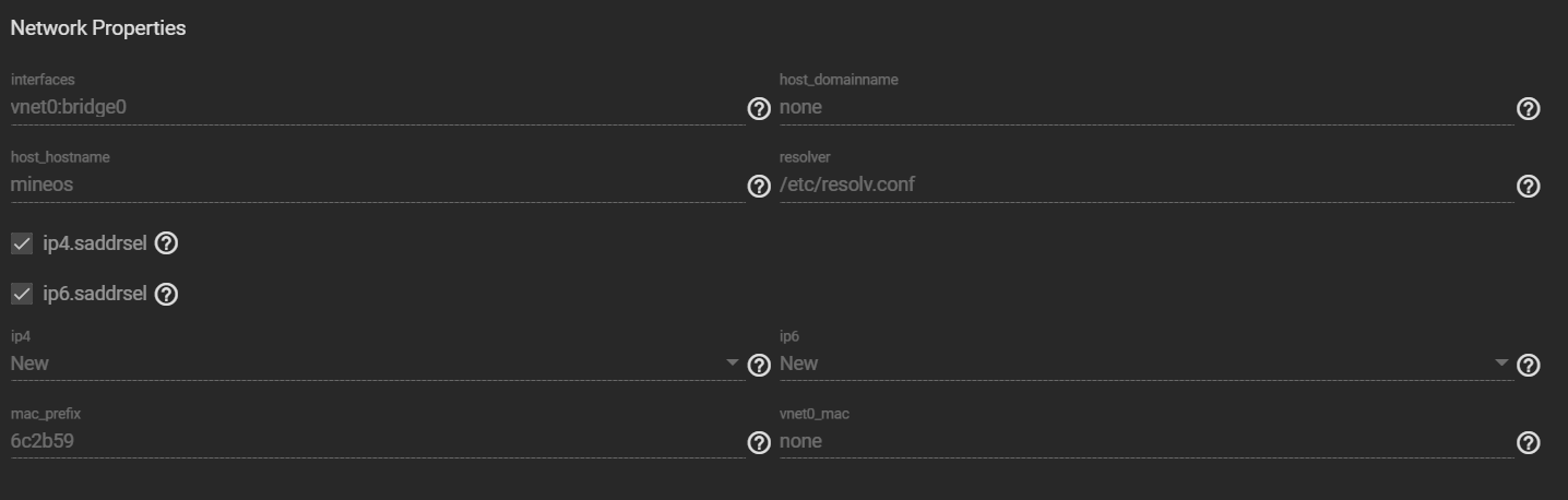

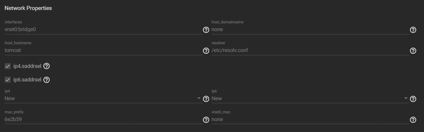

Plex jail:

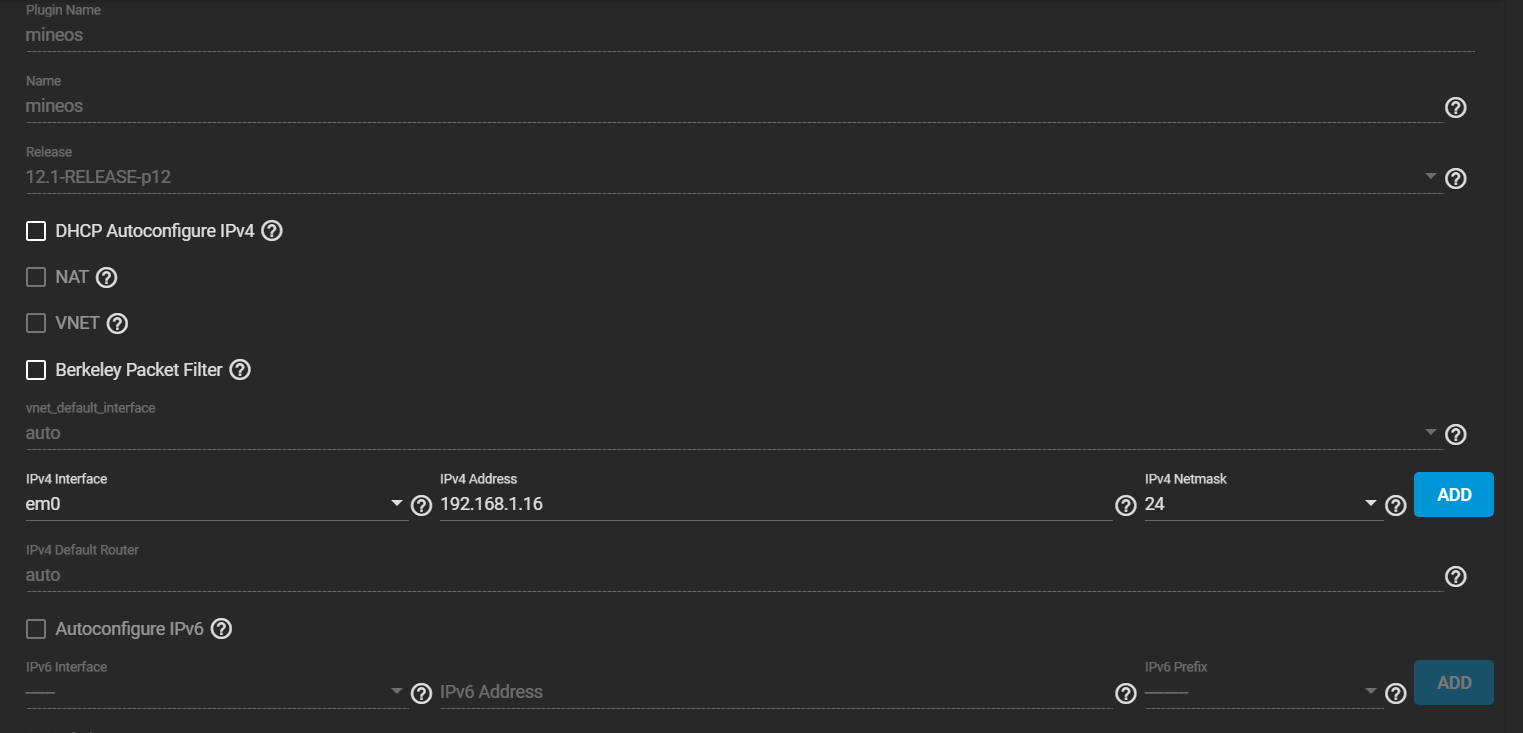

MineOS Jail (this one says it's on version 12 but it failed during the upgrade due to no network and is not actually working)

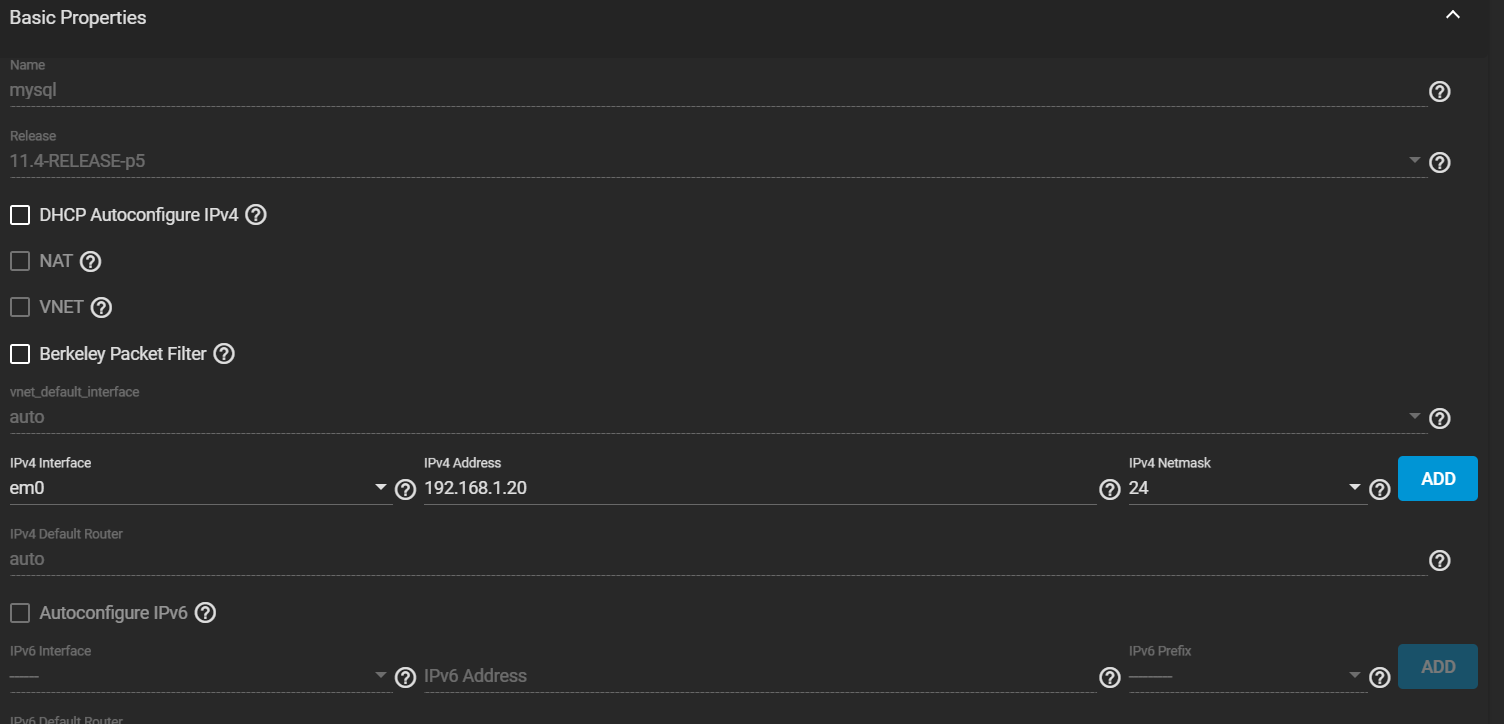

MySQL jail:
Tomcat Jail:

For the MineOS, MySQL and Tomcat jails set the Berkeley Packet Filer and VNET to on.

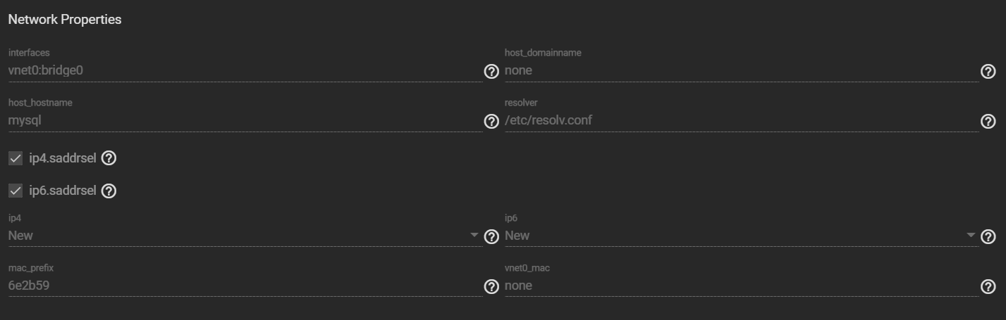

Ok, so I tried with just the Mysql jail. I made sure it was running and I could connect to the database using Mysql Administrator from another machine. All good. Then I stopped the jail, checked vnet and bpf and set the default router as below:
It saves but then when I try to start it it says "Error No Default Interface Found." Maybe related to that vnet_default_interface field, but it's greyed out so I can't change anything. I also tried leaving the Default Router to "Auto" but same result. Also, even though I get the error, it does say the jail is running, even though Mysql is not reachable from another machine.
