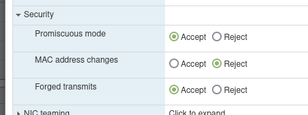

Since somebody else testing TN Scale in a virtualized environment will probably run into the same issues, after spending way too much time on this I found that the problem is that TN Scale's bridged networking apparently triggers VMware ESXi's default network security settings.
The connected vSwitch must be set to allow forged transmits for bridged networks to be able to communicate externally:
vSphere docs: https://docs.vmware.com/en/VMware-v...UID-7DC6486F-5400-44DF-8A62-6273798A2F80.html
This might be a useful hint to add to the TN scale docs.

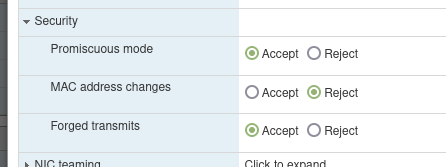

Brian
Huge thank you for this!!!
For me the forged transmits was already enables, but promiscuous mode was not.
Once I enabled it the bridge started to work.
