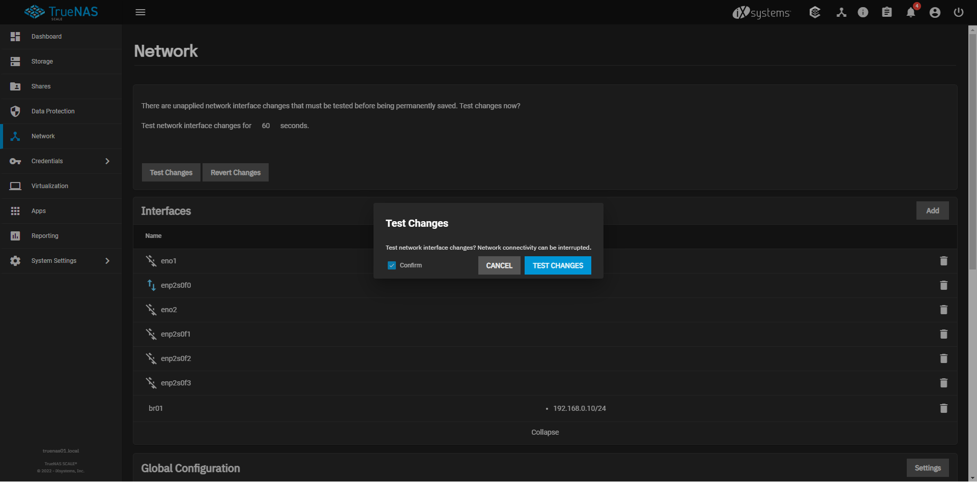

This is the exact solution that solved my problem. All within the UI/browser. No reboot or command line needed.
During Test Changes, reload the UI in another tab using the same IP, to Save Config before Revert.
After clicking Test Changes, the UI will have the modal appear that it's testing the changes with the spinner and the other text box that appears (Connecting to TrueNAS?). During that time, I opened another tab to access the UI and it brought me right back into the config with the Save Configuration option present.
Remove the IP from my primary NIC -> Apply
Create a bridge
Assign the primary NIC as only member to that bridge
Assign the IP formerly attached to the NIC to the bridge
Apply
Test Network Changes
Reload TrueNAS UI using the same IP address in another tab
Save Config
Once saved, you'll see br0 with the correct IP attached. I then bound the bridge to the VM, started it, and can now access the NAS network shares from within the VM.

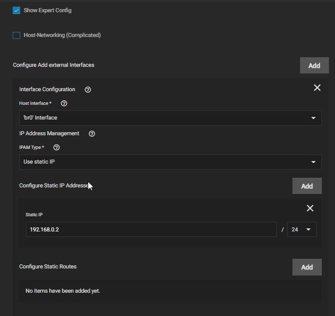

Also after that you need to chceck your Apps configuiration if you set Host IP for an App and also change Interface to brX. Like for example Unifi below in my configuration:

This worked for me but too just to make it more clear.
  1. Remove the IP from my primary NIC -> Apply
  2. Create a bridge
    1. Assign the primary NIC as only member to that bridge
    2. Assign the IP formerly attached to the NIC to the bridge
    3. Apply
  3. Test Network Changes
    1. I have 2 nic on 2 different networks so I didn't have to wait 40 seconds 88.0/24 internal uses 89.0/24 external use

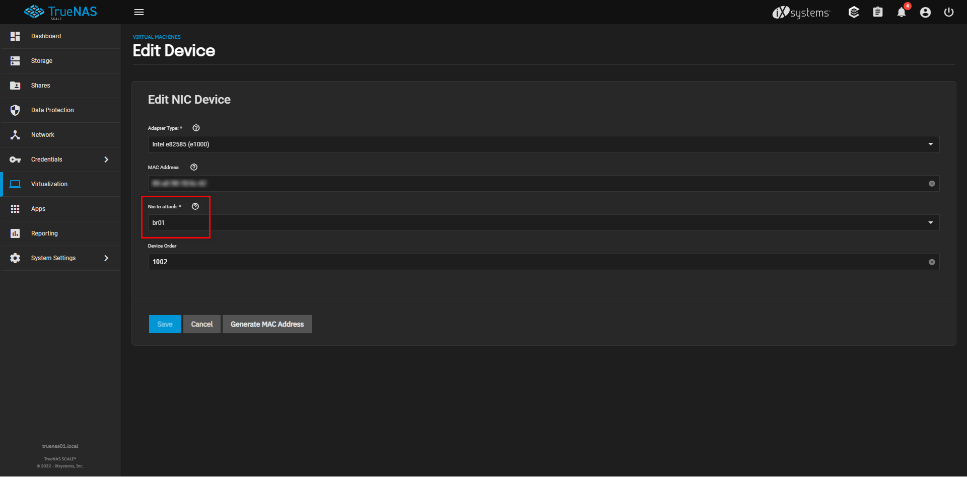

  4. Click on Virtualization
    1. Select VM
      1. Device
      2. Nic
      3. Bind to Br#
I am updated to the latest Scale "Release" that just came out on 2/22/22. This does not work. It takes longer then 60 seconds and reverts back to original network settings. Hope this gets fixed in the later releases.

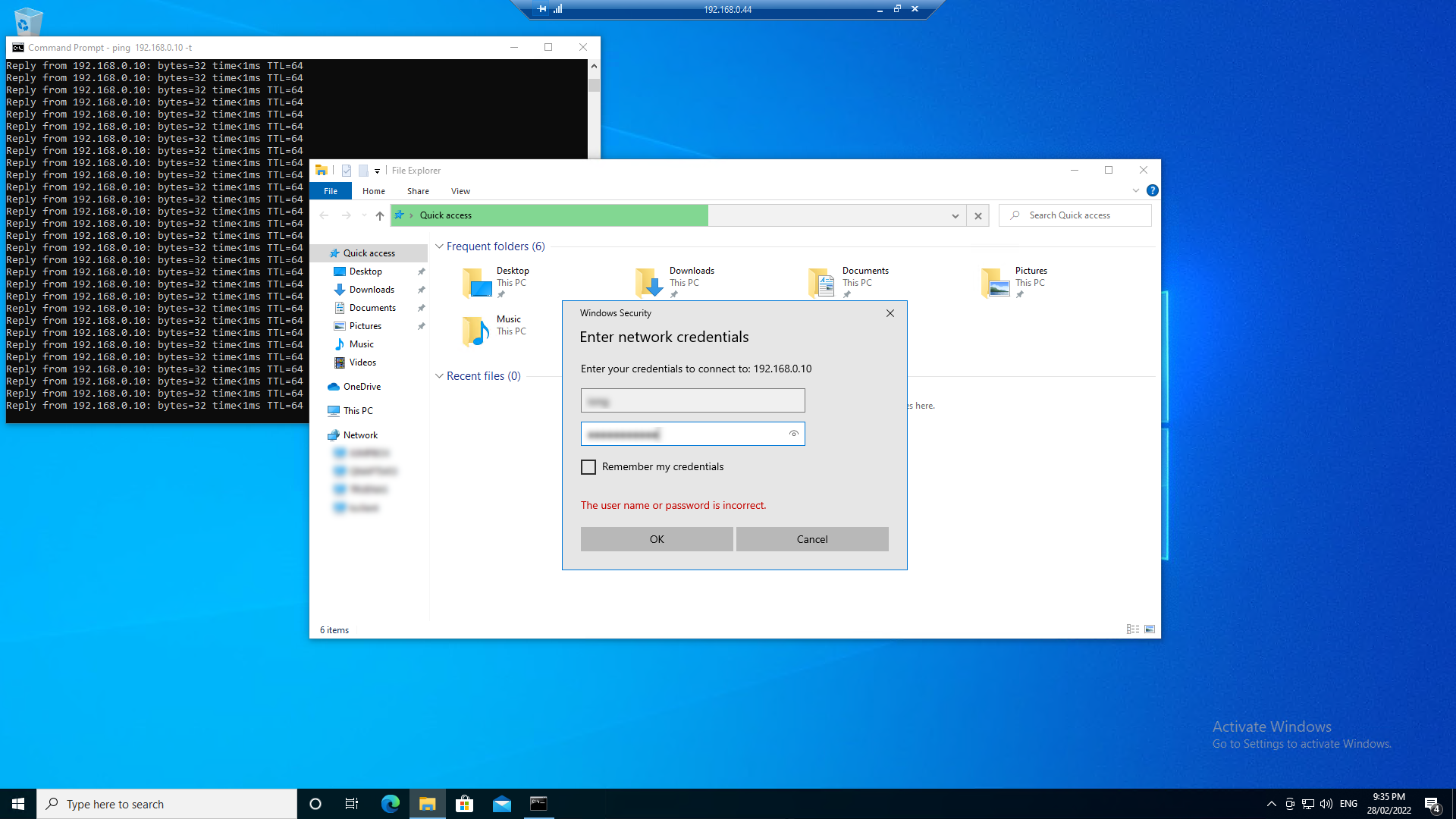

I think this is what you guys are after and this is how I did mine...
Note:
1. Follow the sequence. Failing to do so you'll run into interfaces advising you that the IP is being used.
2. Do not test / apply changes till Step #3.

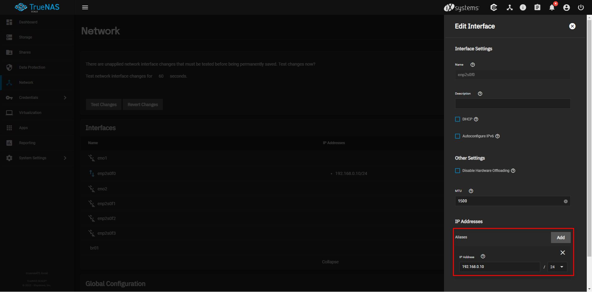

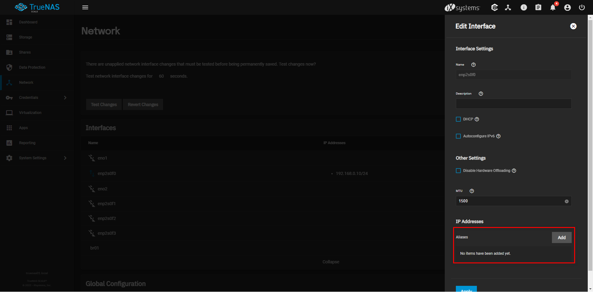

1. Remove IP Addresses > Aliases
2. Add BR01 interface (make sure DHCP is enabled), Add Bridge members (enp2s0f0)
3. Test changes
4. Attach NIC to BR01

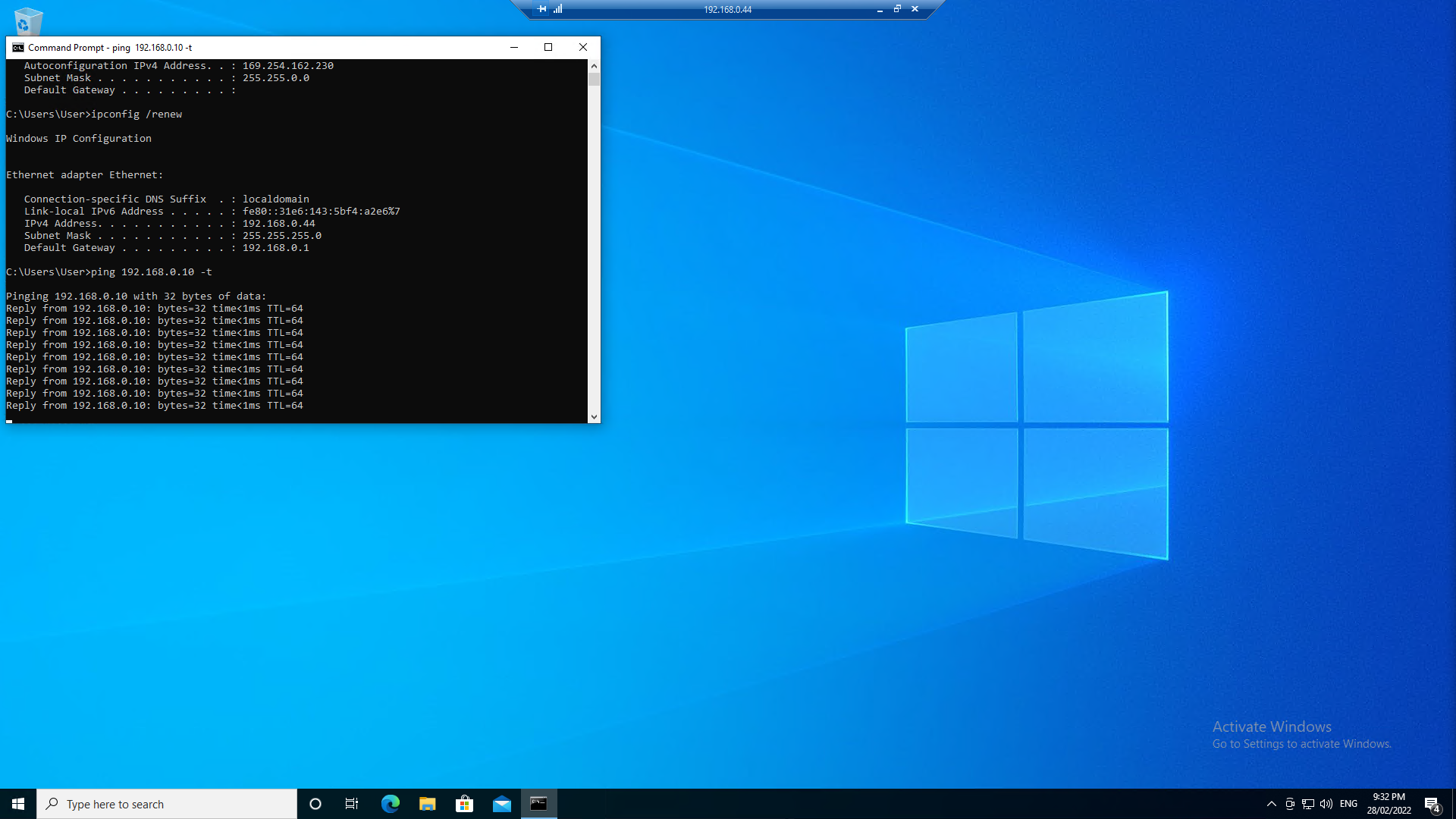

5. Find IP of VM (through display and the usual IPCONFIG in the VM) then use RDP for better visuals. Ping BR01 (for my test it was 192.168.0.10)

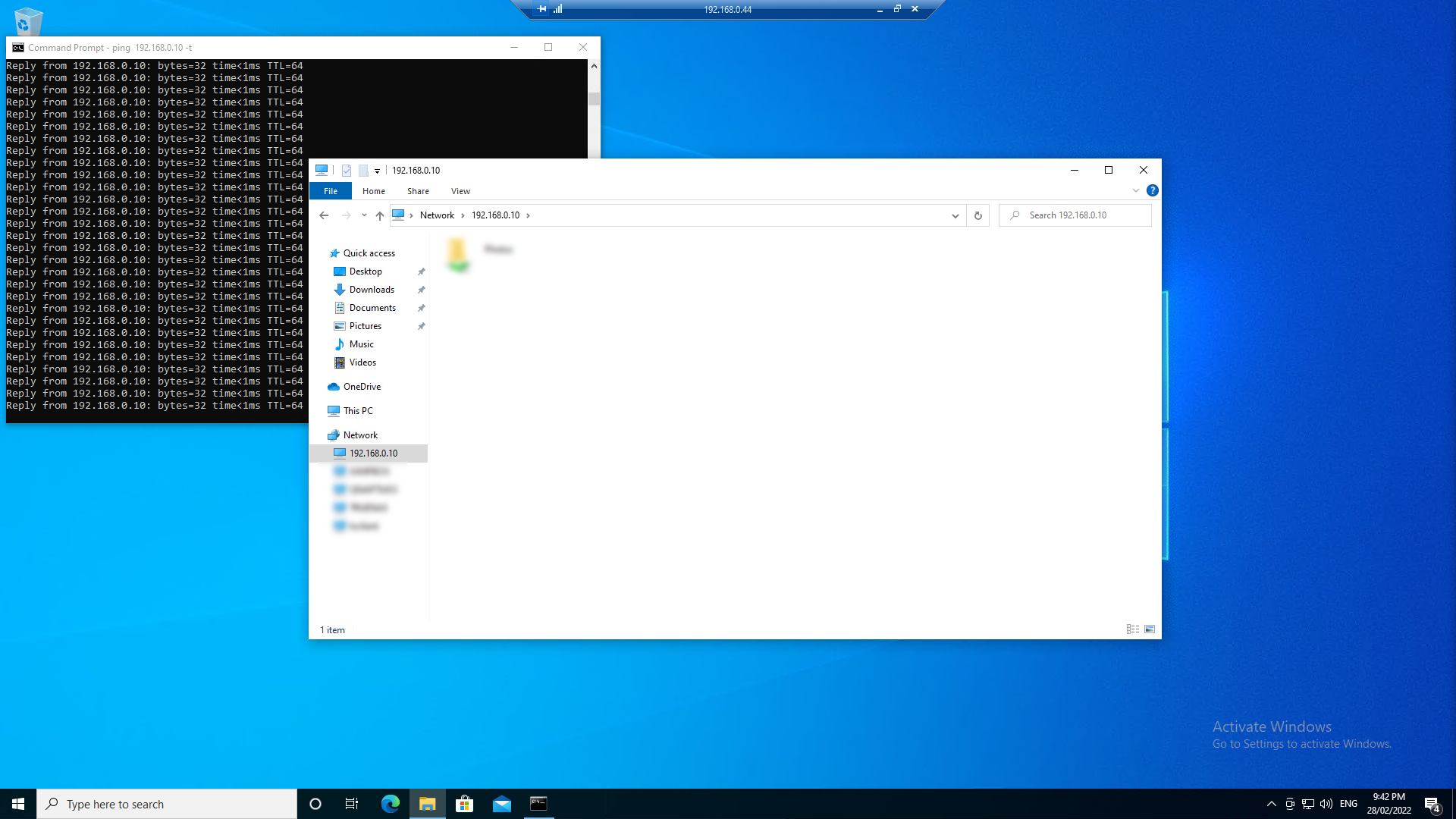

6. Connect to SMB
7. Connection established

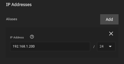

I tried to follow the guide that was linked to in this thread. However I was running into an issue. On the create bridge screen the settings would not take no matter what if I selected the DHCP checkbox.
If I did it ignore the static IP I set in the add IP alias box. It would allow me to add the settings below.
However after I saved and attempted to test the settings it would choose some random IP on the subnet.
When I went back in the "DHCP" box would still be checked but the IP I had added in the bottom section was now missing. It was like I never added an IP.
Now I figured maybe it was an issue and I would just go back in and add the IP settings after all the changes had been saved. HOWEVER the bridge would just not accept that no matter what. Whenever I tried adding the correct IP and hit save the settings would never validate.
The only way I could get it to show the correct IP was if I left DHCP box unchecked.
The good news is everything works without the DHCP box checked but I am sure that will cause unrelated issues down the road.
