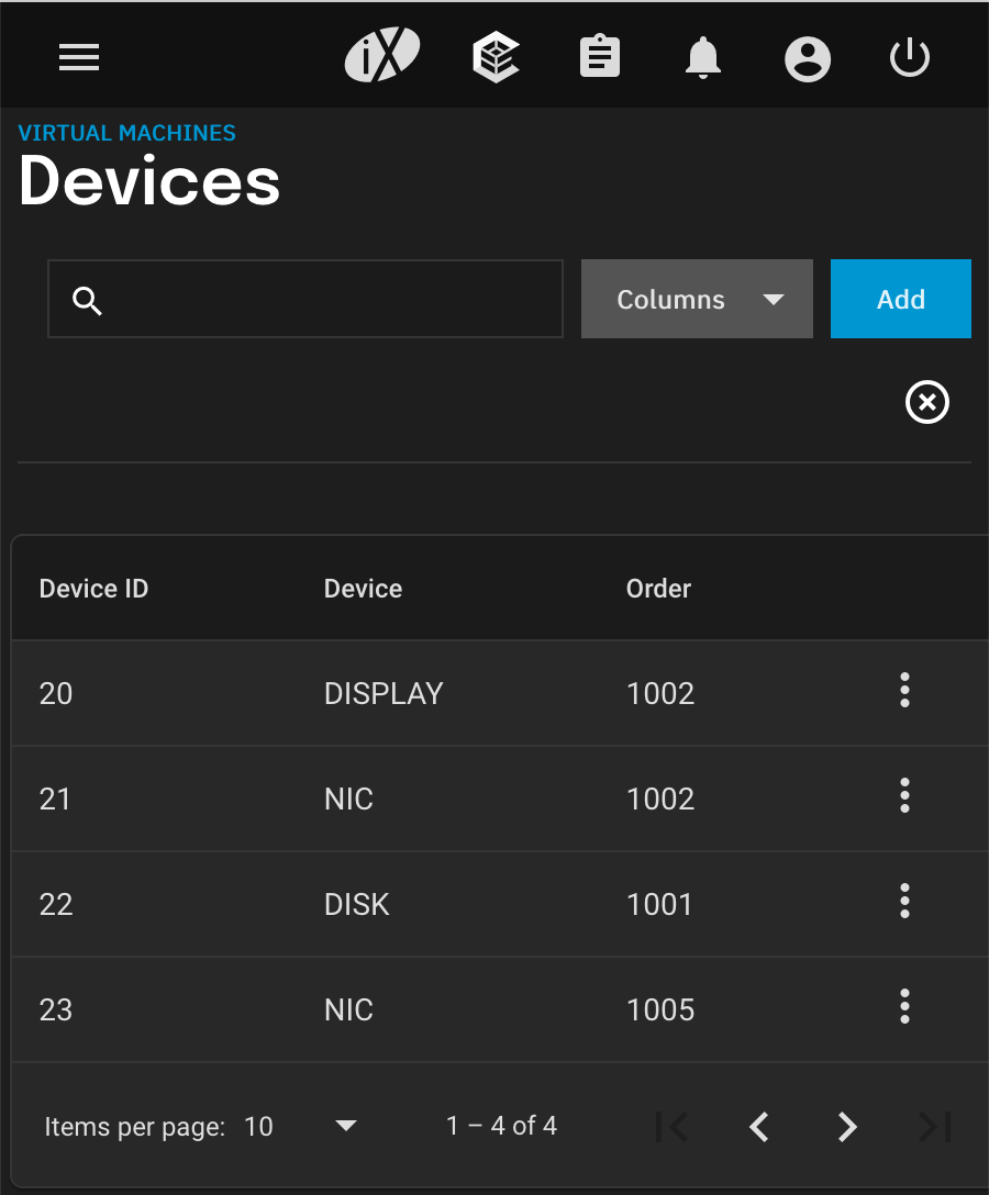

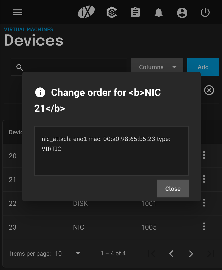

The key to this approach is to add a second NIC to the VM, which is only for communication with the TrueNAS host system. The first NIC of the VM will be directly attached to your physical network interface. This will create a macvtap interface when the VM is running. It will have access to your LAN, but not to the TrueNAS host. To the second NIC you should attach a bridge interface.

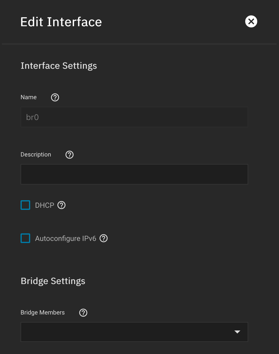

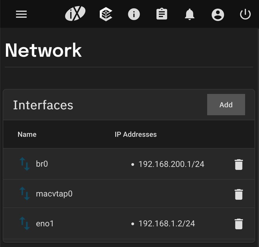

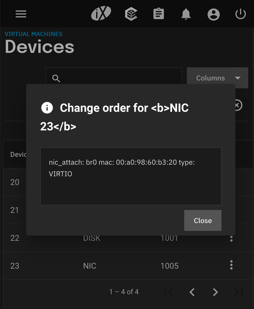

Create this bridge interface first, in the TrueNAS Network settings. Don't attach any interface as Bridge Members when setting up this bridge. Do assign an ip address which is different from the subnet of your physical interface. So if for example your eno1 physical interface has ip address 192.168.1.2, then assign 192.168.200.1/24 to the br0 interface when creating it. As mentioned, assign this bridge to the second NIC of your VM.
You can assign the br0 bridge interface to all your VMs which need to access the TrueNAS host. Make sure to manually assign ip addresses to these VMs (from within the VM) to an ip address within the subnet you assigned to the bridge interface (so for example 192.168.200.2). They won't automatically get one via DHCP.
Your VMs can now reach TrueNAS at 192.168.200.1 (so not via 192.168.1.2, the ip address all other LAN clients would reach it at). This makes it trivial to restrict services, such as NFS shares, to VM guest only since they reside in a different subnet as the LAN clients.
