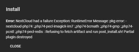

I am trying to install nextcloud on my truenas but every time I try to install it it gives me an error. I can install all the other plugins on it just not nextcloud. I tried to fortmat the drives and reinstall truenas. I tried to install it on a pool made out of two 500gb ssd's that are mirrored.
Can someone explain to me what I am doing wrong?

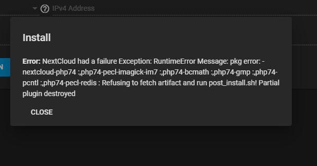

Hello everyone,
Brand new TrueNAS user here, version 12.0-U7. No trouble with any other plugins, but getting the same error as everyone else.
Error: NextCloud had a failure Exception: RuntimeError Message: pkg error: - nextcloud-php74 :,php74-pecl-imagick-im7 :,php74-bcmath :,php74-gmp :,php74-pcntl :,php74-pecl-redis : Refusing to fetch artifact and run post_install.sh! Partial plugin destroyed
I hate it when they refuse to fetch artifacts! Where is Indiana Jones when you need him?? I'm assuming the powers-that-be are working to fix whatever is broken. Anyone heard officially if a fix is forthcoming? Any idea if the break is on TrueNAS's end or NextCloud's?

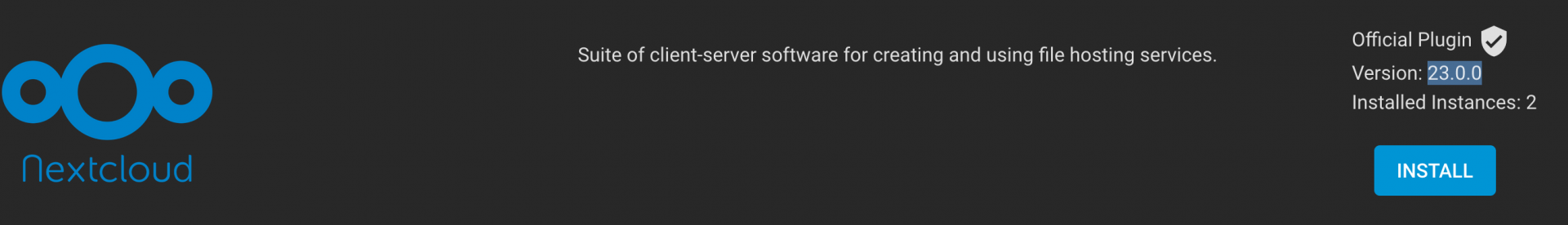

Reporting the same issue here with regards to the failing to fetch artifact issue.
Another observation is that when the plugin index is refreshed (for iXsystems plugins) on the https://your.truenas.server.here/ui/plugins page, the Nextcloud plugin shows “Version: N/A” when it used to say “23.0.0”.

Thanks for mentioning this @WolfpactVI. You were on the right track for sure.
Root cause
The FreeBSD package maintainers removed the *php74* dependencies...(I did not go further to figure out why...).
The iXsystems nextcloud plugin reference to the FreeBSD manifest is here: https://github.com/freenas/iocage-ix-plugins/blob/master/nextcloud.json#L25
Manifest contents are located here: https://pkg.freebsd.org/FreeBSD:12:amd64/latest/packagesite.txz
If you extract the packagesite.txz file, and search for the missing packages that came out in the dialog box (see screenshots earlier in this thread) then you'll notice they do not exist. But if you search for 'php73' or 'php80', they still do.

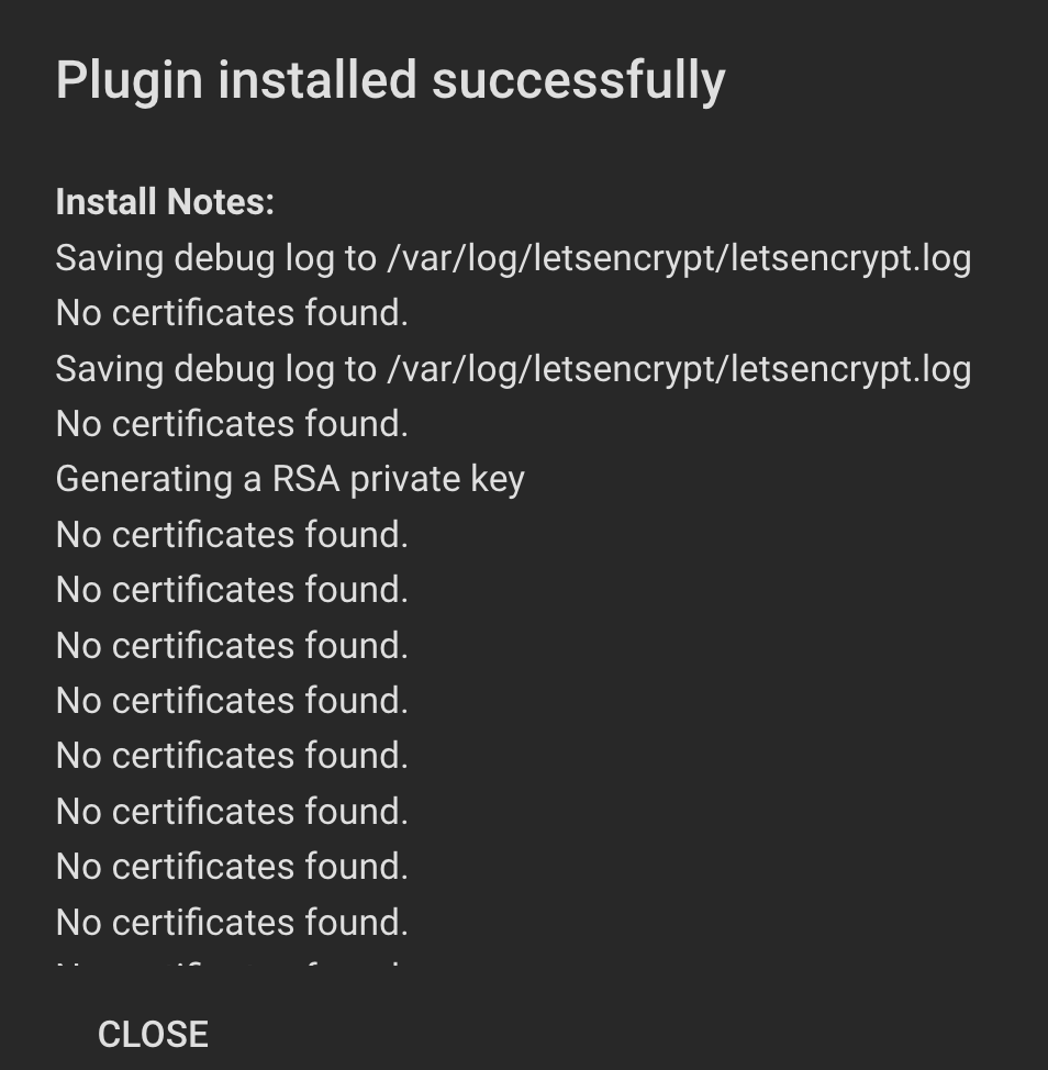

Just tried it this morning, it worked! No updates to the TrueNAS OS were available, so I just went to the plugin section and the NextCloud plugin showed up as version 23.0.0 so I thought I'd give it a whirl. Seems to have installed fine with no errors, though since I'm doing it remotely and don't have port forwarding set up for it yet, I can't actually access the web UI until I get home this evening.
Thanks to whoever worked on this, and Happy New Year!
