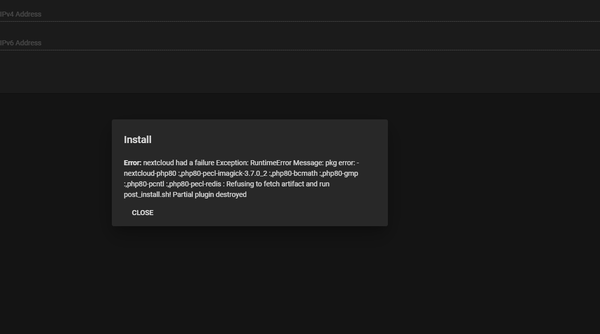

I am having problems installing Nextcloud on a test system I'm running. Every time I attempt an installation, I get this error message:
I've looked elsewhere and other people seem to say it's a problem with php80 support, but I'm not sure how to fix that (if it is the problem). Any help would be appreciated, thanks.

The plugin is outdated and deprecated, don't use it. Use @danb35's script instead.
Reason: PHP 8.0 is EOL and iX seemingly can't be bothered to maintain an official plugin.
