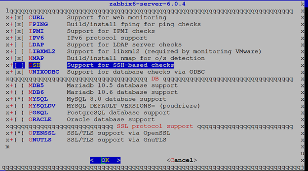

5. Install zabbix server from ports as this is the only way of getting compatibility with IPMI
portsnap fetch extract portsnap fetch update cd /usr/ports/net-mgmt/zabbix6-server/ make config make install clean
A new window will appear, enable all the options you want (noticed how i selected IPMI

  • The system will ask if we want to reload priviledge table now". Type "Y".
14. Enter the Mysql terminal
mysql -uroot -pzabbix-mysql-root
15. enter the following commands
create database zabbix character set utf8mb4 collate utf8mb4_bin; SHOW DATABASES; create USER 'zabbix'@'localhost' IDENTIFIED WITH mysql_native_password BY 'zabbixDBpass'; grant all privileges on zabbix.* to 'zabbix'@'localhost'; FLUSH PRIVILEGES; quit;
16. Install the zabbiz database
cd /usr/local/share/zabbix6/server/database mysql -uzabbix -pzabbixDBpass zabbix < mysql/schema.sql mysql -uzabbix -pzabbixDBpass zabbix < mysql/images.sql mysql -uzabbix -pzabbixDBpass zabbix < mysql/data.sql
Setup Zabbix Server
17. open the file /usr/local/etc/zabbix6/zabbix_server.conf, Uncomment and change the following parameters:
LogFile=/var/log/zabbix/zabbix_server.log DBHost=localhost DBName=zabbix DBUser=zabbix DBPassword=zabbixDBpass StartIPMIPollers=3
18. create a log folder
mkdir /var/log/zabbix/ chown zabbix:zabbix /var/log/zabbix/
19. enable and start the zabbix server service
sysrc zabbix_server_enable=yes service zabbix_server start
Setup PHP

Troubleshooting
Problem #1: At least for me, when i was doing the initial setup, zabbix indicated that it couldn't create a configuration file and had a ling to download one.
Solution #1: Download the file to your local computer, open it in notepad and copy its content.
SSH into the jail, create a new config file touch /usr/local/www/zabbix6/conf/zabbix.conf.php and paste the contents of the zabbix config file that we downloaded earlier.
Go back tot he web interface and try again. This should solve the problem
Problem #2: Some times duting the initial setup zabbix will indicate that it cannot connect to the database.
Solution #2: SSH into the zabbix jail
enter the mysql terminal
mysql -uroot -p
then issue the following commands
ALTER USER 'zabbix'@'localhost' IDENTIFIED WITH mysql_native_password BY 'zabbixDBpass'; FLUSH PRIVILEGES; quit;
and restart the mysql service
service mysql-server restart
