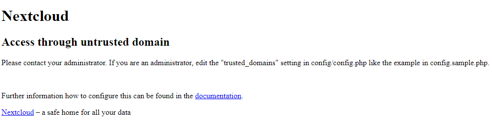

My issue is the last part of that guide: I have a running NC jail but when I add the proxy headers such as the following
                       location /nextcloud {
140                 proxy_pass http://Jail's IP:80/nextcloud/;
141                 proxy_redirect off;
142                 proxy_set_header Host $host;
143                 proxy_set_header X-Real-IP $remote_addr;
144                 proxy_set_header X-Forwarded-For $proxy_add_x_forwarded_for;
145                 proxy_buffering off;
146                 proxy_http_version 1.1;
147                 proxy_set_header Upgrade $http_upgrade;
148                 proxy_set_header Connection "Upgrade";
149                 proxy_hide_header X-Powered-By;
150
151                 }
I get this:
In the config.php for NC I of course added my trusted domain, restarted all services but nothing. Something to note is that when I enter mydomain.com/nextcloud/ after a couple seconds it becomes mydomain.com/nextcloud//. Why isn't this working?

I don't know but I never used Nextcloud with a subfolder as the base URL. I am not sure it is supported. Why don't you use something like https://nextcloud.mydomain.com ?

I tried, maybe the configuration of the domain is different? Currently I have the domain as mydomain.nextcloud.com. I created a new jail by using apache instead of nginx. Everything went well, installation and configuring NC via the GUI. What I can't do, is use a different domain (I created a new domain only for NC) since when I type mydomain.nextcloud.com I get re-routed to my Emby server!
I should mention that I use No-Ip where I created a domain for Emby. I went back and created a new one for NC but don't know why is routing the traffic.
To be honest, I'm not sure. I think I've seen people set it up in a directory from the domain (e.g. domain.com/service) but I think it makes the nginx configuration a little more complicated, and possibly some extra settings in the nextcloud config.php? I've always used service.domain.com, so in your case nextcloud.domain.com and emby.domain.com, and separate certificates for each service. It works well for me, and I have several other services on different domains working through the same reverse proxy.
So just set up NC with its own nginx and set up nginx.conf (from inside NC) to use nextcloud.mydomain.com? I think this is a bit too complicated for me, so I rather set up a new jail with its own certificates as well as a new domain for nextcloud only. Can I ask you if you use a reverse proxy that handles all the certificates or do you have each jail do that on their own?

Part of your problem might be the way No-Ip is redirecting things to your external IP address? I'm actually running a reverse proxy on a Raspberry Pi now, but before I was using a Jail. The jail was just running NGINX as a reverse proxy and Certbot to generate all of the SSL certificates for each service, about 12 in total. I had a unique configuration file for each service (e.g. emby.conf) with paths to the relevant certificates and redirection to the appropriate service (some in Jails, some in VMs) on FreeNAS. I have my own domains though, so was redirecting those to my IP address through DNS records, so emby.mydomain.com was directed to my IP address.
You need to make sure each of the services is working internally before you start to worry about the reverse proxy though! You should be able to access them all from the internal IP address as this is what you are going to redirect to from your reverse proxy jail.

I have a total of 8 jails (one of them is nginx that works as a reversed proxy - handles certificates as well). I can access all of them in the format of mydomain.com/radarr/ or mydomain.com/transmission/ for example without any issues over the internet or locally by using the jail's IP.
I'm trying to do the same with NC but I just can't get nginx to communicate with NC properly and I don't know why. But I won't surrender!

I really appreciate your help guys.
adrianwi
Oct 15, 2013
1,231
I'm not even going to pretend to fully understand NGINX configuration, but I'm assuming this is your configuration for the reverse-proxy jail?
I can't see any block in there that would know where to direct your nextcloud traffic to the appropriate jail? And I'm struggling to see how you are getting to it from mydomain.nextcloud.com which is surely a subdomain for nextcloud.com?
