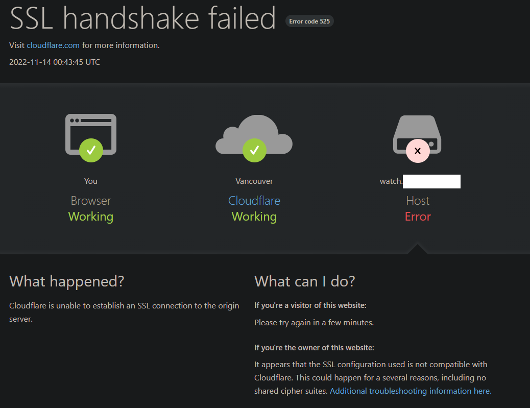

It's been about a week and I've had a chance to give this another shot.
I made some progress after some initial failed experimentation where I've got the "end user experience" to the same as before:
`my.b.c` resolves to nextcloud correctly.
`watch.b.c` fails with the following error:

If you want to be able to access watch. (or anything else) from outside your LAN, you'll need to forward ports 80 and 443 to your Caddy jail--and if you do that, there really isn't any reason to be using Cloudflare for your DNS, as you'd be able to get certs without DNS validation.

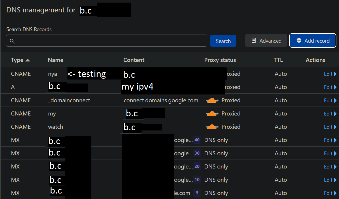

All my subdomains are set up as A records with cloudflare with the content column being my public IP address. I have a static public IP so I don't know how you would set that up with a dynamic one.
The only CNAME MX and TXT records I have are for mailgun for the email service I use for a forum.

I couldn't get it working properly with just Google domains. I think I'm probably missing a key piece of info.
I switched back to Cloudflare as previously described. I got my jellyfin (watch.b.c) working and also my nya.b.c working on an external network (phone on data, so not using my router).
However, on an external network, nextcloud doesn't work. I get a 502 bad gateway from cloudflare indicating my.b.c has a host error.

Same error as before in `caddy run debug`: "x509: cannot validate certificate for 192.168.1.70 because it doesn't contain any IP SANs" when accessing the site from an external network.
So I'm still seeing the 502s but I'm unsure what the issue is. Jellyfin is accessible from external networks, and nextcloud is accessible from internal networks. My router is provided by the ISP so I don't think I'm able to perform your other suggested preferred action.
Thankful for any guidance. Thanks :)
