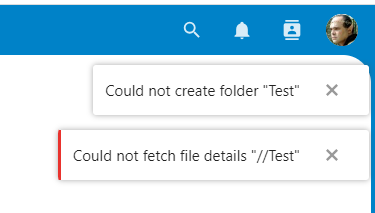

I have Nextdcloud installed using @danb35 's script, which has been wonderful and reliable so far. Sunday evening, I updated Nextcloud from 27.0.2 to 27.1.0 using the CLI command to run the update. After this was done, I can still access the UI via the web, but all my files appear to be missing, and I am unable to create any new ones using the UI. Adding files to my local folder that is synced with Nextcloud results in an error from the server as well (500, I believe).

Error core RedisException: Permission denied
