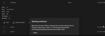

Today after some maintenance work (install faster NIC) I wanted to play with Nextcloud some more but I notice it's not running, and the Jail won't start?
The error displayed:

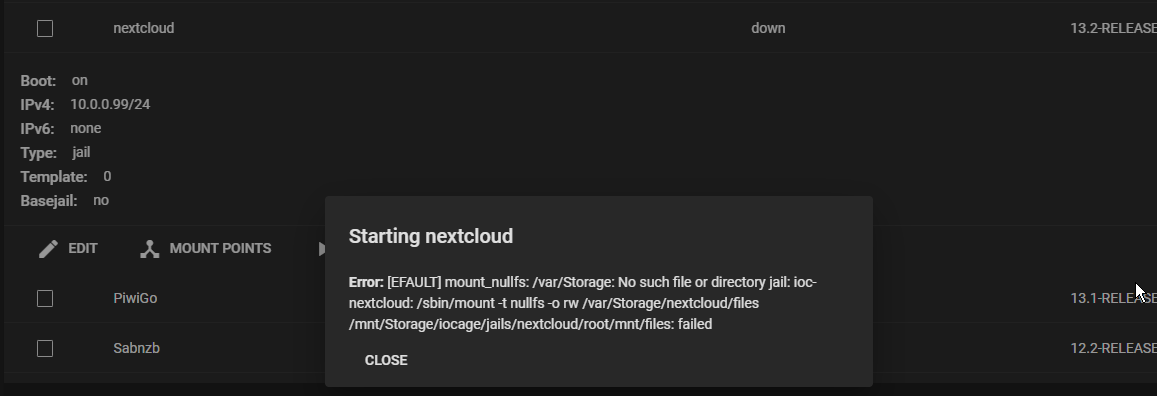

Starting nextcloud​
Error: [EFAULT] mount_nullfs: /var/Storage: No such file or directory jail: ioc-nextcloud: /sbin/mount -t nullfs -o rw /var/Storage/nextcloud/files /mnt/Storage/iocage/jails/nextcloud/root/mnt/files: failed
Manually starting the jail from console:
root@freenas:/mnt/Storage/iocage/jails/nextcloud/root/mnt/files # iocage start nextcloud
No default gateway found for ipv6.
* Starting nextcloud
+ Start FAILED
/var/Storage: No such file or directory -> it is correct that var/Storage doesn't exist. only mn/Storage does.

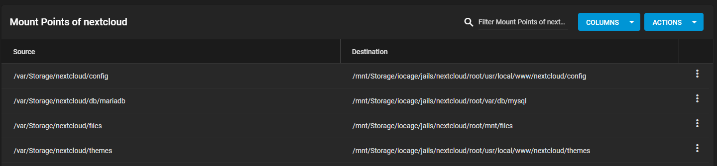

so i'm guessing something is wrong in these fstab lines?
root@freenas:/mnt/Storage/iocage/jails/nextcloud # vim fstab
/var/Storage/nextcloud/files /mnt/Storage/iocage/jails/nextcloud/root/mnt/files nullfs rw 0 0
/var/Storage/nextcloud/config /mnt/Storage/iocage/jails/nextcloud/root/usr/local/www/nextcloud/config nullfs rw 0 0
/var/Storage/nextcloud/themes /mnt/Storage/iocage/jails/nextcloud/root/usr/local/www/nextcloud/themes nullfs rw 0 0
/var/Storage/nextcloud/db/mariadb /mnt/Storage/iocage/jails/nextcloud/root/var/db/mysql nullfs rw 0 0
Mount points are configured though:
starting jail with different command:
service jail onestart nextcloud
Starting jails:/etc/rc.d/jail: WARNING: Invalid configuration for nextcloud (no jail.conf, no hostname, or no path). Jail nextcloud was ignored.

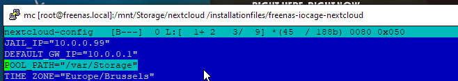

I'd really prefer that questions about usage of, or problems with, my script be kept on the discussion thread for that resource. But with that said, yes, I think you've identified the problem, which likely results from your having set POOL_PATH to /var/Storage rather than /mnt/Storage in your nextcloud-config file. You can fix the fstab file easily enough, but I'd be concerned that the data that's supposed to be stored outside of the jail is instead being stored inside it.
sqwob
Jan 8, 2013
71
Seems you're right, i'll start over.
Appreciate the extremely fast response!
