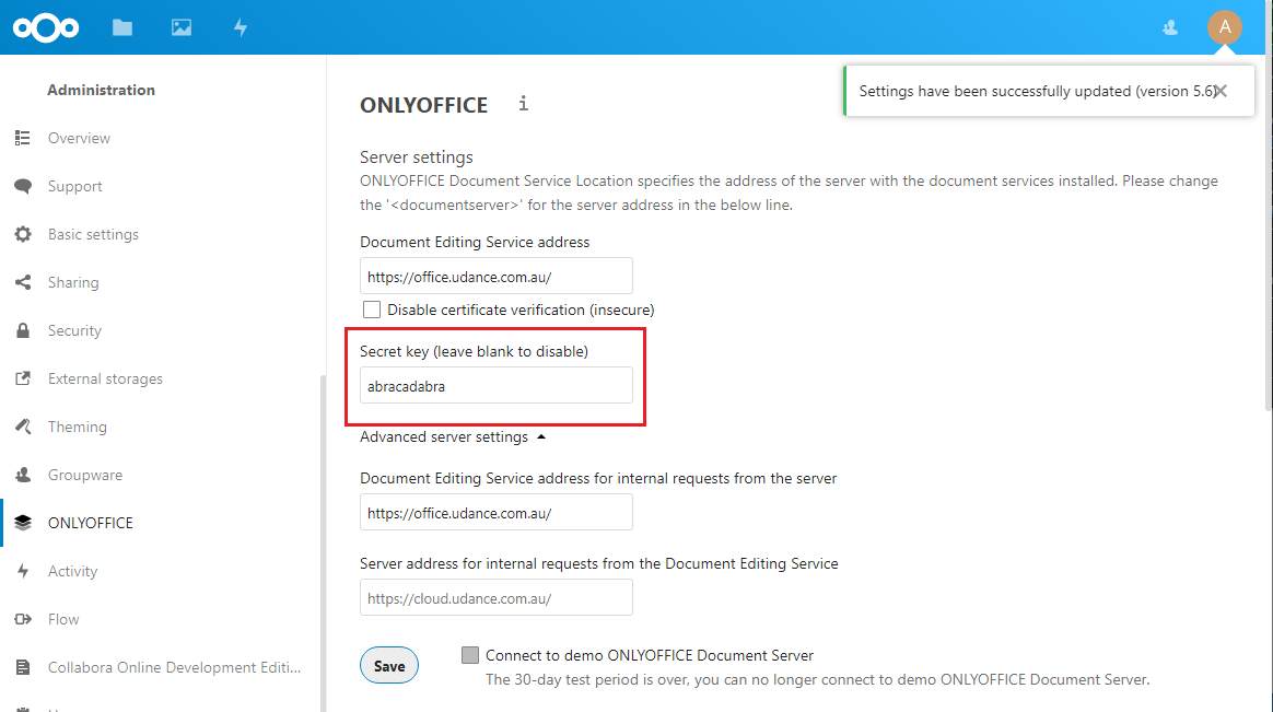

This resource gets Nextcloud and OnlyOffice (noSSL for both; the local network is considered trusted) working behind a reverse proxy, but any further hardening is considered out-of-scope and is on the onus of the individual to figure out. However, I was curious in this case as I have a password set up for the Nextcloud-Collabora Integration resource, but not the Nextcloud-OnlyOffice resource. To restrict access to the OnlyOffice Document Server, this is what I had to alter.
Step 4: OnlyOffice Docker Compose file
version: '3.3'
services:
  documentserver:
    ports:
      - '80:80'
    environment:
      - JWT_ENABLED=true
      - JWT_SECRET=abracadabra
    restart: always
    container_name: onlyoffice-document-server
    image: onlyoffice/documentserver
Step 6: Configure the OnlyOffice connector

Thanks, I've tried these variables, removed local.json mapping in Onlyoffice container and also there is no need to add entry in config.php. And it works...
Does it mean that latest Onlyoffice connector requires "AuthorizationJwt" header and therefore it must be enabled in Onlyoffice server along with password? If so, that's a change which gave me a headache :wink:
Jan 4, 2014
1,644
It appears so. My understanding of the secret key is that it's a way of restricting access to the document server, so the document server has to be configured with the key.

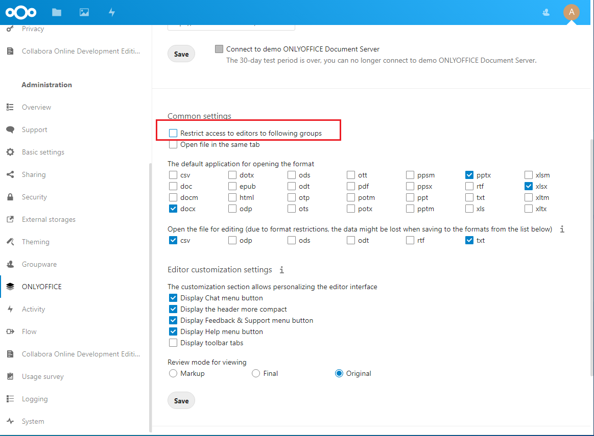

What could be a reason that one time documents are open in editor with "Office style" ribbon and sometimes not (there's displayed only thin bar)? There are no errors in onlyoffice container and I did try various settings in Onlyoffice app in Nextcloud...
EDIT:
It looks like that using Nextcloud admin's account lets me to enjoy full functionality of Onlyoffice and regular user doesn't see ribbon...

It’s not only about editor’s view, regular user has no access to editing tools. Narrow top toolbar has only thesaurus and translations icons...
Anyway thanks, I’ll try to find help on other forums/threads.
Just to eliminate one possibility, you haven't on the off-chance restricted access to OnlyOffice have you? Check your OnlyOffice connector configuration.
listhor
Mar 2, 2020
133
No, no; it was the very first thing I’d checked.
Since admin has access to all tools, connection is not an issue, only permissions. Either on nextcloud or onlyoffice side. I will toggle restrictions and see maybe something will get unblocked

Ok, back in action - I had to tick off and on Editor customization settings...
I hope it's the last issue with Nextcloud. :wink:
