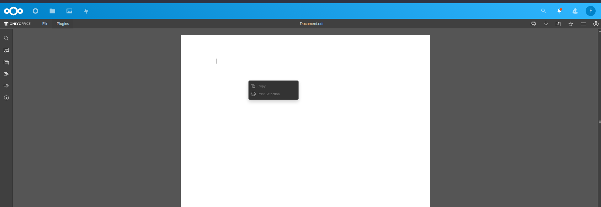

2) This is everything i can see when i try to open an .odt file
I cannot type anything in there. I cannot paste anything there. The menu bar only shoes thesaurus, speech and translate. Thats it.

Alright - After going through every single output of every console i got during the installation. I saw that 2 points didnt work during the installation and i repeated them and now it works.
So: I could deactive the portforwarding to the office domain and the connection works. I can flawlessly work on .docx files on the android app but i cannot create .odt files. Well this is sad but i can work with that tbh.
It appears that my firefox browser is kicking me here because now i cant edit any type of document in it. But in the app it works and thats all i need.

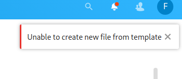

Still i sometimes get errors regarding that template. Well i guess i can live with that.
If you log in to NC using a desktop browser, you should be able to create ODF files. I can't vouch for the mobile/desktop apps though as they may have limitations.
You may want to consider setting up Collabora as well. Refer to the resource Nextcloud and Collabora Integration. Collabora operates on ODF files by default.
Using a combination of the NC, OO and Collabora mobile apps, I seem to have all bases covered e.g. I'm able to create and edit both OOXML and ODF files.
Can't say I've come across this issue. Something flaky in your environment I think.
