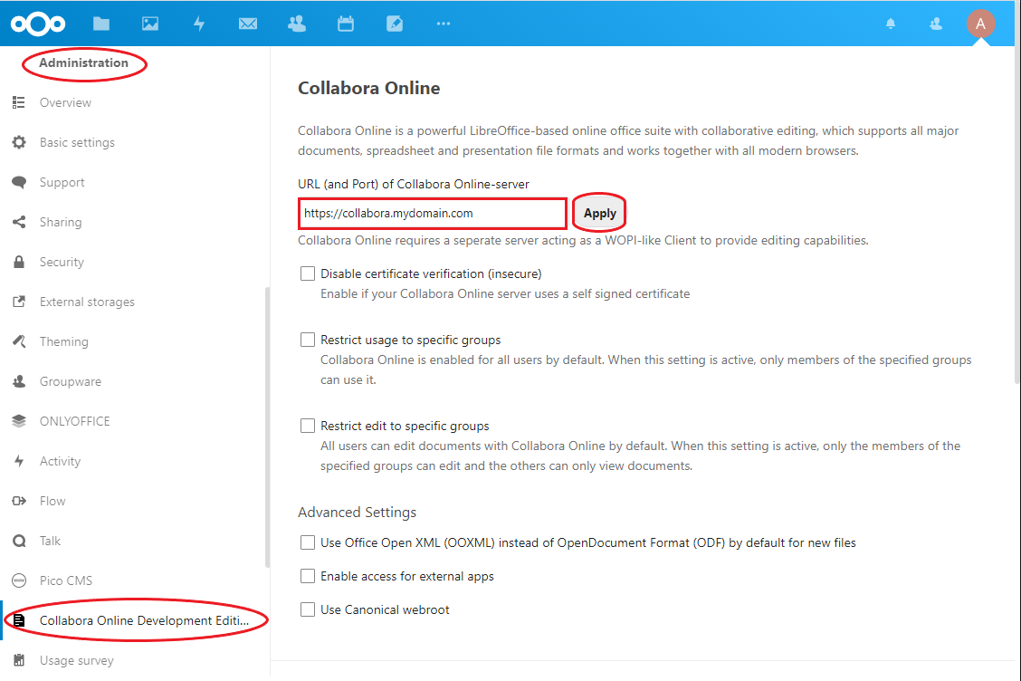

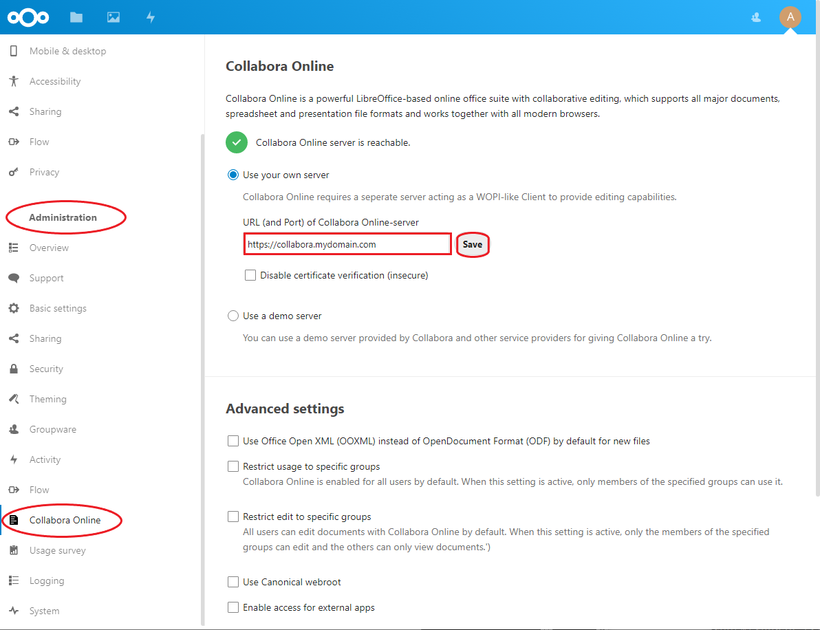

Step 6: Enable and configure the Collabora Online connector in Nextcloud

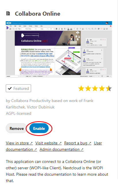

Notes:- Enable the Collabora Online connector under Office & Text applications and configure it as shown below. Do not enable the Collabora Online - Built-in CODE Server.
That's it. Logging in as a Nextcloud user now gives you access to the Collabora CODE suite including a word processor, spreadsheet and presentation applications. There are also free Collabora mobile (Android and iOS) apps that work with Nextcloud

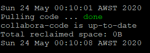

If there isn't an update when the job is run, a typical log entry will look something like the following:

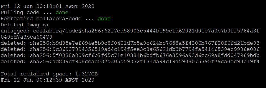

If an update is available, the log entry will instead look more like this:
