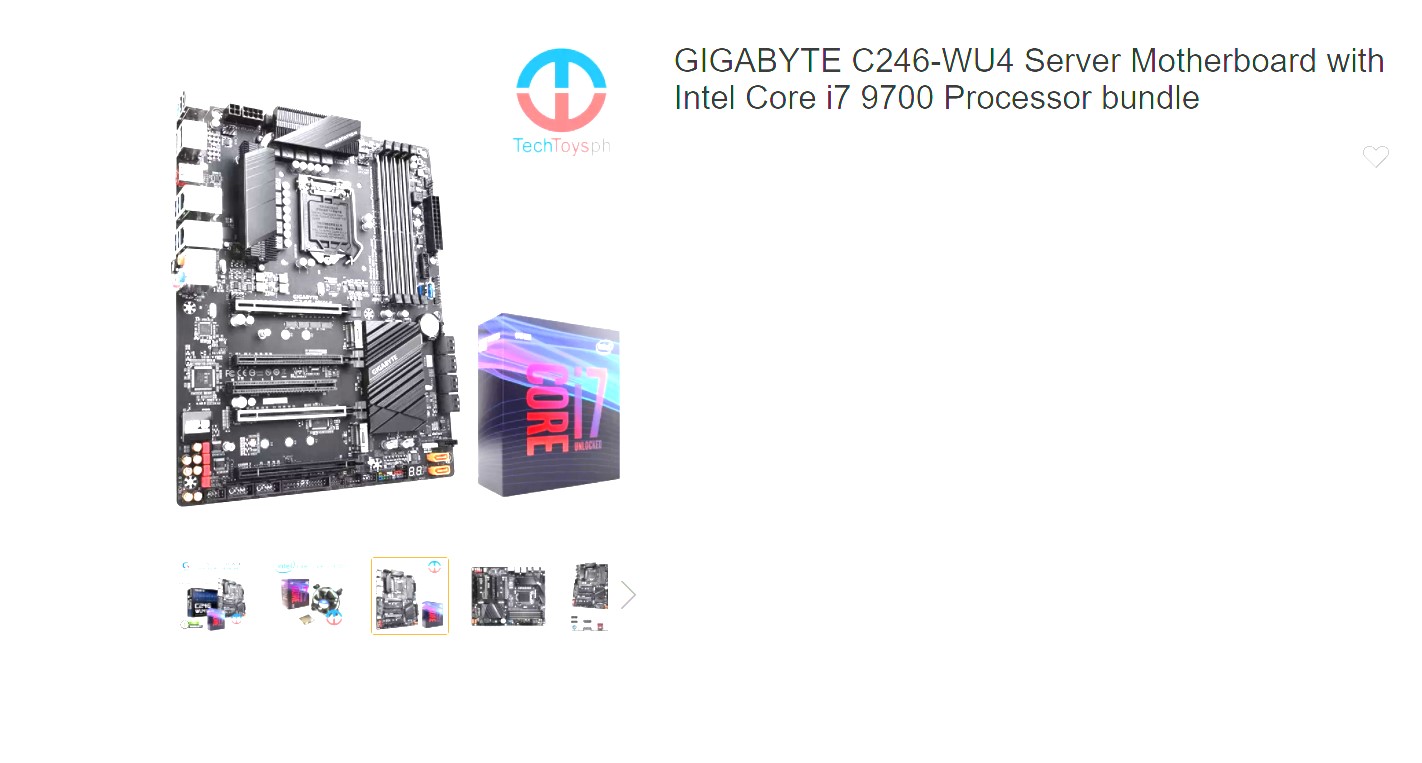

by looking around in the internet and in different forums I also took a look at the Gigabyte C246M-WU4 (rev. 1.x)
this board also looks interesting for me, with a Xeon CPU, what you guys think about that board..???

Here in the Philippines where i live, they actually sell these in a bundle with an I7 CPU at 650USD
see attachment.

Yes. If only for one reason - IPMI. Having LightsOut access to a 24*7 machine is worth money IMHO (in particular if you have hidden the machine away because it makes too much noise.
The Gigabyte board seems well specced although it (like lots of others) lies about its PCIe Slots (4*16 in the headline) is actually 1*16(or2*8) and 2*4 and that annoys me. It also doesn't seem to say what Intel Chipsets on the LAN ports. And the PCI slot seems basically useless
Choosing the right M/B seems to be a bit of a minefield and you will have to pick the features you want but my wants would be~:
1. IPMI
2. Intel LAN Chipsets (just be careful which ones)
3. Lots of SATA ports so you don't have to add an HBA (which are normally *8 slots)
4. Either 10Gb on the board or enough PCIe lanes to add 10Gb (again *8 generally) - optional
5. AND in your case the possible requirement to add a graphics card (*8/16)
I suspect that given the number of lanes the CPU has you will have an issue with all 3 addin cards above. The Gigabyte does not have 3*8 PCIe slots available to you.
Its basically a juggling act
