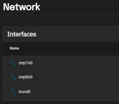

I verified again, and at this point my issue is more that I do not see my device in the GUI. I only have three interfaces:
2 Ethernet 1Gb interfaces
1 bond interfaces created from my 1 physical NIC
Maybe I miss something, but, at least, I shoud see them in GUI. I can only see them from CLI.
It's normal... or not ?
Thanks again

What does midclt call system.feature_enabled FIBRECHANNEL output?
Is this a genuine Intel X520 card, with a verifiable Yottamark sticker on it? I seem to recall some users have been showing up here with knockoff X520 cards that don't actually work right (or at all). If you install TrueNAS Core, does the device appear?
root@grimlock:/etc/network# midclt call system.feature_enabled FIBRECHANNEL
False
